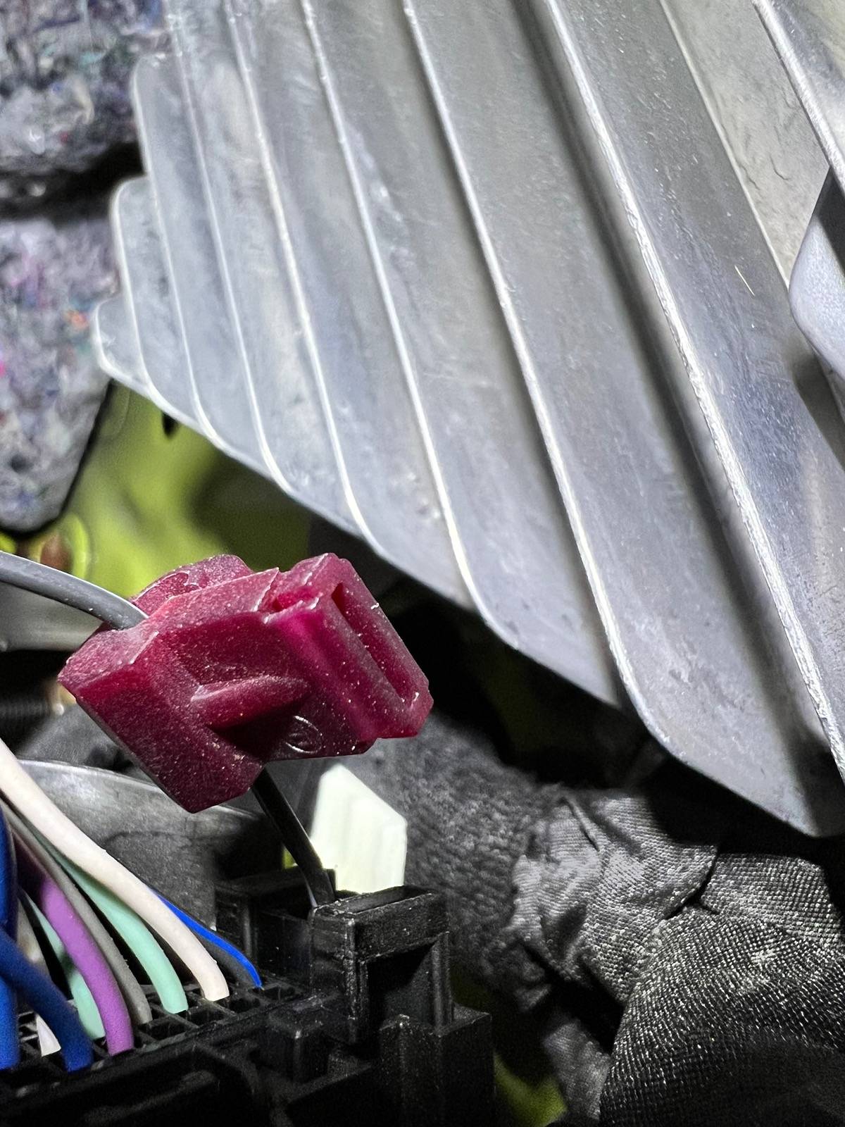

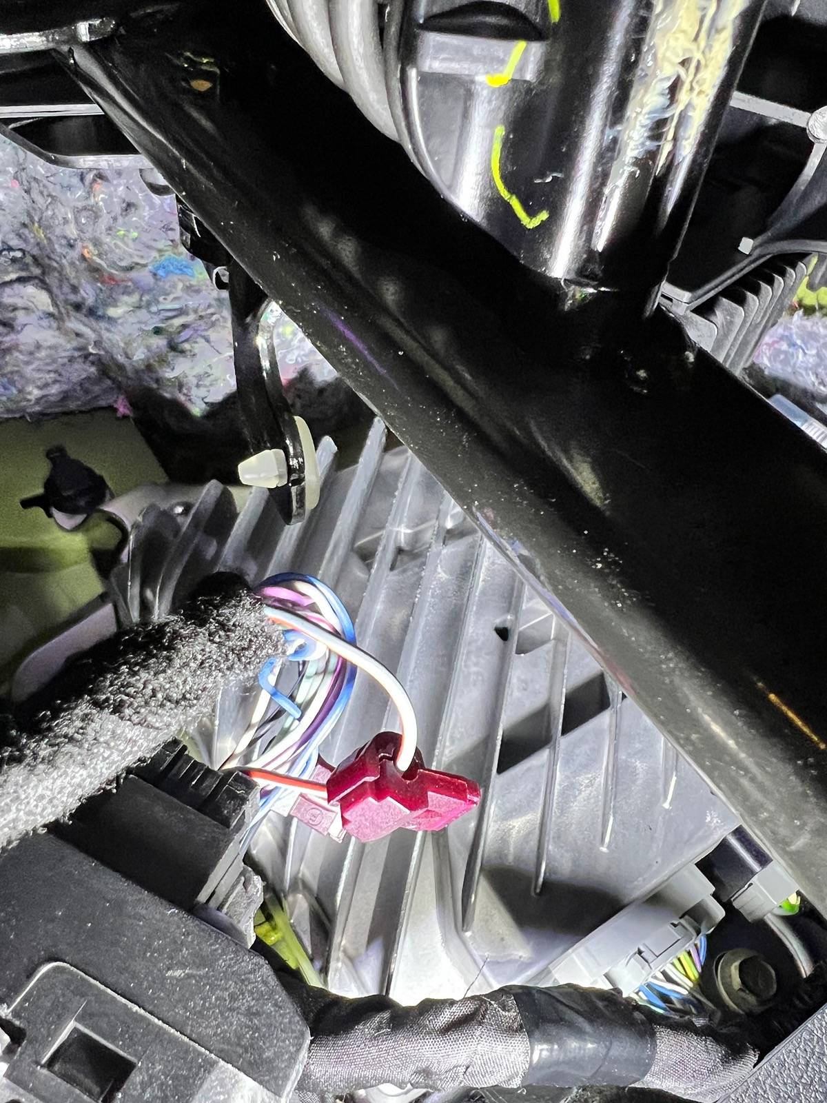

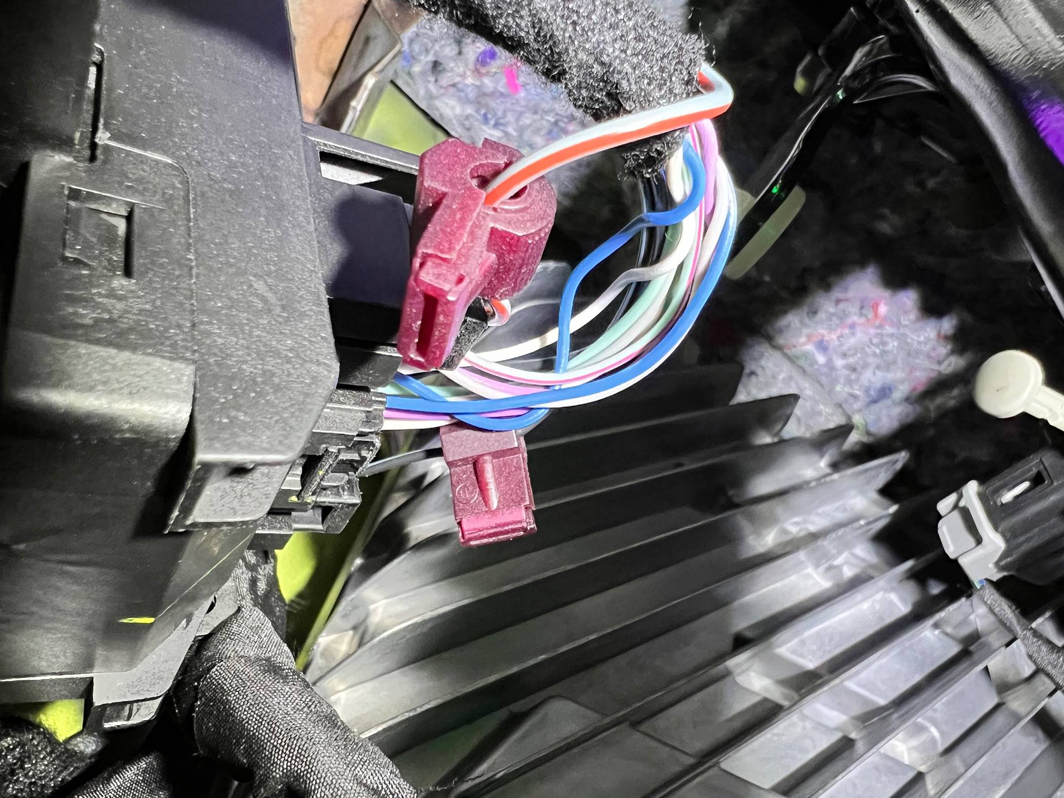

Another trip to dealer and no joy. I’m reaching out to PCMTec for advice.
The technician mentioned aftermarket wiring at OBD2 connector. I was nervous but raced home and investigated. The were two wire taps , but no wires connected. I pulled the kick panel to be sure nothing remained and found nothing.

Their is a good possibility the tune wasn't all that was modified. I seen/heard of people supercharging modifying their car and then when they want to sell it, remove every modified part and put back to stock. Except Dealerships can tell if your pcm was ever altered which could void certain parts/systems from warranty. Good Luck

my first thought looking at the connectors sunder the dash is radar detector but OBD2 is a dumb place to connect. So not sure what else only needs two wires- dealer thought maybe a remote kill switch for a buy here pay here deal. Not sure.
2000 is definitely a positive thing but, why would anyone buy a tune for a 'Totally' stock mustang. The benefits would have to be close to negligible.
