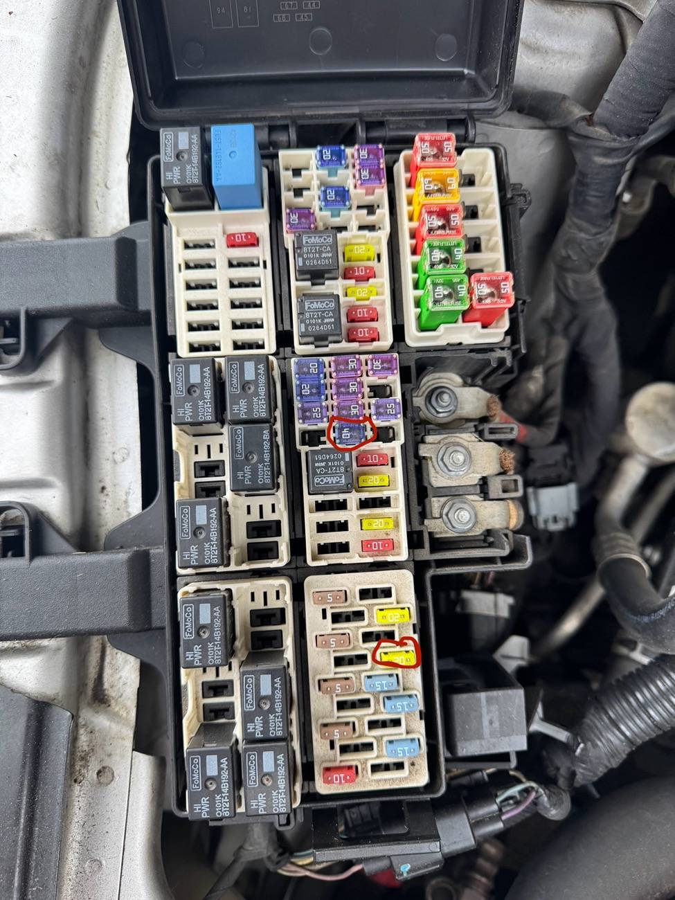

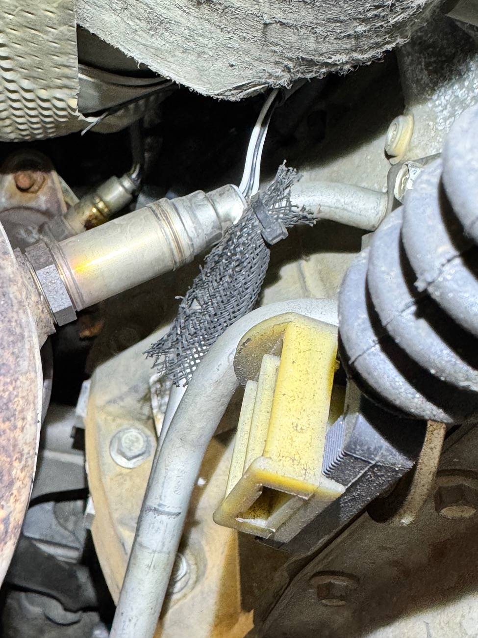

I checked out fuse box 2 fuses are blown, replaced and drove a bit and then blown again, checked wires all good except O2 sensor bank 2 driver seat as seen below shows touching.
Last modification done was changed the rear side markers but I don’t think this is issue.

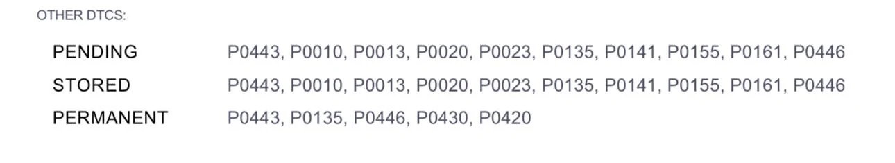

and bent I don’t know if this is causing the issue, attached the new codes.
