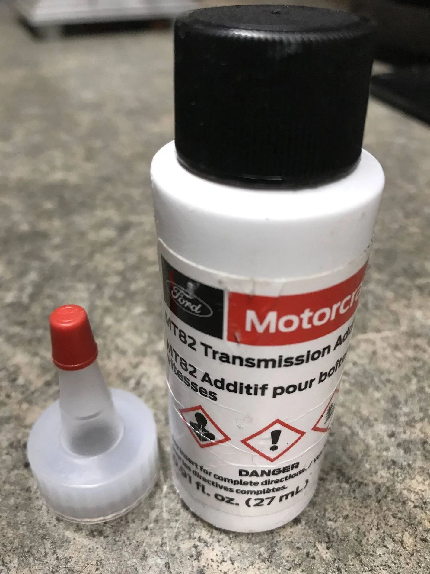

I went to do a fluid change and found that Ford has been adding a MT82 fluid modifier. It is not even mentioned in the owners manual. Not sure if it make any difference but if you use MC fluids you better be use this.

wat. where did you find this information?

Is is listed in the owners manual in the specifications (XL-3 friction additive) and shop manuals calls for it only after replacement of synchros (but it does list it as well).

It said it was for 2011-2018. I read some where that Ford had been using this on all MT82 transmissions from the factory. Just a look at the warning label, good god don`t spill any of this stuff or get it on you. Do not use friction modifier XL-3 in your trans.
