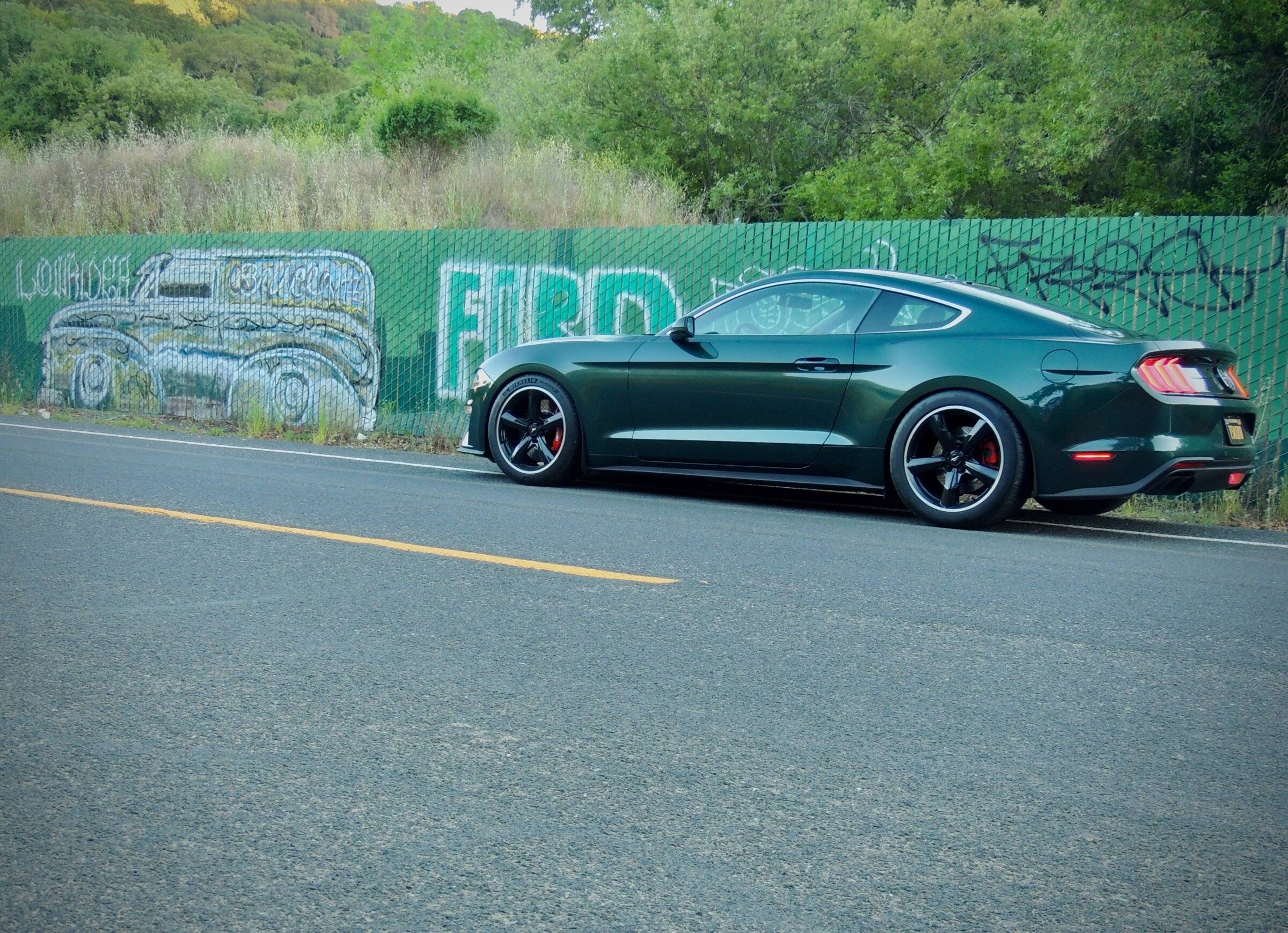

I went with the Eibach Pro-Kit for Magnaride plus the Camber bolts. 1.2” Front and 0.8” Rear
I absolutely love the stance it has with the addition of spacers. It does rub ever so slightly on the occasional dip/bump, but not enough to be an issue.
