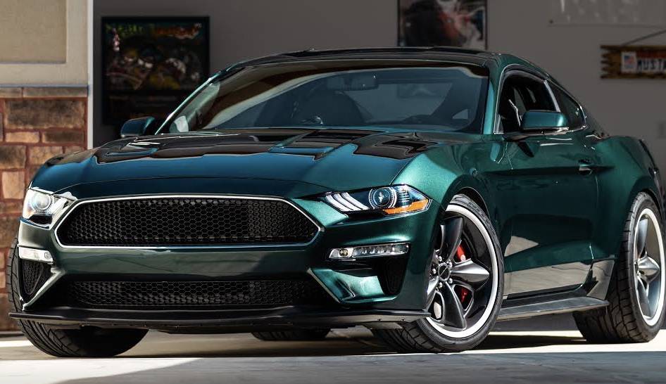

I used the Ford Performance Handling Pack that lowers the car about 3/4" (.787 in.) and is specifically made to work with the MagneRide system with a Vehicle Dynamics Module (VDM) software update. I really like it for both stance and handling. :like:
https://www.cjponyparts.com/ford-pe...eride-mustang-ecoboost-gt-2018-2022/p/M9602M/
This!
FP M-9602-M kit.
No affiliation with any companies or shops.
American Muscle speaking with Ford Engineer on FP Suspension upgrades including Magnaride.
Start at time 6.05 for Magnaride description, and 12.45 for the Magnaride test drive. The they take 4 different 2018 cars with different suspension setups through a Ford proving ground track.
There is a long thread about this kit on this site worth reading.
Mustang6g Thread on M-9602-M
https://www.mustang6g.com/forums/th...d-performance-magneride-handling-pack.116464/
Hopefully you will gain some information that helps out with your decision.

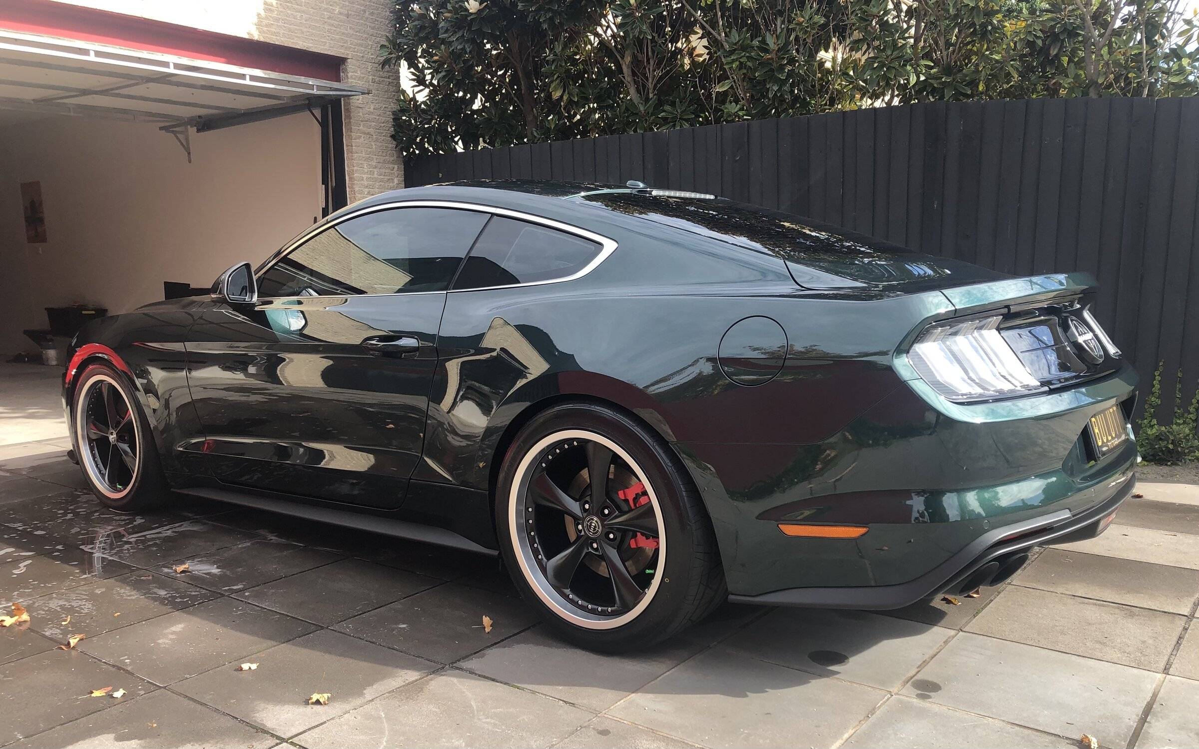

I also installed the Ford Perf magnaride kit.
Sways, springs, calibration. Huge difference in handling, install wasnt bad at all. Car is tastefully lower, without scraping on normal road stuff. Which was my goal.

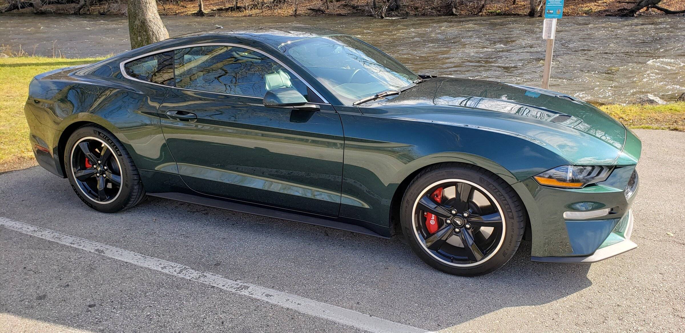

Steeda lowering springs for Magnaride. No issues.
Looks and drives great.
Looks great, just what I'm looking for.

That's rhe perfect look.
I need to mention that its on 265-35 fronts, and 285-35 rears, so less sidewall than a 40 series tire. YMMV, lol
