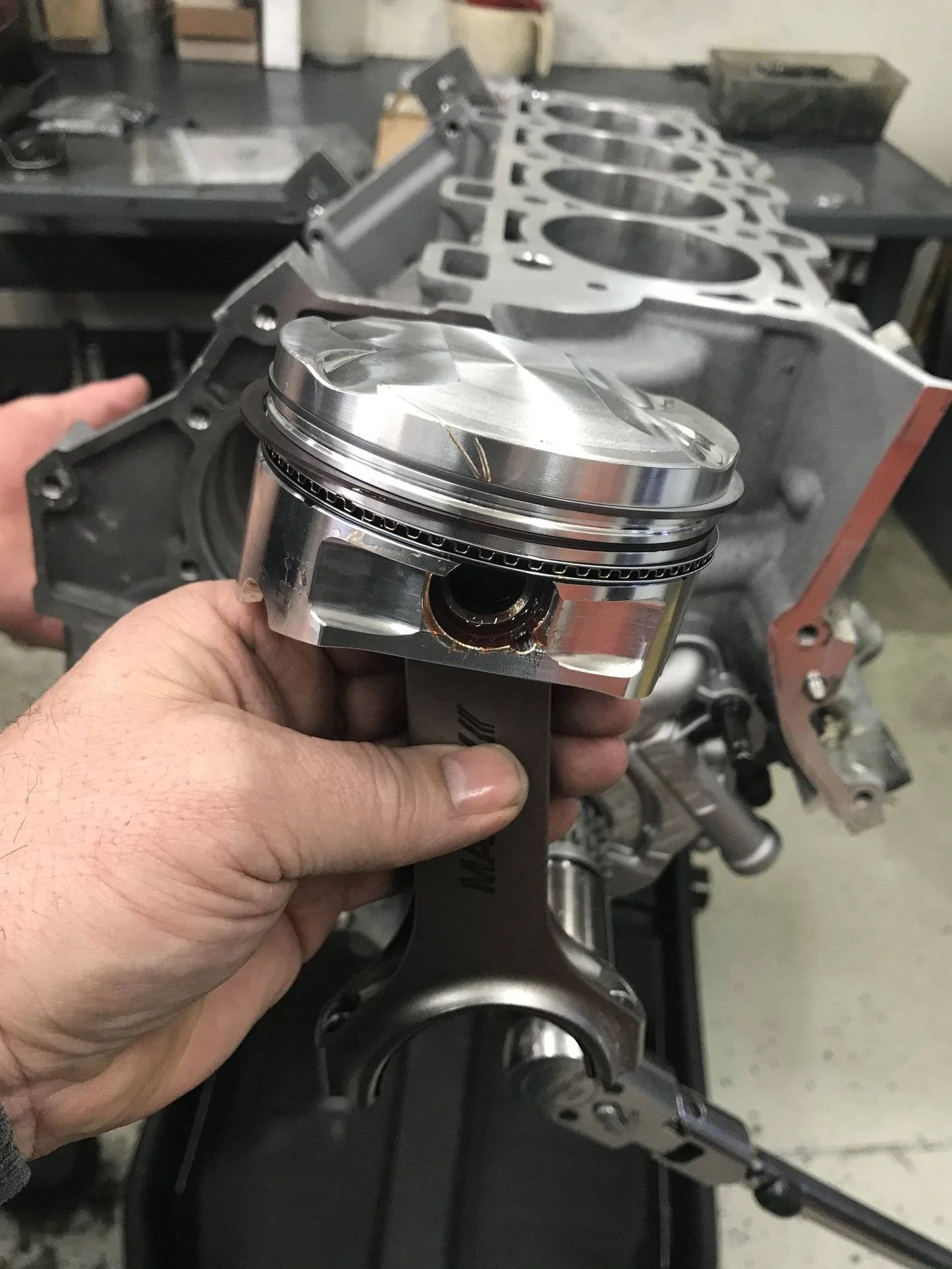

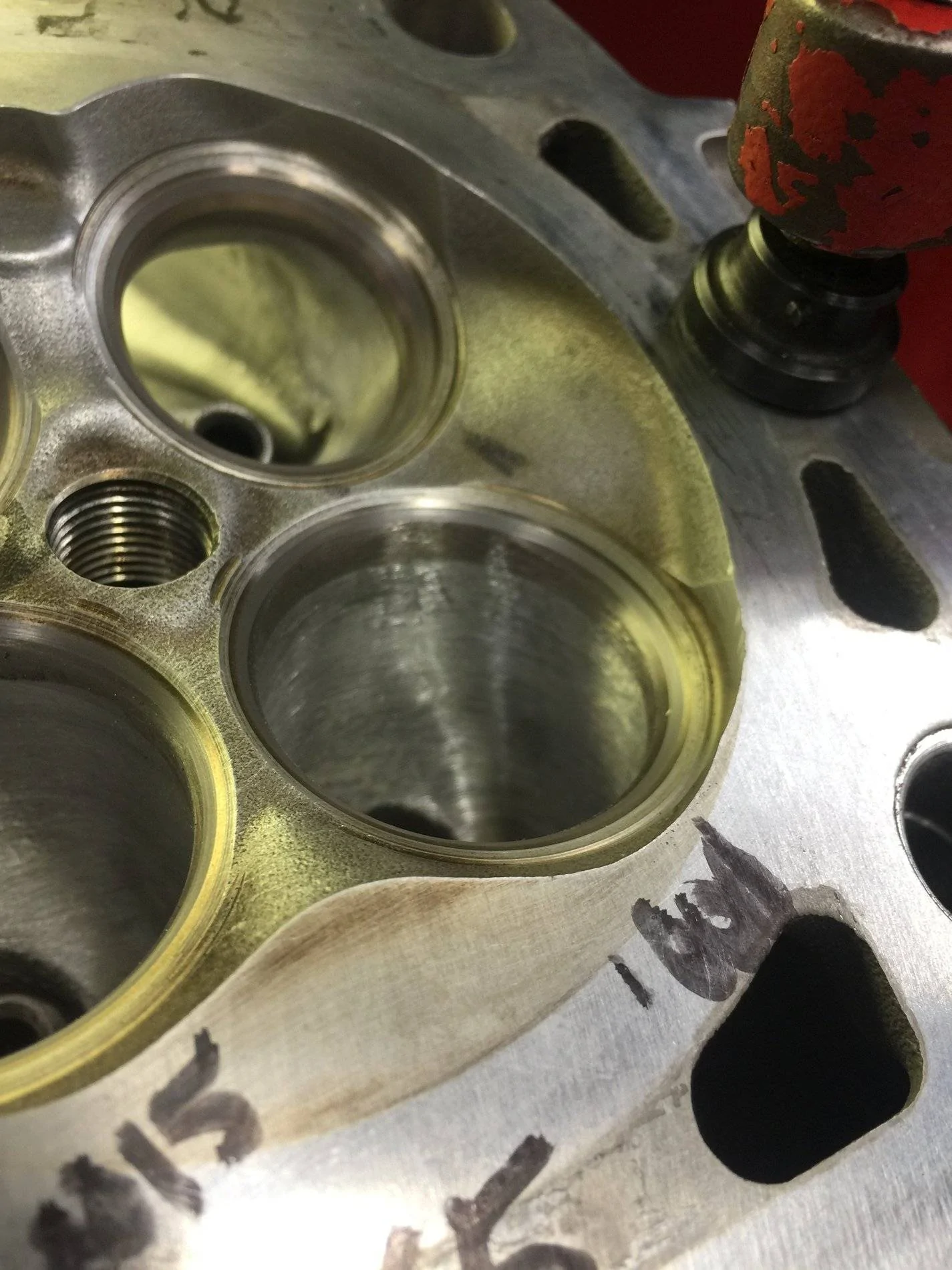

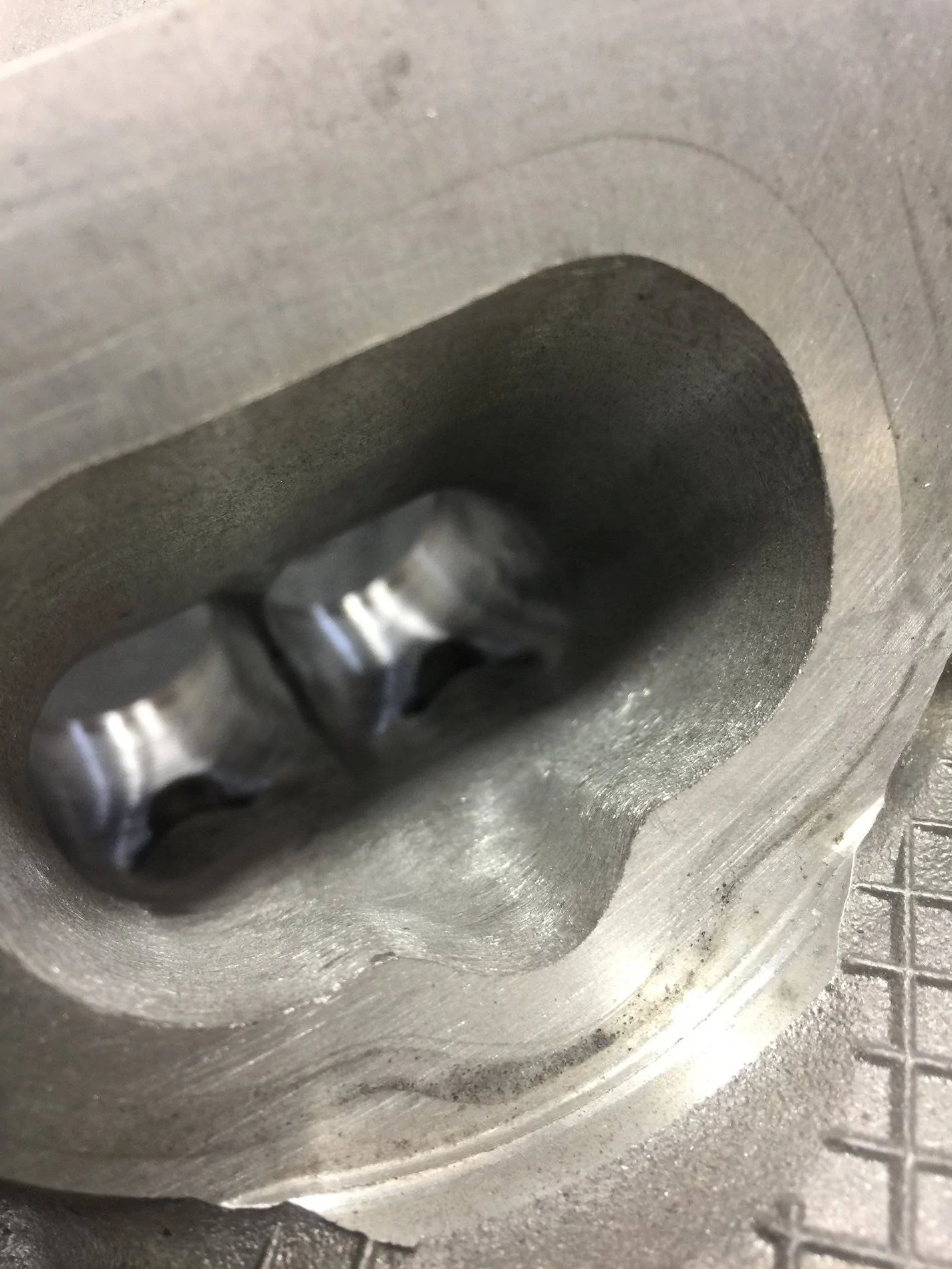

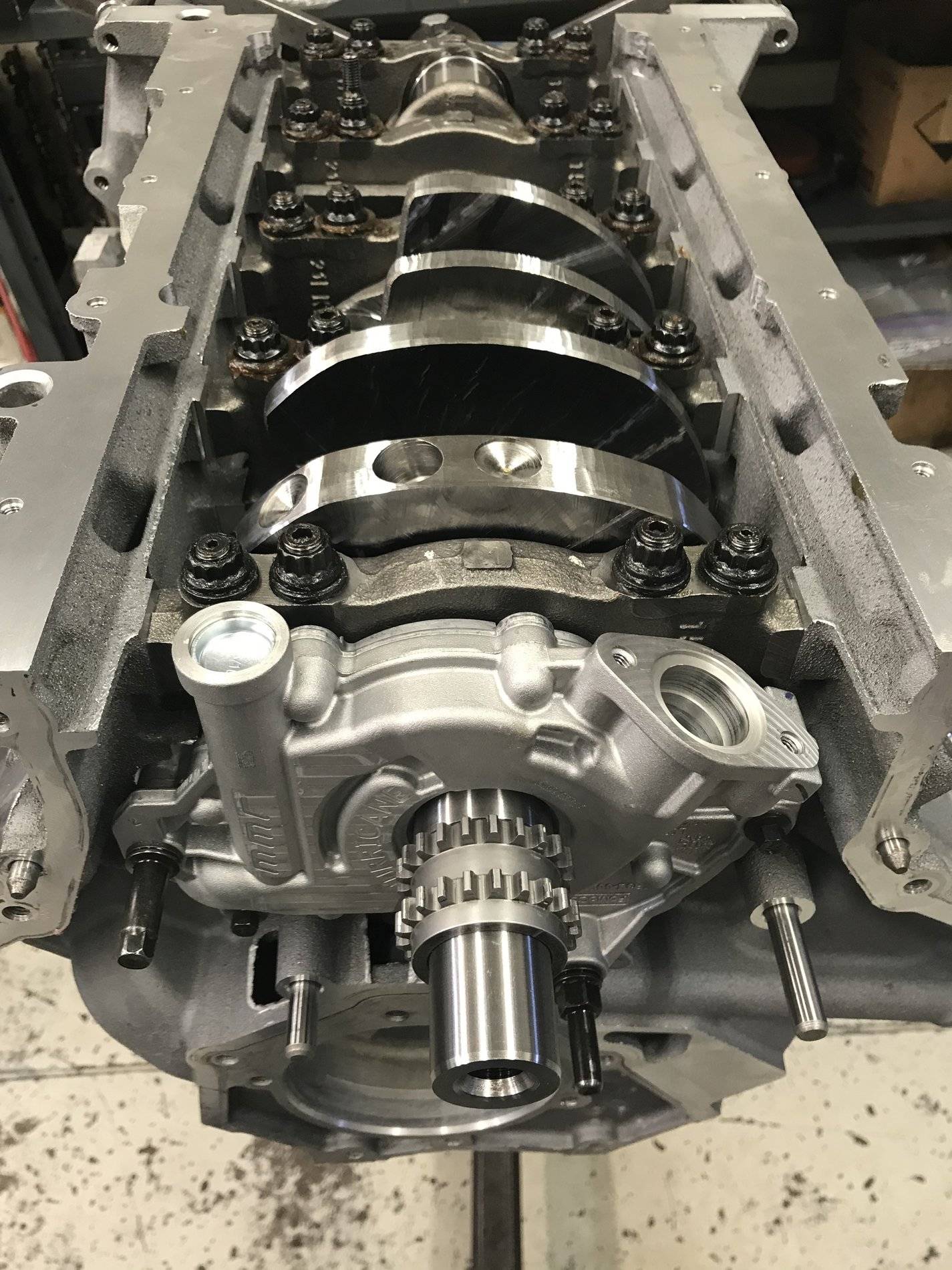

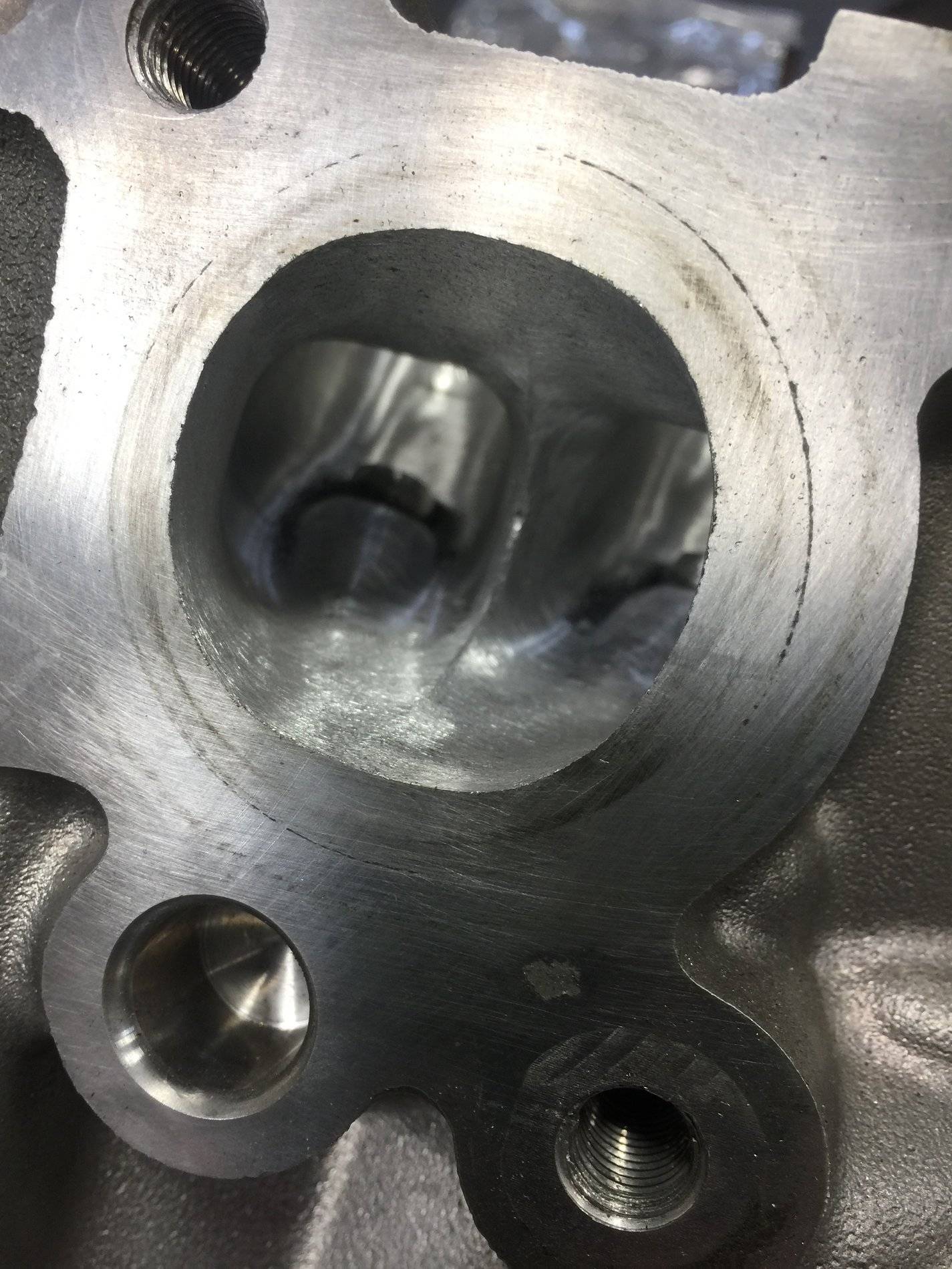

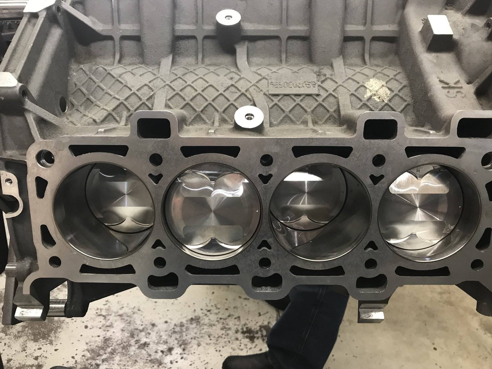

Sorry I haven't updated this in a while. Holbrook Racing Engines here in Michigan is rebuilding my motor with upgrades:
- Diamond Pistons 11.5 to 1
- MANLEY Forged H-beam Connecting Rods
- Moroso Aluminum Road Race Oil Pan (20572)
- CYLINDER HEAD PORTING
- COMP VALVE JOB
- CompCams CR NA Stage 3 cams
- BEEHIVE VALVE SPRINGS
- CLEVITE bearings
- ARP bolts everywhere
- ATi balancer
- MMR Hurricane Oil Pump
- TSS Crankshaft Sprocket Gear
- HD chains

How much oil does the Moroso pan hold and what type of springs did you go with?
Any plans on adding an accusump? Would be cheap insurance for that 5 figure motor and presumably 8000+ rpm.

The moroso pan hold 9 quarts. I had not really considered an oil Accumulator... but now I am.
