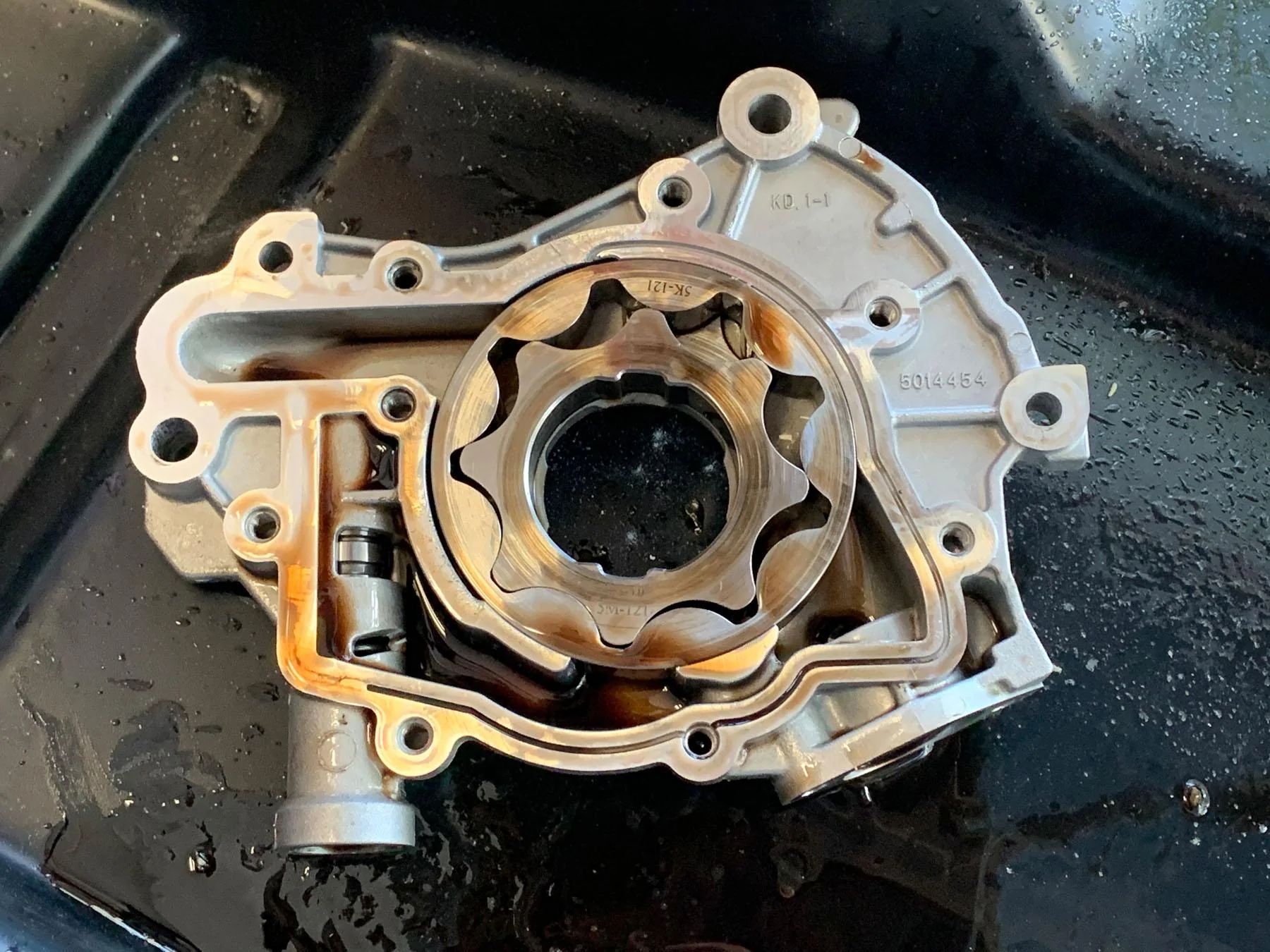

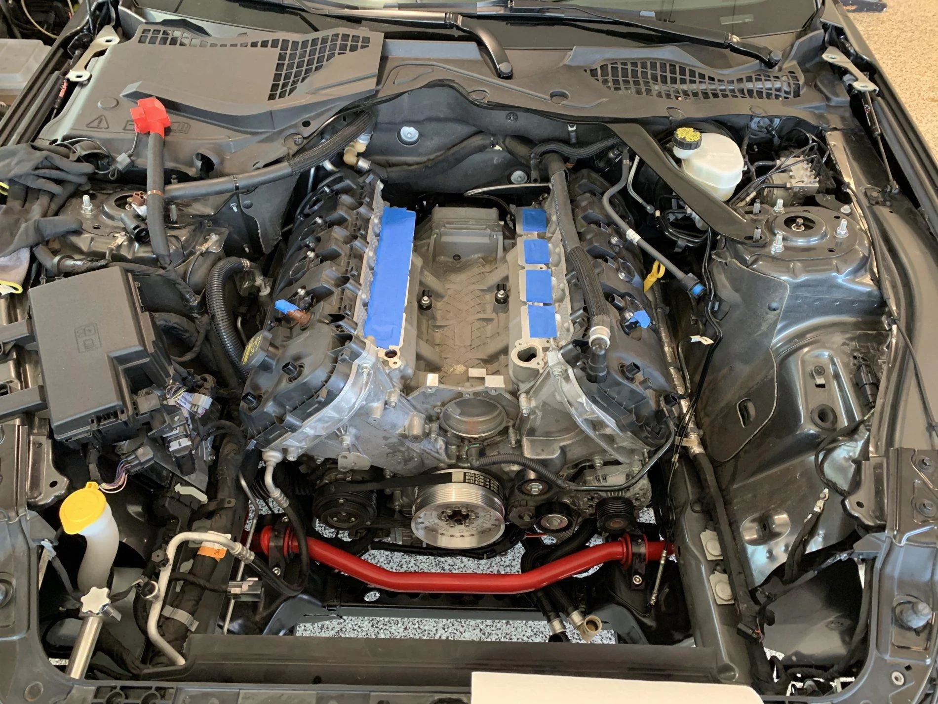

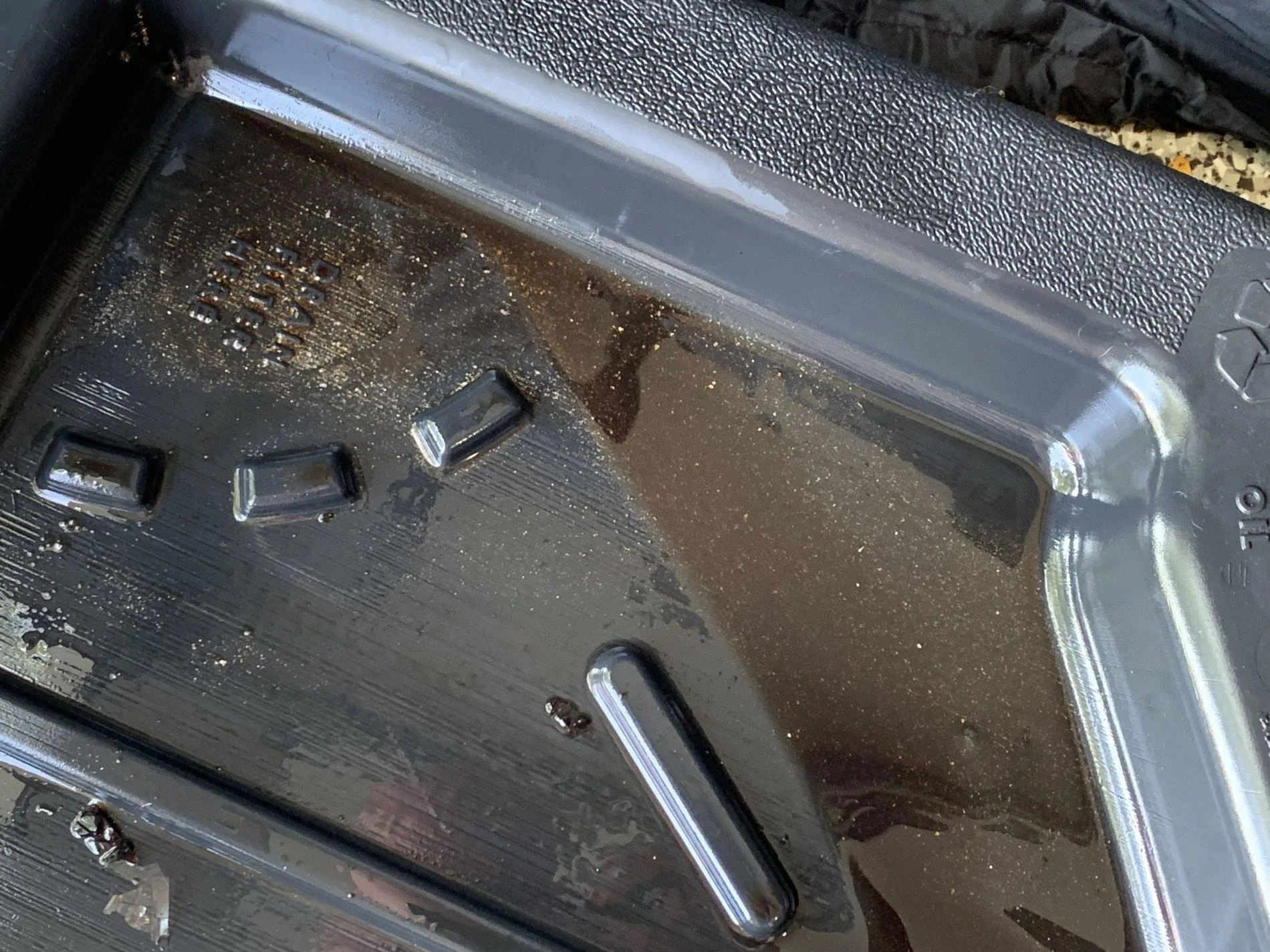

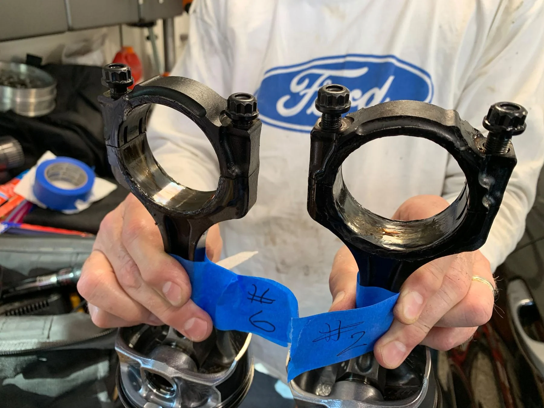

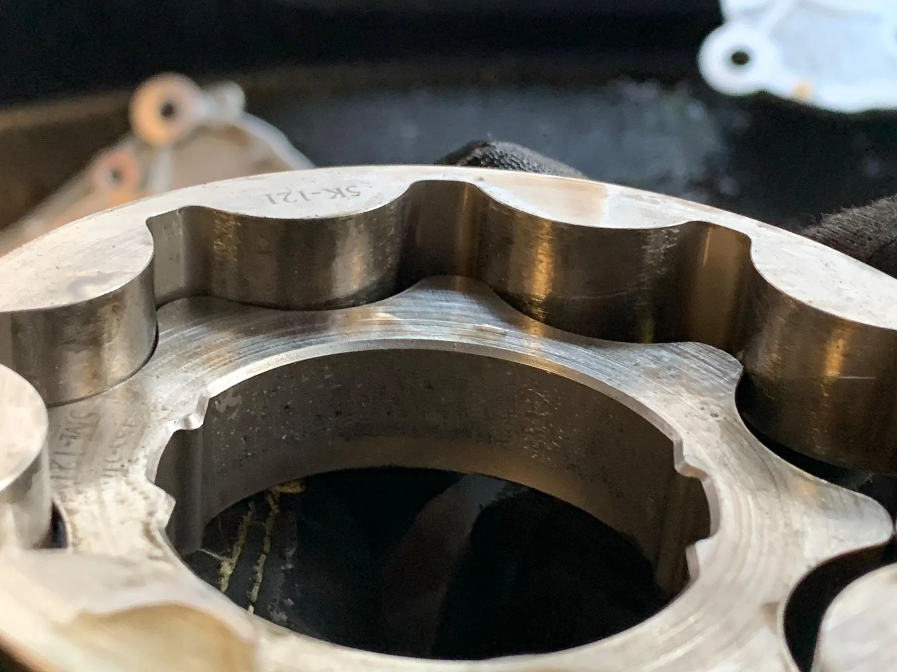

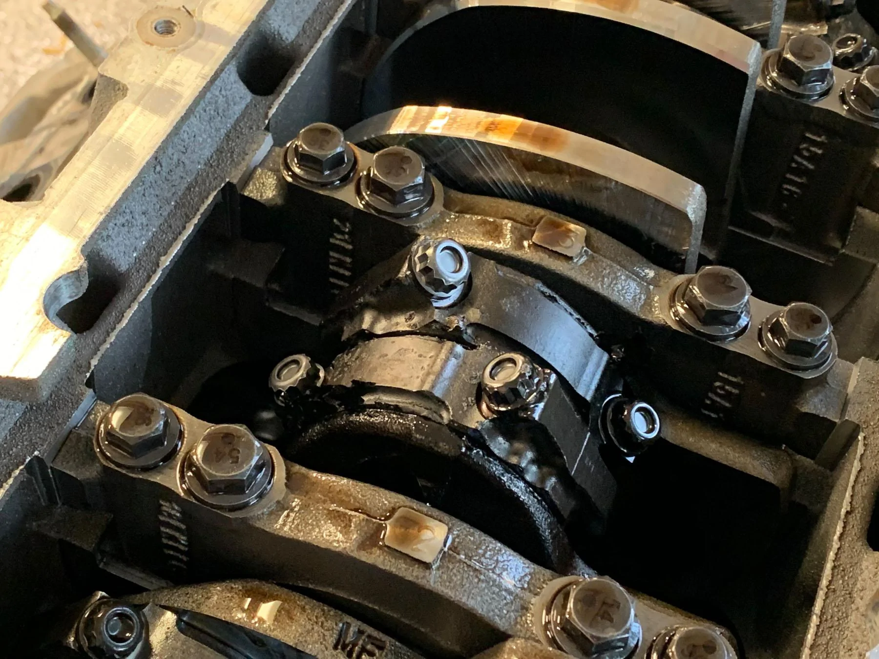

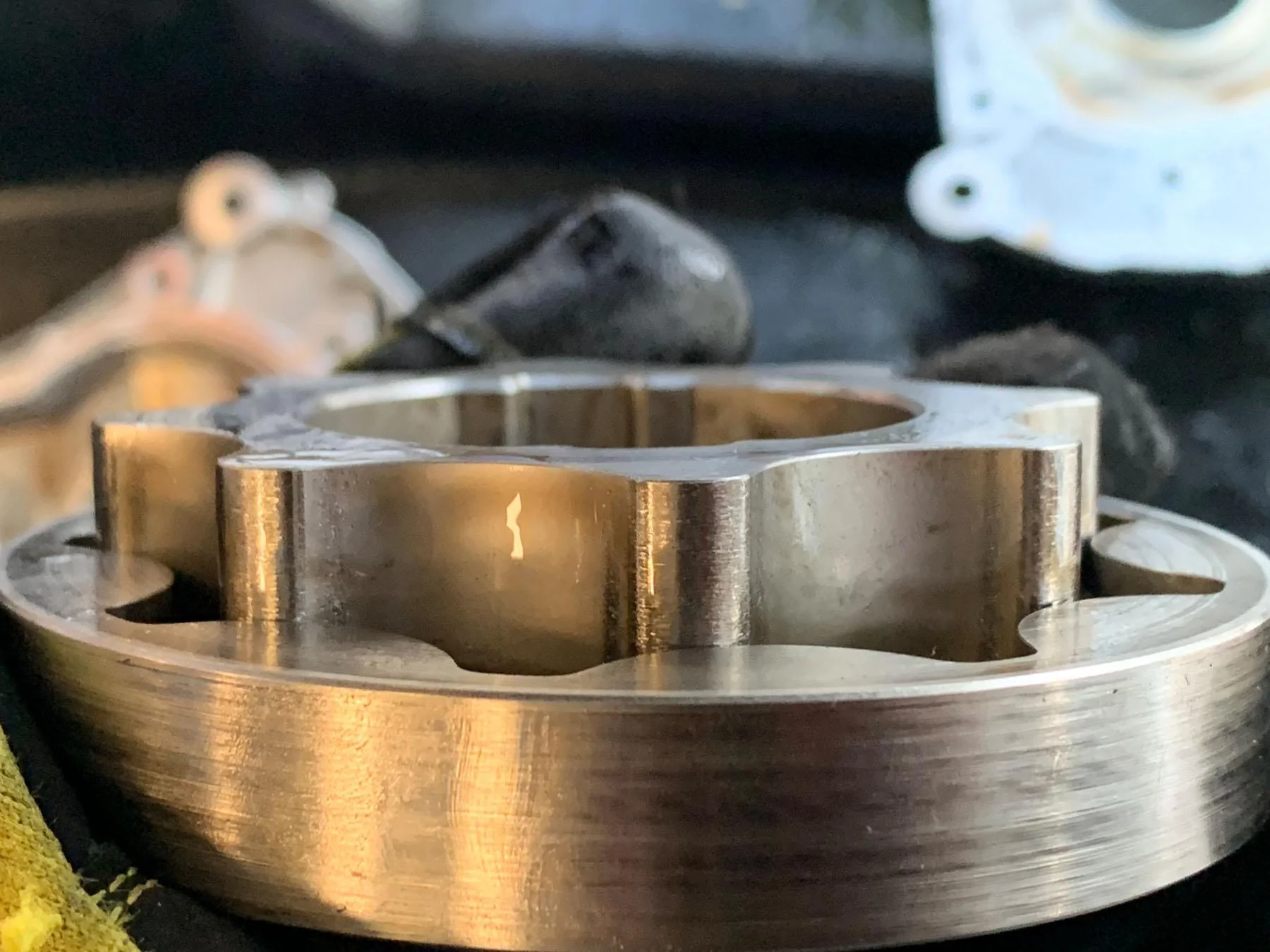

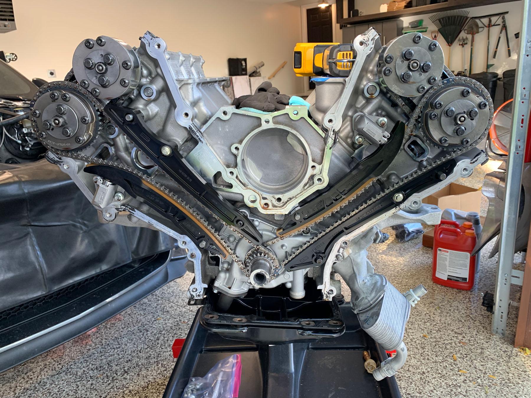

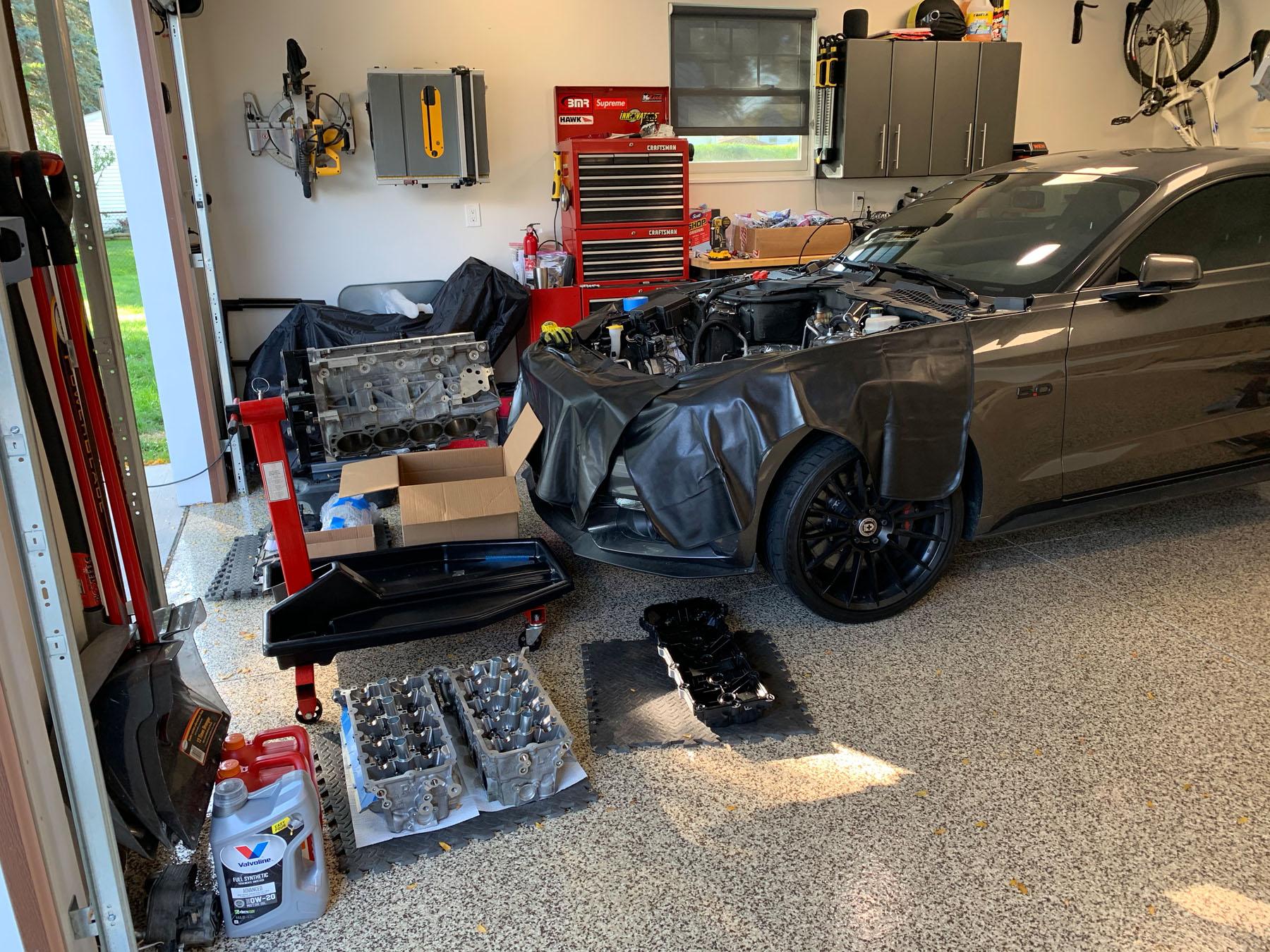

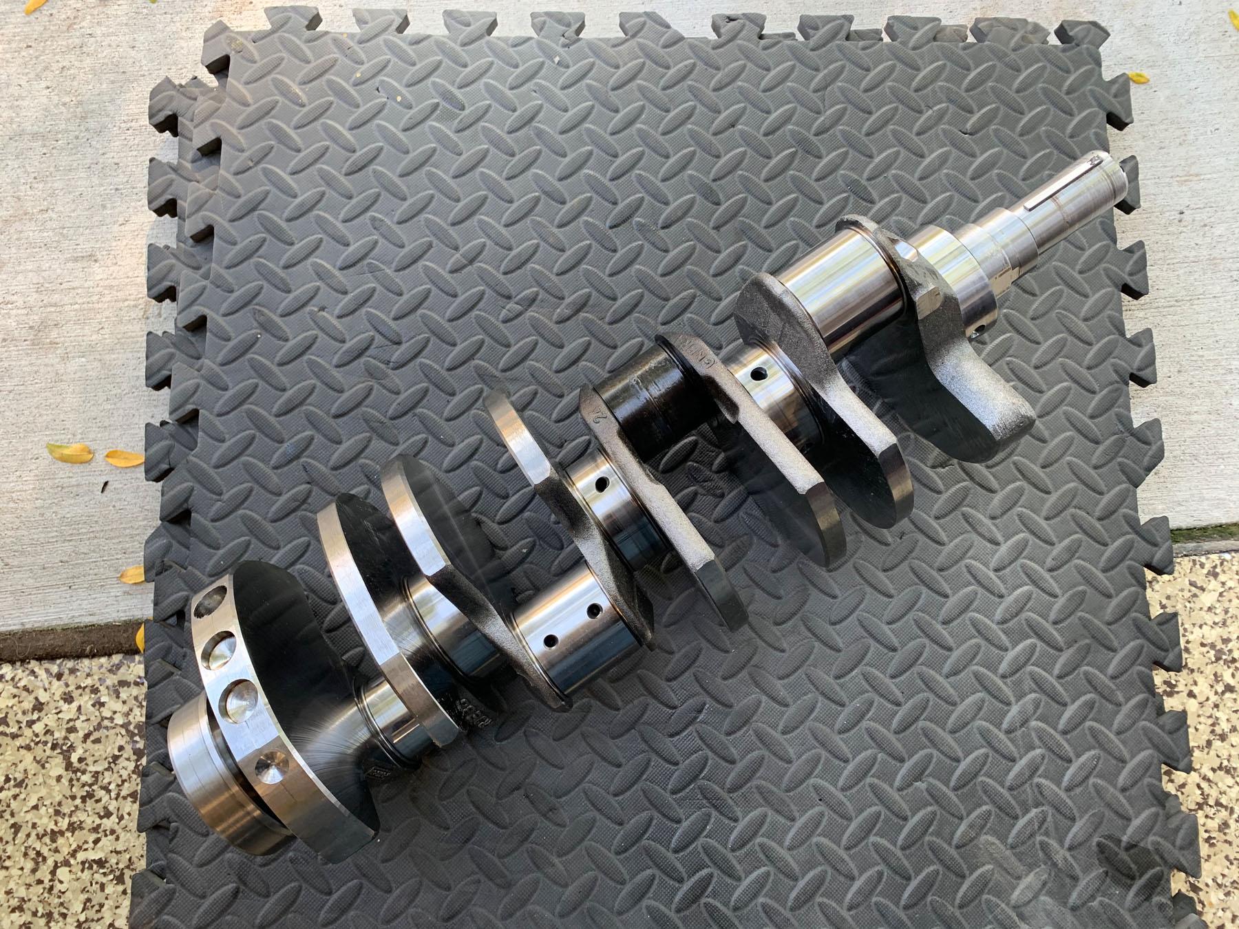

Well folks the motor is finally out and apart. Sorry it took so long. Work's been nuts.
Looks like Oil starvation from HIGH-G + HIGH RPM + HIGH HEAT = two spun rod bearings. The melted bearing material clogged the oil pickup tube resulting in loss of oil pressure. My TSS OPG's did not fail but they are rather scratched up. There does not appear to be ANY valve to piston contact or damage to the heads, pistons, cylinder walls or timing system.
The crank looks toast as well as two rods. I think I need a Moroso Road Race Pan.
