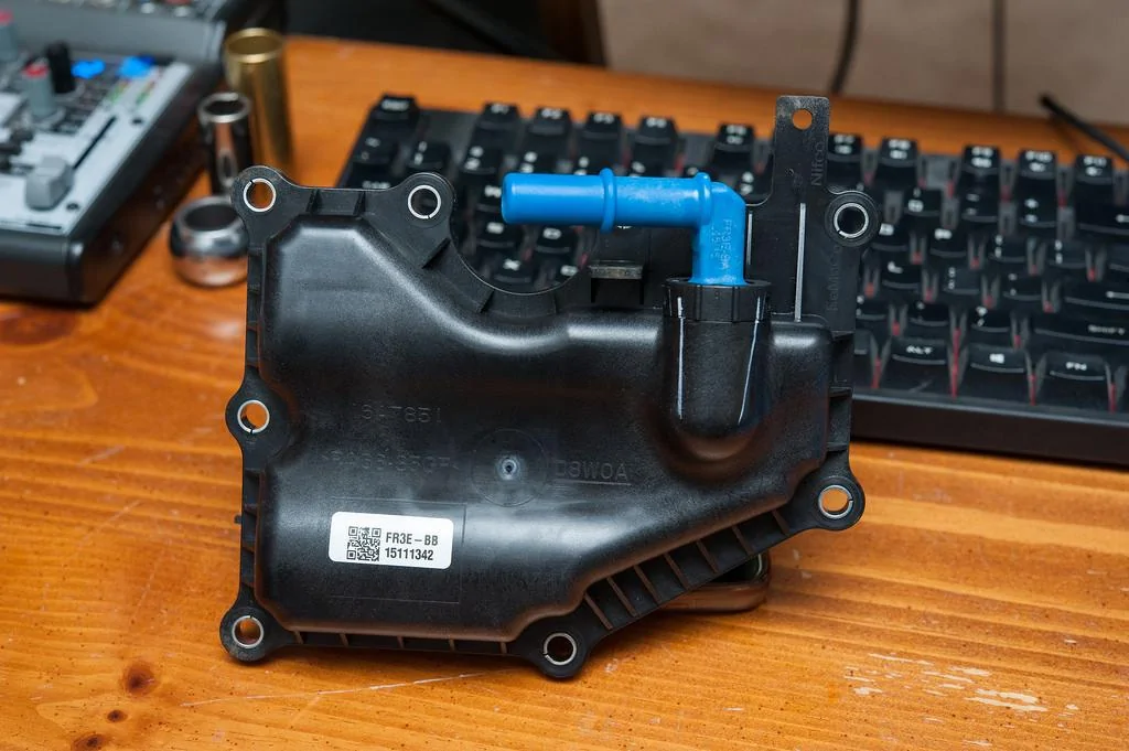

Yea, this has me thinking I should just install the TSB pcv that has been sitting in my garage
Sent from my SM-G935V using Tapatalk
That doesn't look like the Revision C oil separator from the TSB. All the pictures of the revised oil separator's as well as the one I just installed on my car have a Blue PCV and the barcode replaced with a QR code.
