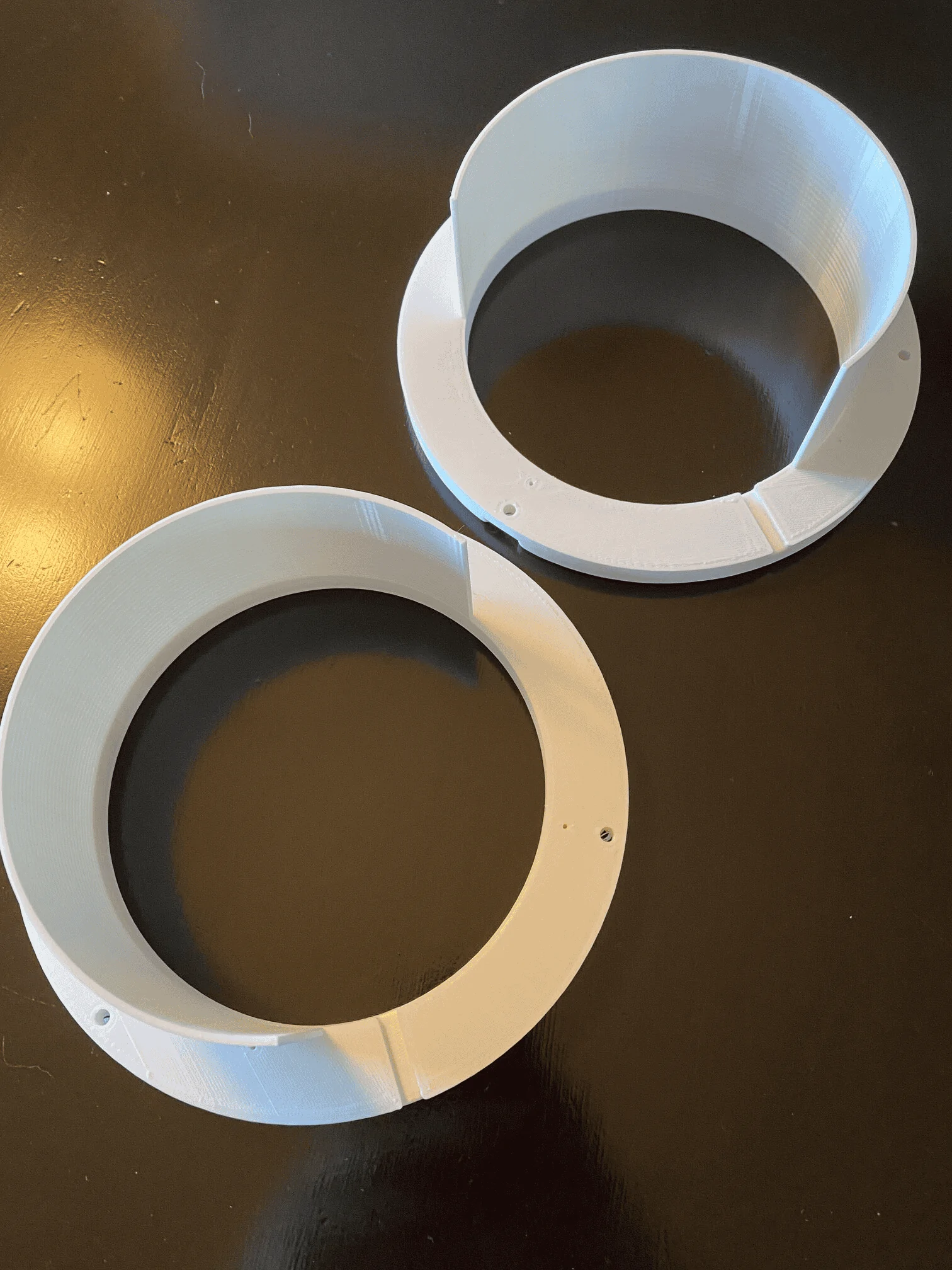

That's correct about the crossovers. I bought the Mille 2-way set (active system. so I didn't use the crossovers). The mid-bass drivers fit just fine with a little custom spacer work. See the link below. At the bottom of the post is a PDF file for the spacer drawing. I also have a 3D printer version for these spacers that includes a rain shield if you have a 3D printer.
https://www.mustang6g.com/forums/threads/upgrade-9-speaker-system.148312/post-3030397

Those look great but I don't have a printer yet. Maybe my kid has access to one.
