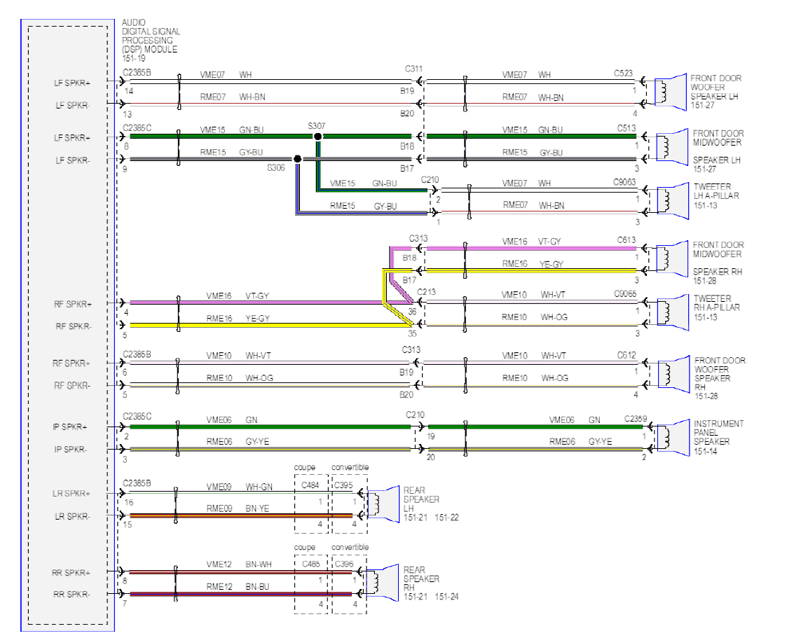

If I attempt to run a set of 2 way components off the factory amp am I going to have a dead spot in the midrange?
If the 6.5 location only has low frequency are the mids expected to come from the 3.5" that would be removed?
You’ll likely be missing some of the mid range where vocals are at. But the bigger worry is your 3.5” is wired in parallel with your tweeters so removing it will change the amps output to 4 ohms vs 8 and will likely cause your new tweeters to have more output and unbalance the system.
That's correct. Lower door is low passed, midrange and tweeter are high passed and are wired in parallel. Additionally, the tweeter has a secondary high pass filter (6db/octave) consisting of a single inline capacitor.
To use the OEM amp, you would need to buy a 3-way speaker setup WITH a passive crossover. Use the passive crossover to run the new midrange and new tweeter as a 2-way setup with the 6.5" mid-bass running direct off the OEM amp. Do not use the factory tweeter connection as it is tied to the midrange wiring. Or simply use a coaxial midrange/tweeter combo in the upper door and whatever 6.5" you like for the mid-bass. Disconnect the factory tweeter and call it a day.
Is the tweeter high pass filter attached to it? If I remove the tweeter will the filter go too? Is the Is there anything between the amp, midrange, and tweeter to interfere or is it just straight wire?

Is the tweeter high pass filter attached to it? Is there anything between the amp, midrange, and tweeter to interfere are is it just straight wire?
The tweeter filter is attached to the tweeter body. If you unplug the tweeter, the filter stays on the tweeter. Straight wires from the OEM amp direct to the speakers with nothing in between, with the exception of the parallel connection of the midrange and tweeter. That is buried somewhere in the wire harness. Never did find it.
The OEM 9 speaker system is basically wired like a 2-way active system in that there are only 4 amplifier channels powering the front (dash speaker excluded).
Here is a system diagram:
Another idea:
So I could remove the 3.5" speaker, tie the 6.5" wiring to the 3.5" in the door that would feed the tweeter and add a new 4 channel amp and a iDatalink HRN-AR-FO3 feeding LF, RF, LR, RR and ditch the factory amp? I saw some other diagrams that looked great but I didn't save it and now can't find it again.
I'd still run a separate amp for the sub if needed. If I can stay small and fit one into the existing location I'll be happier.
I did save the schematic with the Cat6 and the 9 wire cables, that is also a viable solution if I can find connectors.
