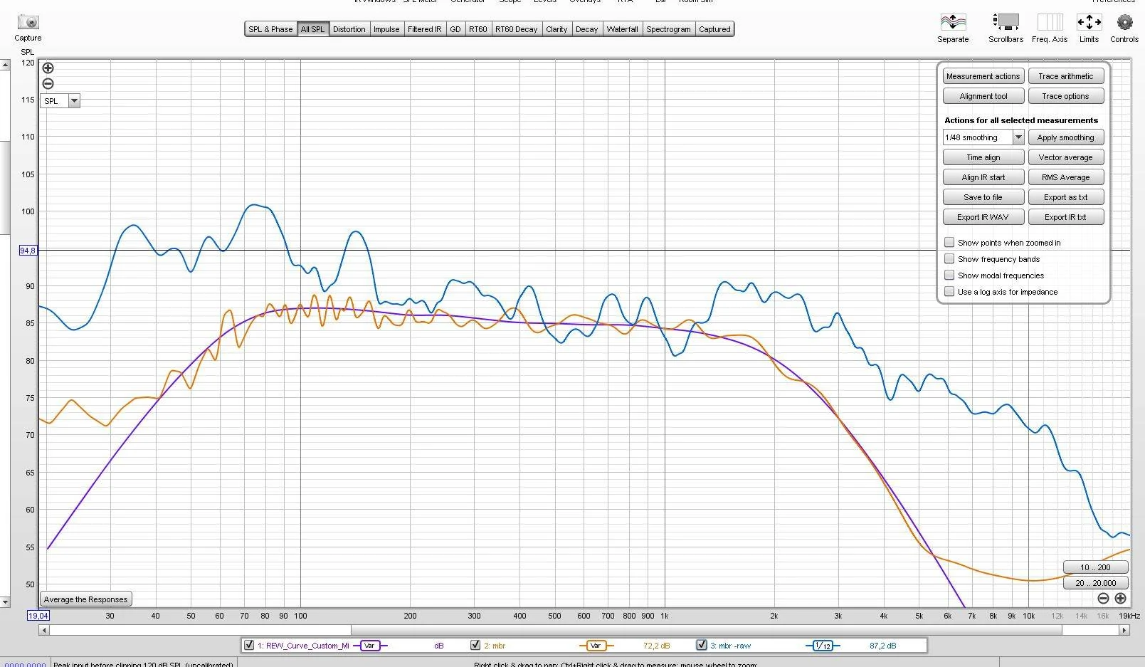

Not enough resolution tbh, but almost 50db difference between subwoofer and tweeters are not that good. 20db difference between 20 and 20k Hz would stretch it imho and is subject to personal taste, but 50db is insane.
f.e. this is what my right midbass looks like with a 5 db resolution and 1/48th octave smoothing before equalizing and after equalizing.

Well, Hanatsus curve is for a bigger car. In such cars you usually have a steeper roll-off to the highs as the bass needs to be louder in larger cars. Check the Whitledge curve f.e. it's even steeper from bass to highs than Hanatsus curve as far as i remember, but John Whitledge has a big van, not a small car like the Mustang. ;)
But (!) always keep this in mind. The only judge is you. If it sounds good to you then great, but i usually recommend to try different curves with different slopes and take a listen and adapt your own curve to the best of all curves combined. Maybe you like the bass in the current house curve, great, but maybe the mids are not exactly what you want, then raise/lower the mids as needed. Same with highs... it's an iterative process and can take a while, but this makes it a hobby, right?
