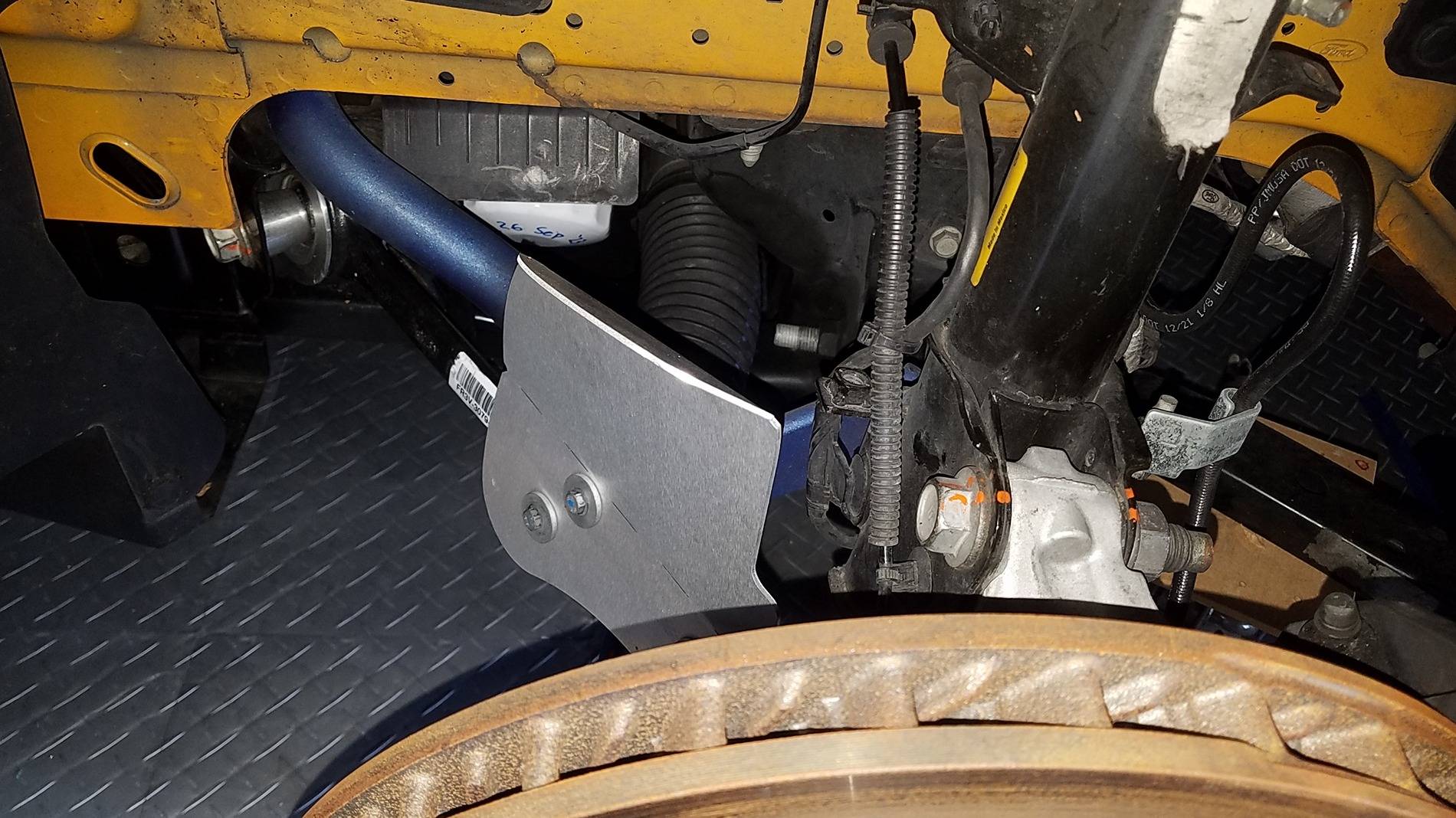

Buy Vorschlag S550 brake cooling deflector kit plates to help direct cooling air to your front rotors and that will more than take care of any leftover brake heat issues at your level of experience and stock Ecoboost performance. Before you track again, UPGRADE YOUR BRAKE FLUID. Motul 600 or 660, or Castrol SRF. Do NOT skip this step and do NOT use your OEM brake fluid for the track.
Now after all that is done go enjoy!
Haha Thank you. I actually flushed my brake fluid and filled up with motul 660 while I installed the 6p brembo brake :D Thank you for the brake cooling deflector kit. I will look into them too
