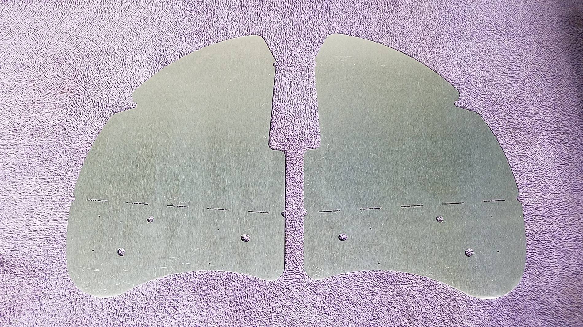

Mine are larger and yet better clearance to the barrel of wide wheels, and also accommodate a spherical bearing as a future mod. The laser-cut edges are very nice, too.
oh nice. Where do you sell yours? Also are they compatible with ecoboosts? Other brake deflectors indicate that they are designed for GT's but no mention of ecos...

More details are found in the link in my signature. I will send you a PM.
In this photo you can see that my vanes will even work with control arms without the 3 tapped bosses. The 4 tiny holes are located for re-drilling for U-bolts. So yes, they will work with Ecoboost arms.
