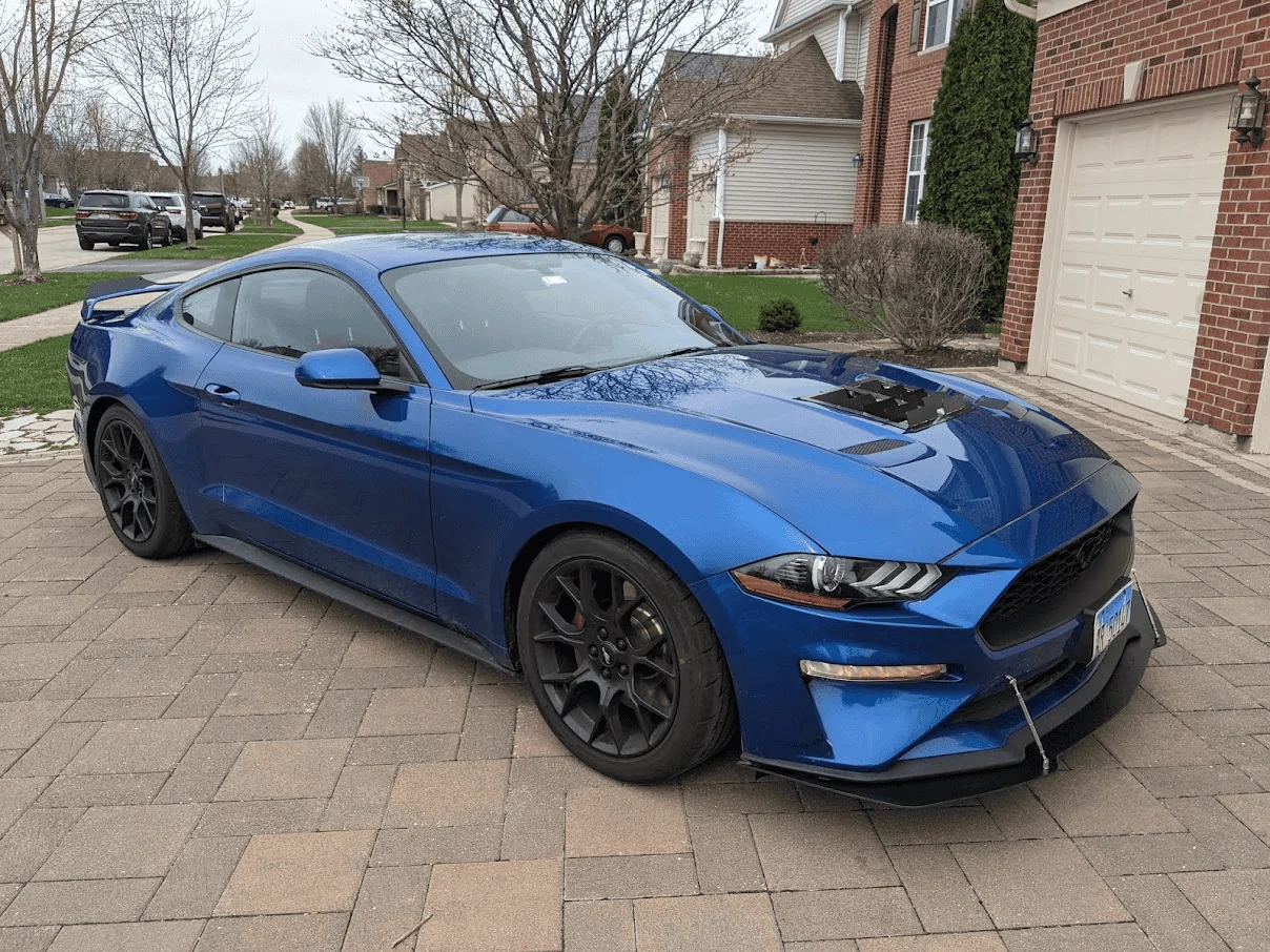

Interesting. Are you able to run flat out for 20 min without coolant or oil temp issues? Do you have any cooling mods? My car, with stock tune (larger intercooler), Mishimoto rad and oil cooler, plus ducting for the rad and oil cooler, can't run flat out for more than a couple laps before the coolant temp approaches 250 and oil temp 290. I just added a large hood vent to hopefully solve this issue. But this has been my main concern with adding any kind of tune, i.e., if I can't keep the motor cool with stock power levels, how could I possibly add more power?

But obviously, bringing down the temps is why I have done all of the mods to the car, including adding hood vents. If I can keep the coolant temps in the 220-230 range, that should keep the oil in the 260-270. That will work fine.
