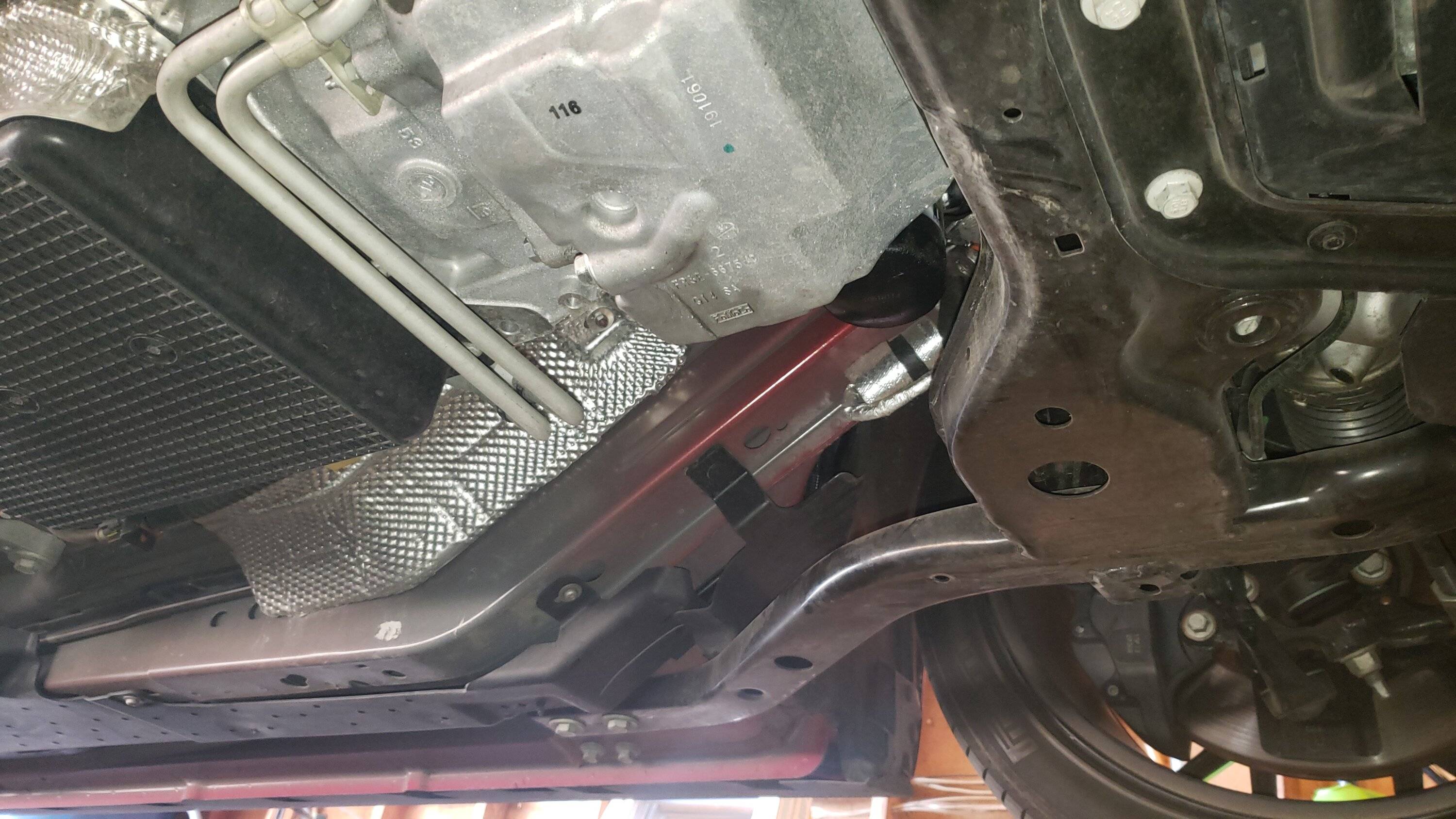

i'm looking at picking up a used mishi oil cooler but not putting it in the grille area. There is a ton of room where the drivers side exhaust runs on the GT. this cat scratcher is roughly the size of the core. along with custom brackets i would probably find a way to include a fan. Luckily this is on the same side of the car as the oil filter, so the hoses could be shortened up.
I think the Mishi oil cooler is too small to have any material impact on oil temp, at the track. I put mine up front, ducted around it, exhausting into the wheel well. Doesn't do much. A fan may help.

i forgot your cooler wasn't directly infront of the rad like just about anyone with an oil cooler. i happned to stumble across something from honda about inferred oil temp that it could be taken from coolant temp and also oil pressure amongst other things. Presumably considering higher oil pressure would equate to a lower oil temp. Your Mishi kit has a 4-6psi pressure drop, which could lead to a higher calculated oil temp.
i have the ability to go back and use racerender from my last hpde session to overlay cylinder head and oil temp.
