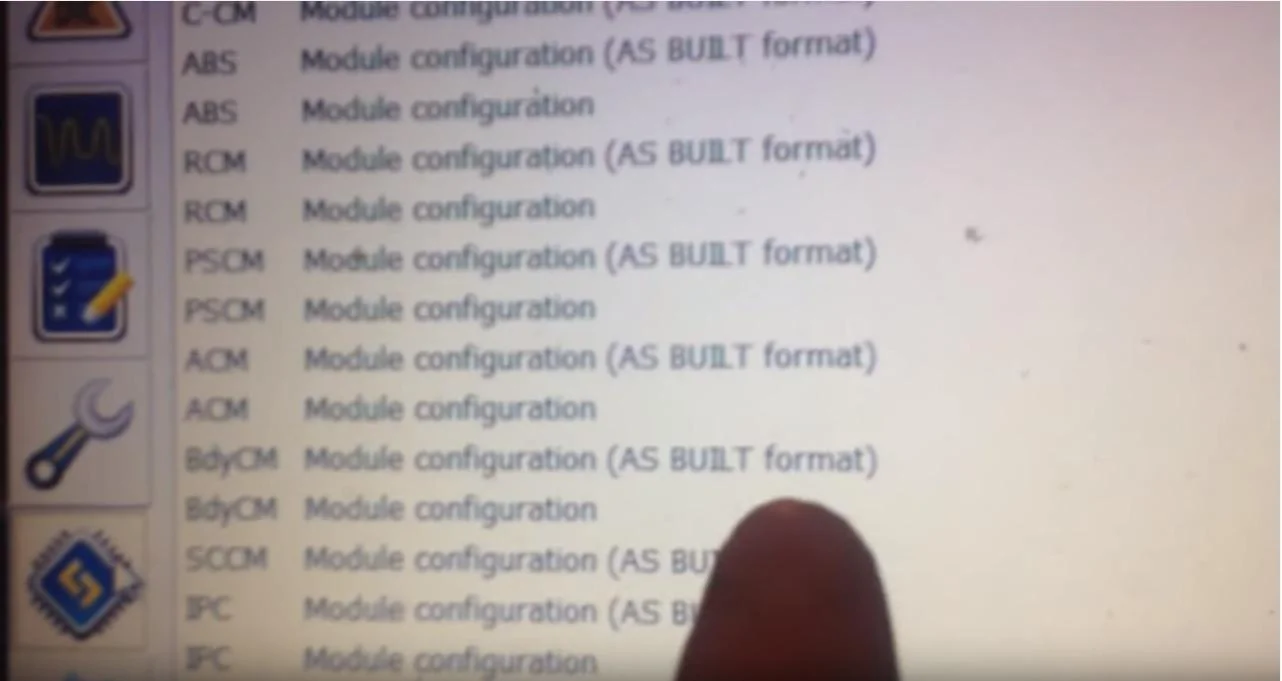

[MENTION=19362]StrongFord[/MENTION], No disrespect, but truly its idiot proof. It takes less then 2 mins to do it. If you have the OBDII MX scan adapter and the forscan program I can either walk you through it, or I can remote into the computer and do it myself. Just so you know, there is NO code to manually enter for this, its a lamen drop down menu and choose what you want. See the attached image: http://www.mustang6g.com/forums/attachment.php?attachmentid=90047&stc=1&d=1470701438

Ok, so here's how far I made it. From here I wasn't clear what I should change to eliminate fog lamps 'on' during DRL mode. The S550 As-Built Values list doesn't really cover that issue. Would one of these apply?
Simultaneous High Beams & Fog Lights Disabled BCM 0726-27-01 xxxx xxx1 xxxx
Simultaneous High Beams & Fog Lights Enabled BCM 0726-27-01 xxxx xxx0 xxxx
Simultaneous Fog Lights & Turn Signal Disabled BCM 0726-28-02 xxxx x1xx xxxx
Simultaneous Fog Lights & Turn Signal Enabled BCM 0726-28-02 xxxx x0xx xxxx
Plus, on this screen I'm not too sure if I update both the -01 and-02 rows. And I wasn't too sure to do after making a change. This is where I bailed out.

Thats not the right location for the DRLs, you are in the BCM AS Built format list, just under that SHOULD be another BCM which is the plain english wording as my screenshot (NOT BCMB but just above that) that is where you will find the DRL fog light change located. The location in YOUR screenshot is for the things you listed only. In the attached screenshot BCM and BdyCM mean the same thing, just pick the one that does NOT have "(AS BUILT format)" next to it.

[MENTION=23778]AngelDeath[/MENTION] FIXED!!!! THANK YOU!!!! :headbang::cheers:
Thanks to those that contributed to this thread! Mustang6g WINS over dealership service - but we already knew that!
For good measure I shut off the ridiculous double horn honk too.:first:
WIN!!!!
