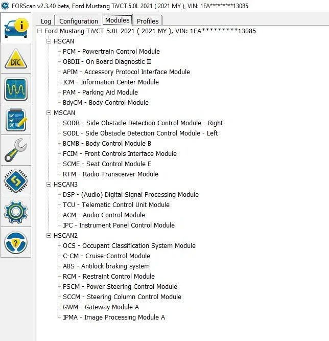

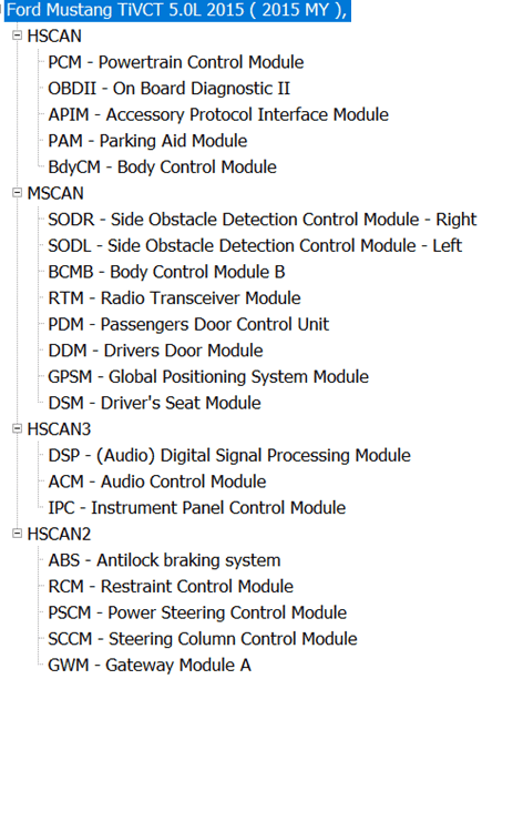

hey guys,
I havent read all 213 pages yet but I am working on it lol. I trying to trouble shoot a can bus issue I been having.
I am using forscan... i was wondering anyone had a screen shot of what modules show up when you scan system when it is working correctly (attached mine).
I am been trying to narrow down the problem. I think I got a short in the harness. I just trying to narrow it down.
I got 2015 gt couple premium with memory
thank in advance for any help I been trying figure this out for months now.

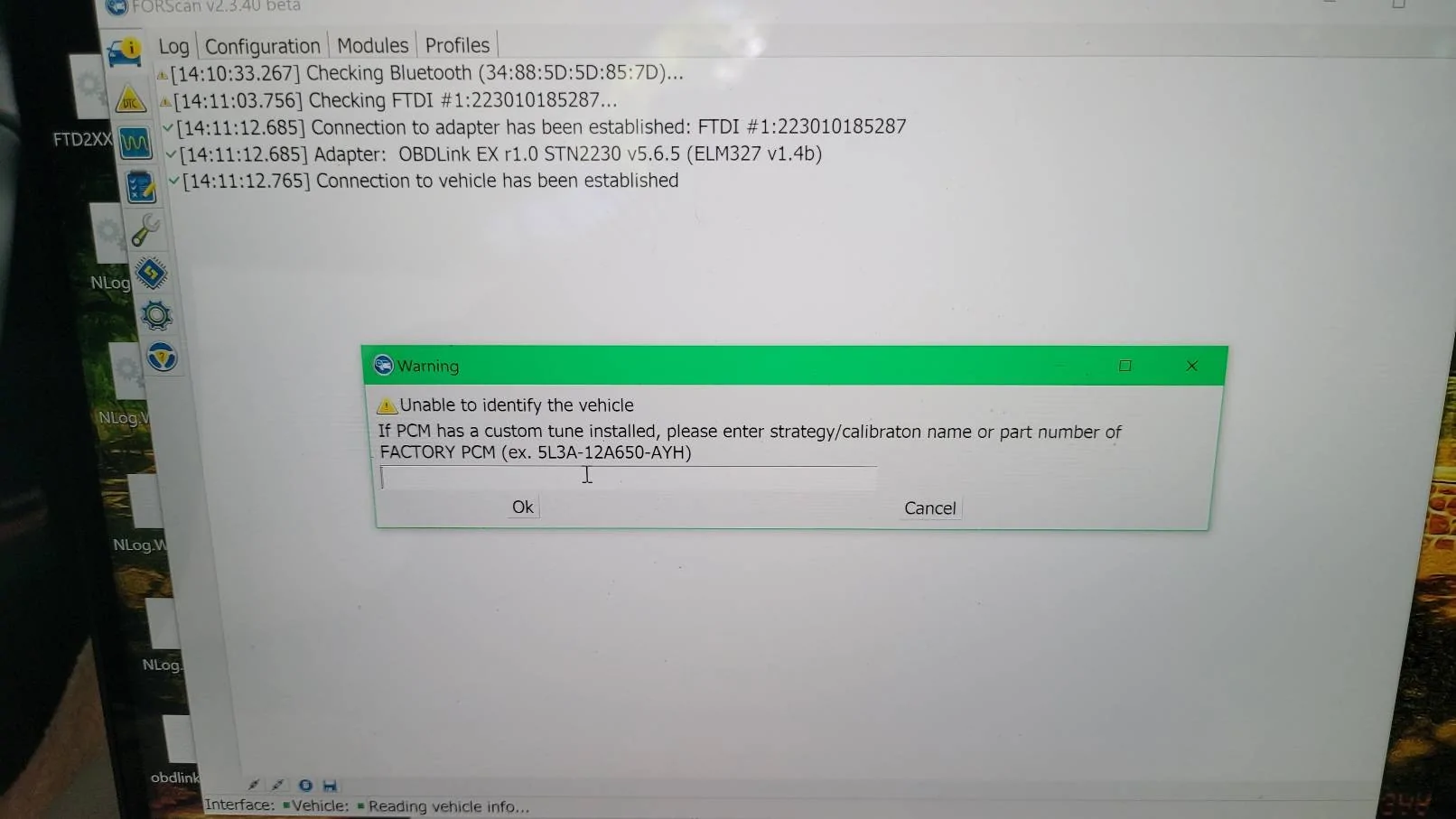

Can someone esee tell me where I can find the information to input here. Thanks.
Just in case you haven't found out how to bypass this.
I went to: https://www.etis.ford.com/vehicleRegSelector.do and entered my VIN.
Then clicked on VIEW PTI INFORMATION and from there I clicked the dropdown menu for PTI related electronic control units installed on this VIN and it was the code under the PCM SoftwarePartNo
HoosierDaddy
Jan 2, 2016
266
4,689
9,084
Randy
I don't see any such option. Below is all I see:
