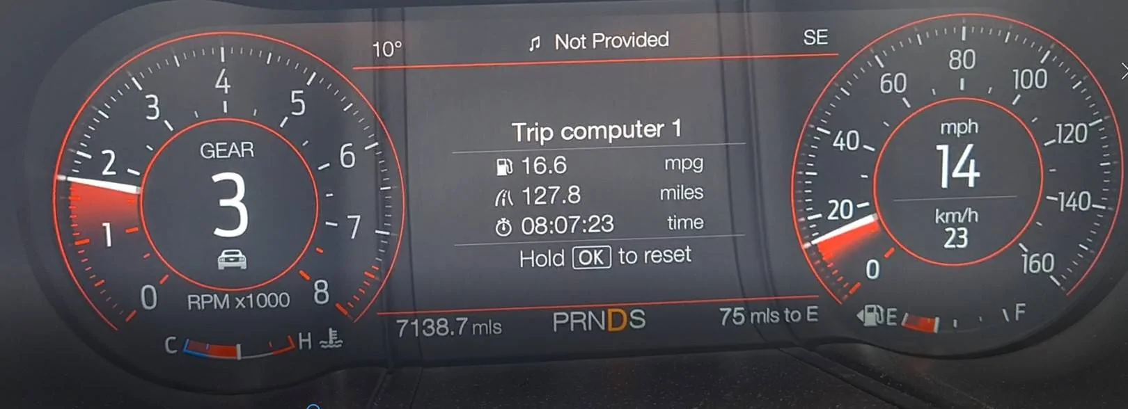

That's odd - mine is an Auto and it shows the gear numbers in Normal mode as well

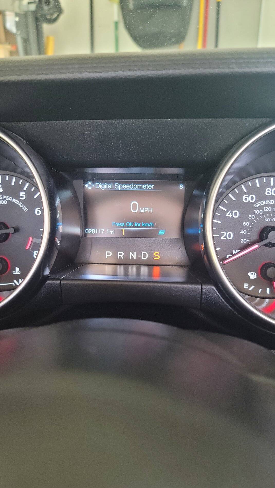

My apologies. I have the non-digital dash. Down where your PRNDS is, mine is too, however the gear shows right next to that PRNDS only in when the drive selector is down to S and you pull a paddle shifter up or down, then it shows what gear you are locked in because it's basically manual mode.
I want the gear display to stay there all the time even in D.

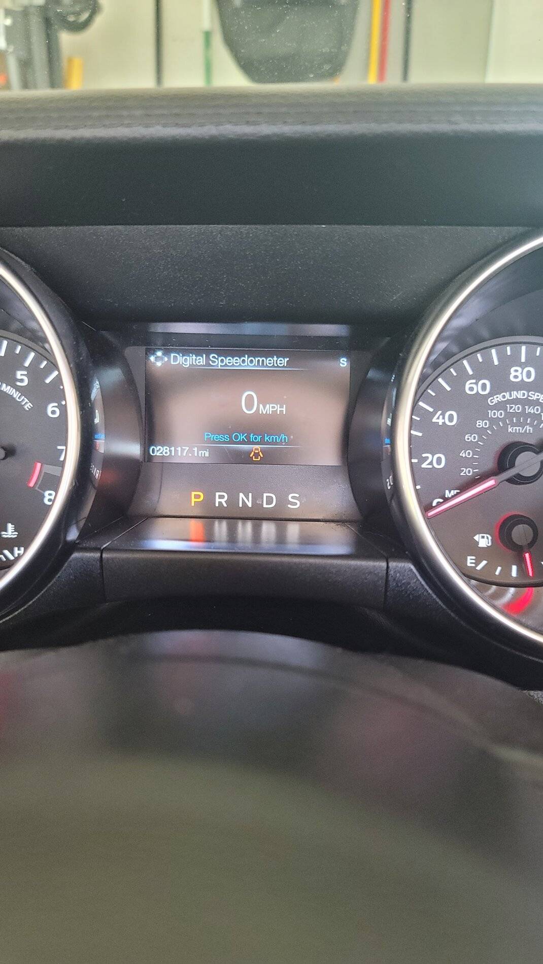

2019 here. This is what it is like unless I go into s. I want it on when just in drive.

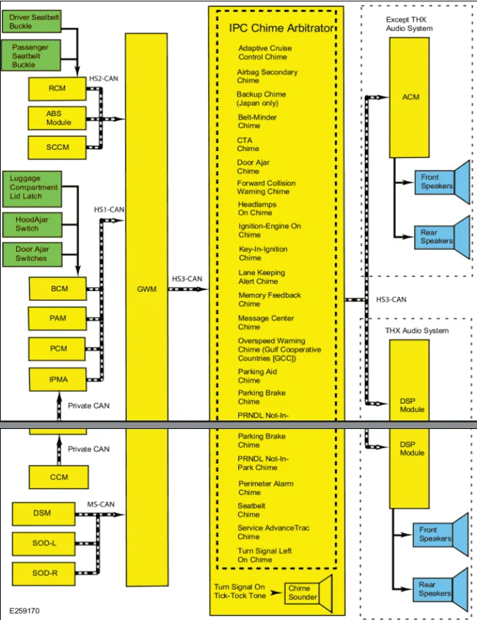

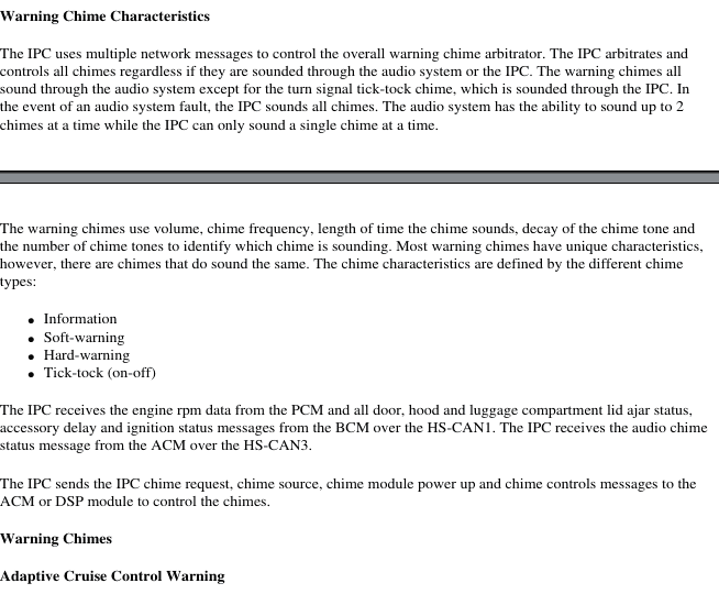

In the workshop manual section 413-01 I found the following note:
The warning chimes are sounded through the audio system speakers and the IPC. The turn signal on
(tick-tock) is the only individual chime that the IPC is responsible for sounding. The parking aid and
Blind Spot Information System (BLIS®)/Cross Traffic Alert (CTA) warning chimes are sounded
through the rear speakers. All other warning chimes are sounded through the front audio system
speakers.
The IPC also acts as a backup. In the event of an audio system chime failure, the IPC sounds all chimes
that are required.
The section continues for 400 more pages (of which about 250 are pinpoint tests and diagnostic tables) including detailed description and diagrams for all kinds of messages, hardwired signals that are transmitted via the gateway module to the ipc. Chimes are specifically mentioned in a subsection.
The following diagram is used to see which kind of chimes do exist and how they are emitted.
Did you check the IPC / ACM and DSP in Forscan already ? I could have a look.
Ideally the chimes can be controlled selectively. It might not be a good idea to disable this warning chime:
For example, when the BCM detects a low brake fluid condition, the
BCM sends the IPC a request through the GWM to illuminate the brake warning indicator and a request to display
the LOW BRAKE FLUID message in the message center. This allows the message center to be a more informative
supplement to the IPC gauges and indicators.
