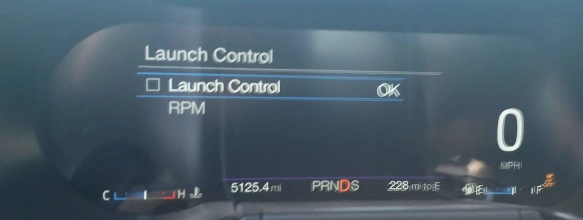

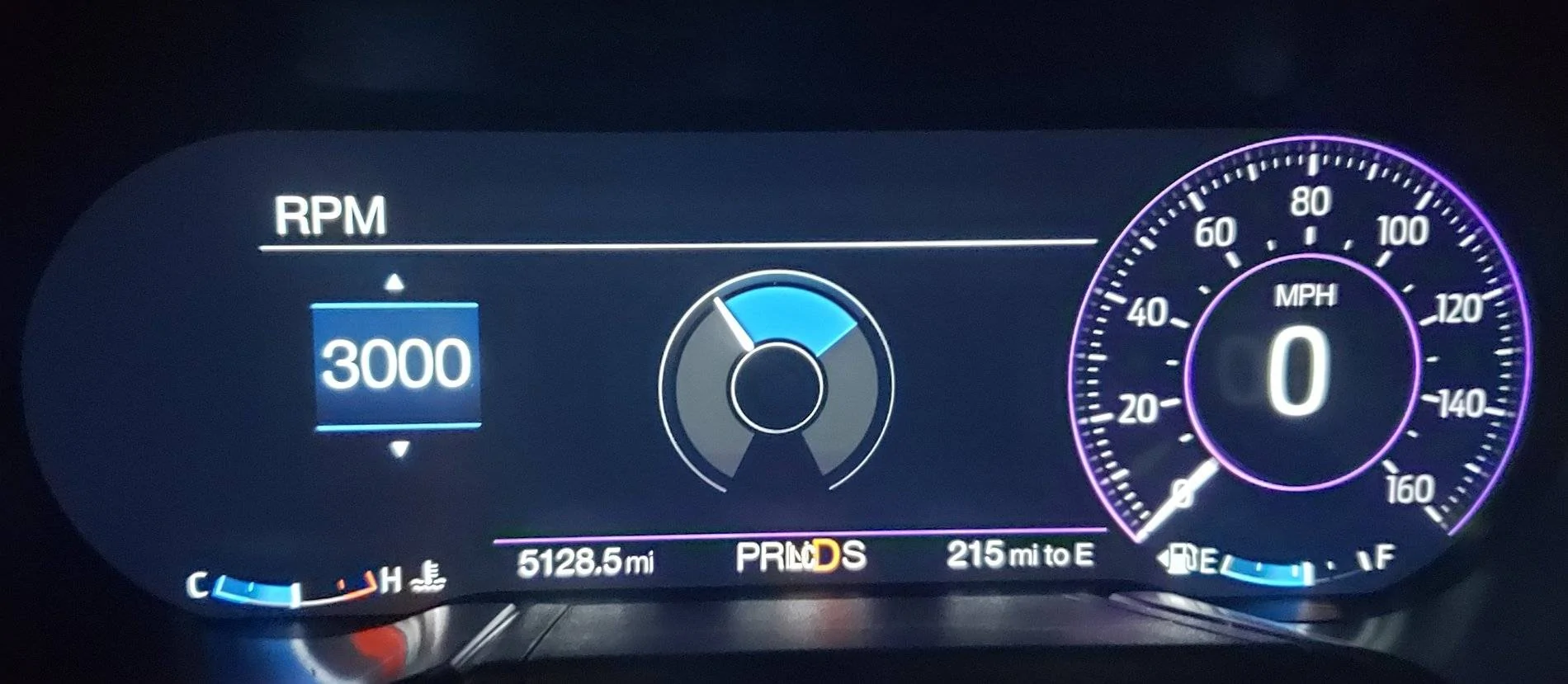

i was looking around thru the different modules (not as built) and ran across a few interesting things.
DACMC:
active noise control: enabled
anti noise control: enabled
engine sound enhancement:enabled
IPC:
launch control: disabled
anyone have any insight about these. can launch control be used on automatics?
edit: tried it out and was able to enable it and set RPM but i don't think it worked, you can see LC overlayed over the gear indicator at the bottom. i had it at lowest setting (3000) and it began to spin the tires from a stop at about 2500
