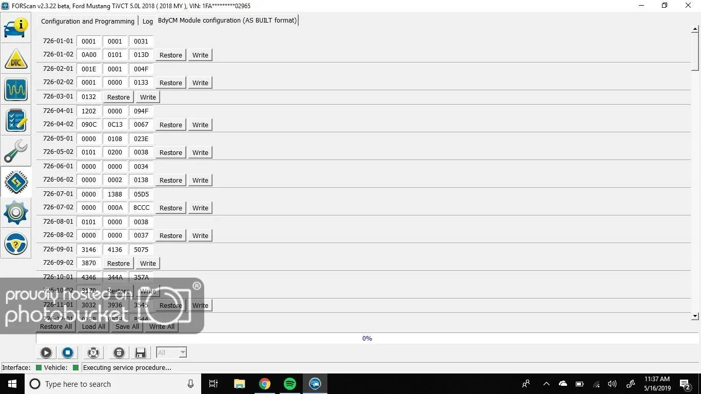

Thanks bro I meant actually finding that data in forscan for my vehicle it seems i may need a better OBD plug to read the IPC, so that arrives tomorrow and most likely was my issue

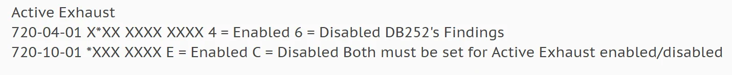

It's in the BCM
Go look at the active exhaust install thread

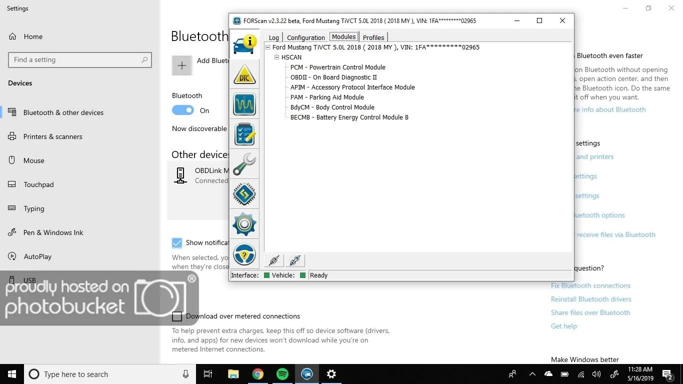

yea i cannot find this line of coding or values in order to edit...

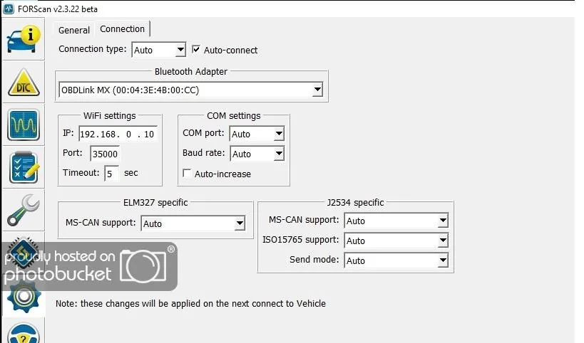

do you have switch on your obd device to switch to MS-CAN? if not looks like your scanner isn't MS-can compatible on only reads HD-can.

the configuration in this menu below?
