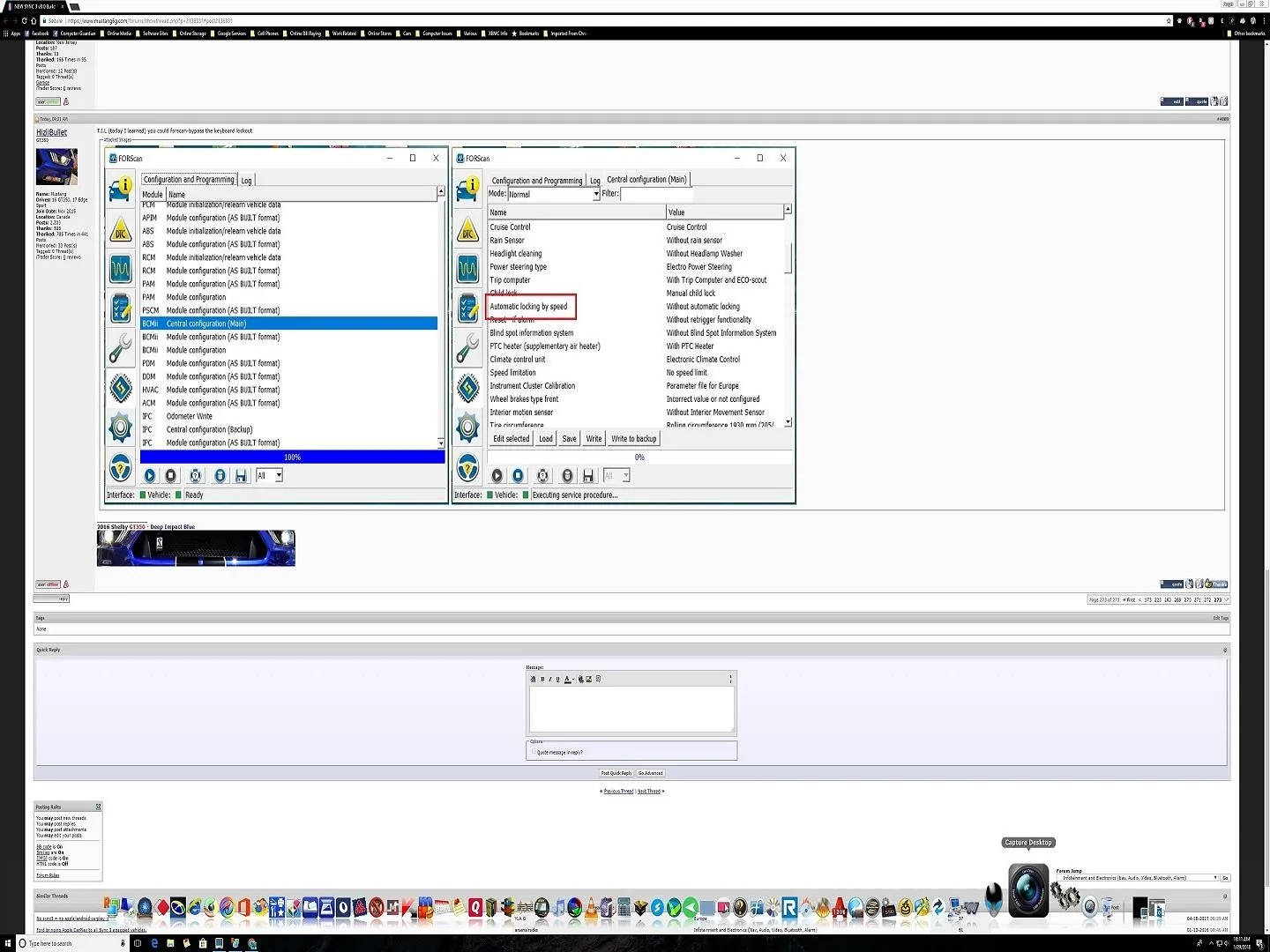

Is there an option that’s accessible in forscan to enable the nav system while moving? Mine locks out as soon as I start driving
[MENTION=33296]cyberdude47[/MENTION]
If your talking about the keyboard graying out while moving, then Hizlibullet posted this but I couldnt find it, but I had a screenshot of it:
I’m not sure but I think you’re screenshot shows the the option for automatic locking doors when you start moving. The setting for the keyboard being accessible while moving is in the APIM:
7D0-02-01 **** xxxx xxxx
It’s actually the Country Code: 5553=U.S., 4341=CANADA;
If you use 5753 (which translates to WS whatever that means) it will allow NAV in motion on Sync2, but Sirius Travel Link no longer works.
Read above the top of the screen shot, clearly says keyboard, this is the common section where you dont have to play with bits. I just cant find the actual post, maybe [MENTION=19817]HizliBullet[/MENTION] can answer where that post was.
*EDIT*
Found it!
https://www.mustang6g.com/forums/showpost.php?p=2136331&postcount=4089
