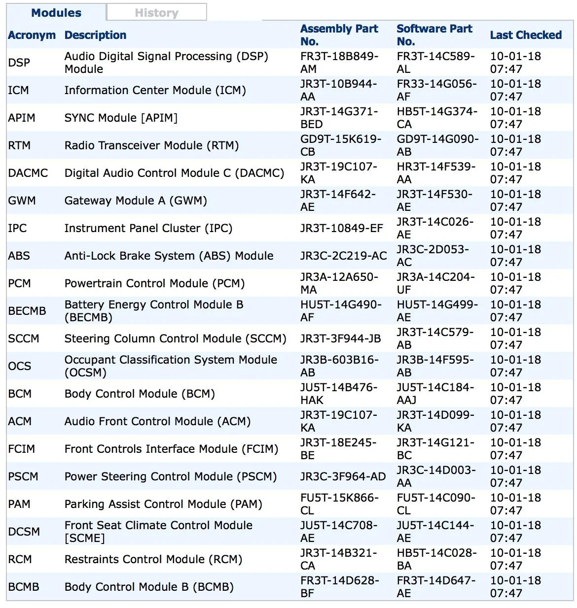

Can anyone PLEASE with MY18 analog cluster share his/her IPC part number? It can be found in Forscan in the modules tab.
Here ya go, these are the modules installed into my 2018 EB Premium w/PP (and the analog cluster). The info is based directly off my VIN and from the Ford ETIS site under the software tab.
