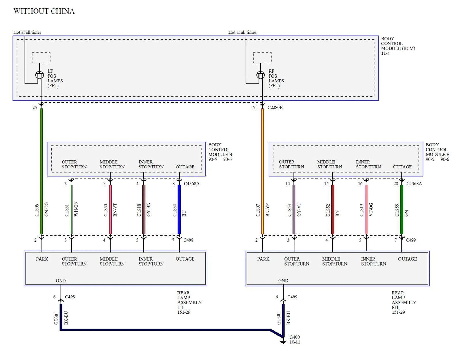

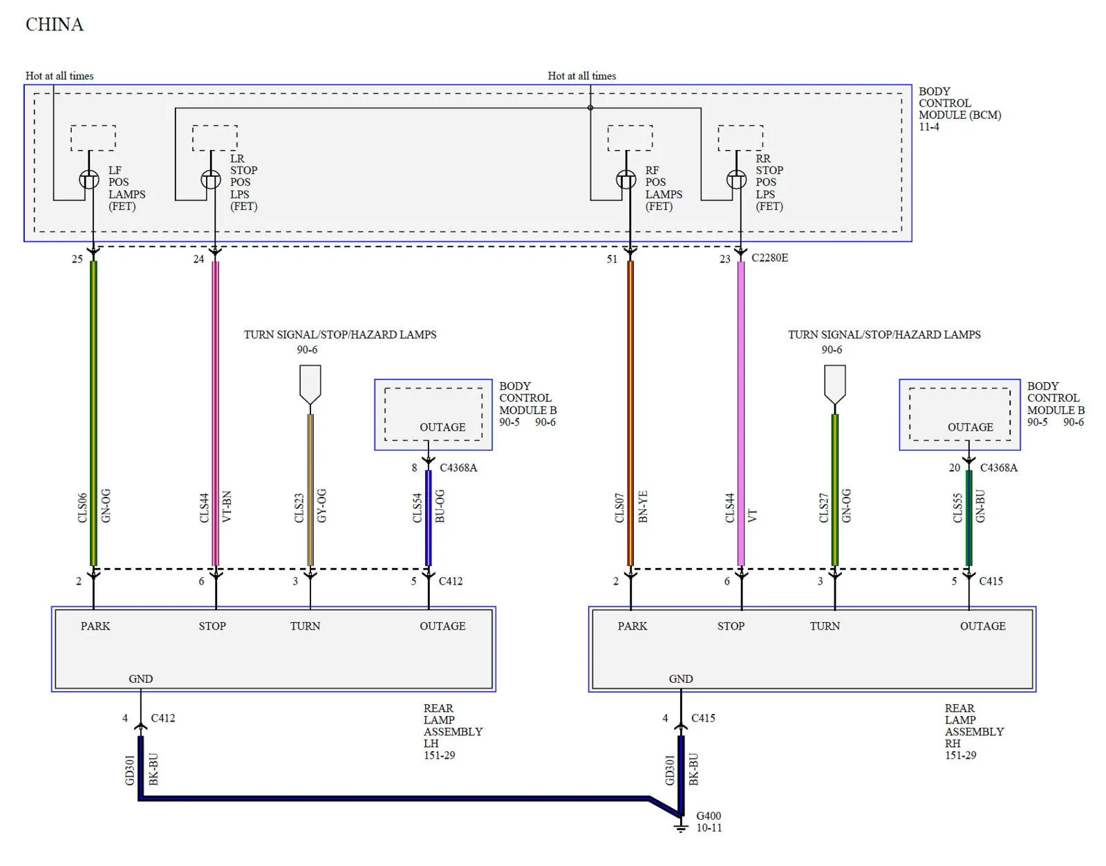

Yes, they blink like the hazard lights.
I know that the wiring is different but right now I cannot find the documentation :confused:
Do you know by any chance the differences?
Here are the tail light wiring diagrams I have...
