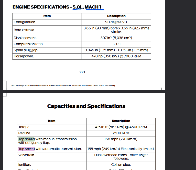

Nov 10, 2022
1,351
1,816
Lee
2022 Mustang
i looked it up again. says its for the 5.0 and the mach 1. there is no section for the GT but there is a section for the 2.3L. this is for the 5.0. according to the manual sticks aren't electronically limited.
