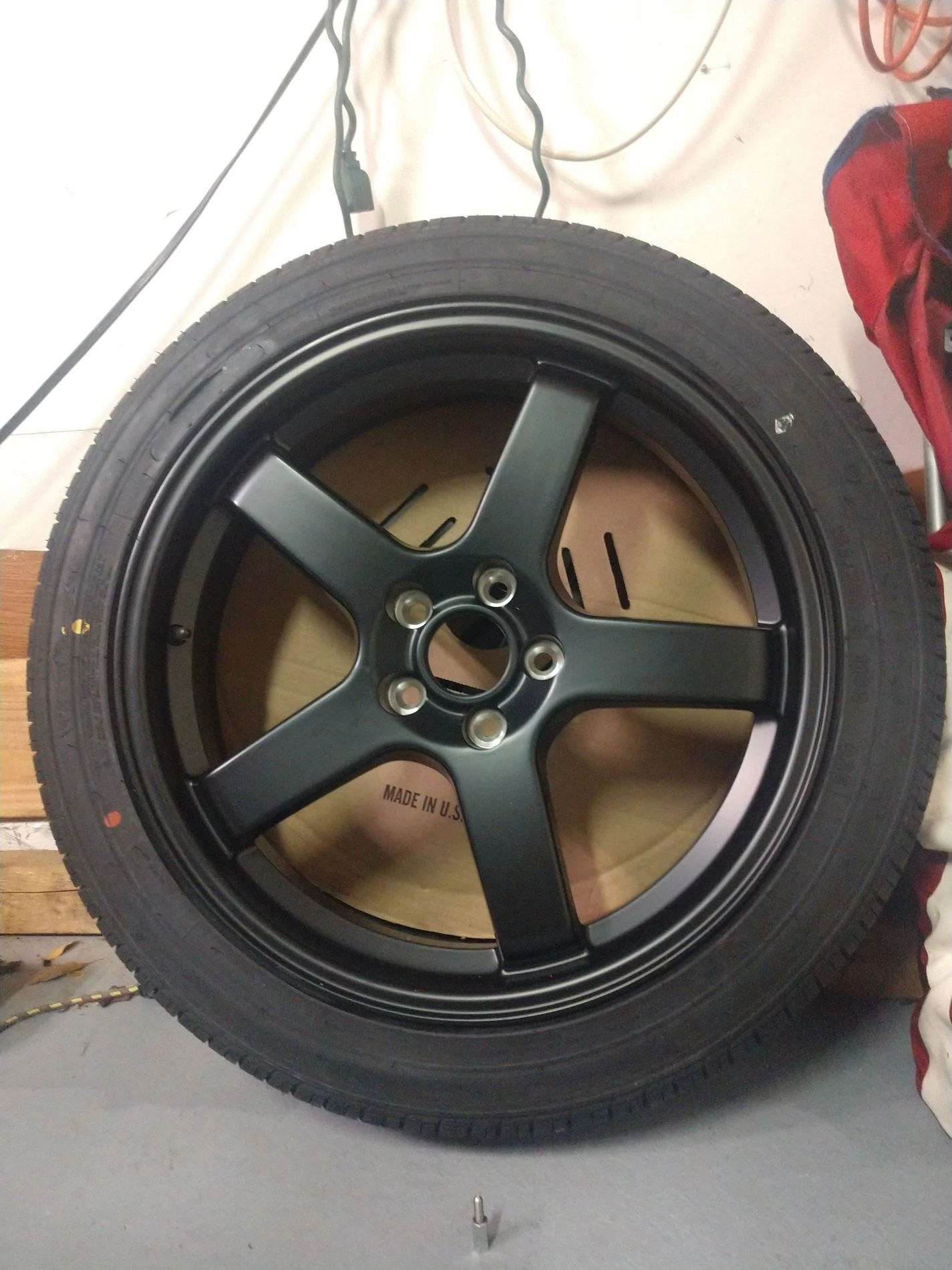

Got mine today. Quality piece! Not sure what the little silver valve thing is that came with it.
What is the tire brand/rating? Is it good up to 100mph?
I believe that is an extender for the treaded shaft that secures the wheel/repair kit.
A photo of the tire size would reveal the speed rating. It should read something similar to this: 195/60R16 91S, where the 'S' would be the speed rating (and the '91' the load rating). Then you just can google the speed rating :). Hope this helps.
