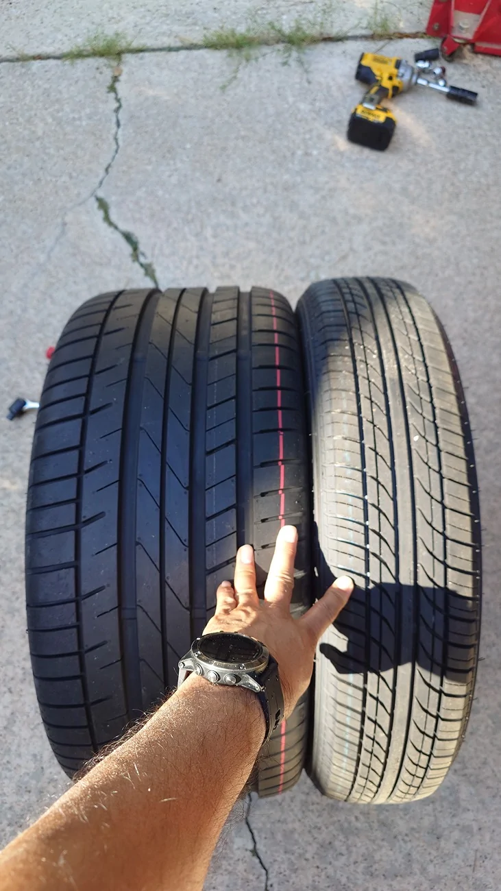

I have the Automotive Authority spare and had to use it two weekends ago. I got a big hole in the rear tire and no way to plug it up. I drive around with a small air compressor and plugs for quick fixes, but couldn't use it this time around. The car drove fine up to 80mph......I had to test it. Rear is 285/35/19.

I have the Automotive Authority spare in the well in the trunk. It's a bit snug, but does go in and will clear the larger brakes on the Bullitt and PP1.
