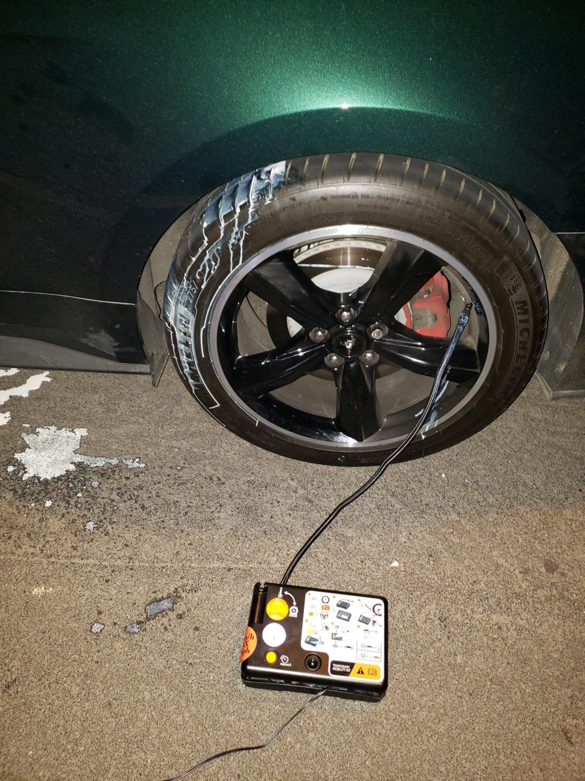

Wife picked up a metal shard in the rear left tire. As the air pressure dropped, the digital display automatically warned her the tire pressure was dropping. As she drove home, she watched as the tire pressure continued to drop, so she stopped so she wouldnt drive on the wheel.
We connected the mobilty kit to the tire and followed the unstructions. Didnt work well. White sealant all over the tire and ground. The kit is a mess. It did provide enough seal for me to get the car home as she was only two blocks away from the house when she stopped.
I too was worried I would have to throw away the tire after filling it with sealant. The tire shop plugged the hole and the tire is solid. After driving around the block, the tire sensor resest and everything is back to normal, no vibrations or sensor issues.
I will keep the mobility kit, it did fill the tire quick, even with air escaping. I will also be getting a spare tire kit. I wont trust the mobility kit to get my wife out of trouble if she gets a flat farther from the house in the middle of the night. I dont feel like paying a tow company to get the car everytime it gets a flat...
