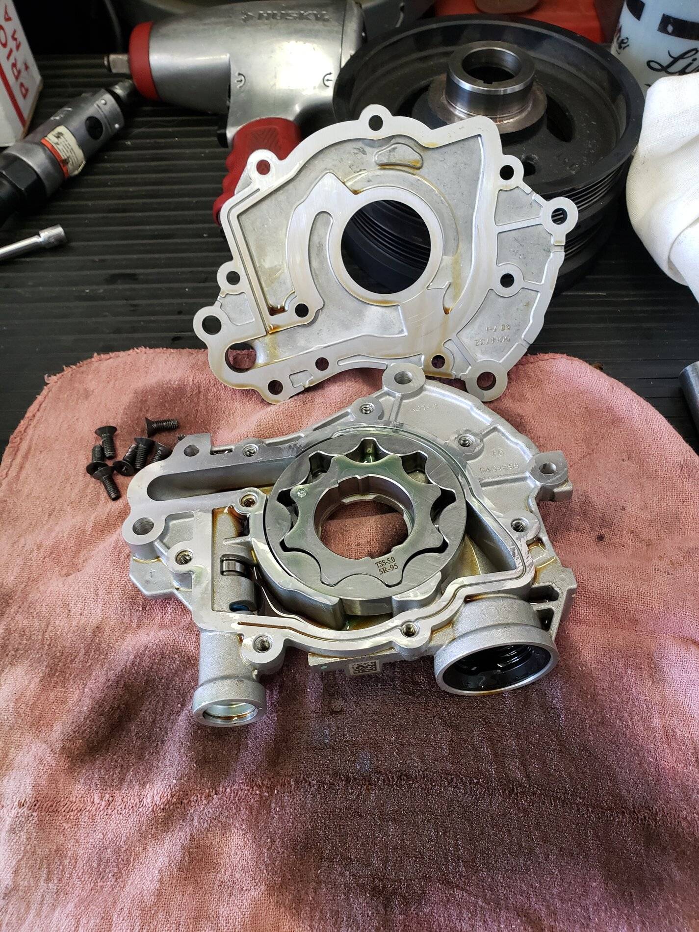

Here were the boundary gears out of my old engine. Currently running Ford Cobra Jet OPG.
Mine were headed that way, but i am a worry wort and caught it. I talked to TSS and they dont make their own gears and they are in Texas and Boundary is in Texas so not sure if they make TSS gears. Only so many companies make gears the rest just have them made. TSS wouldnt say who makes theirs but he said they are made to TSS specifications. FWIW my housing was in good shape when gears went in and i have had the oil analyzed before and all was perfect. Waiting for results from my current test.

what's the clearance tip/mound and shaft/ID on the Ford ones? How bad do those look when you pulled them off?
I changed these last winter so the originals are long gone. We get 10 months of winter here and 2 months of bad snowmobiling so i only put under 3k miles on last year.

Clearance is .004 to .007 according to Ford.
[/QUOT
Well thats one hell of a lot less than what i ended up with. and for the record i will know exactly when my neew pump gets here. most guys are measuring it right at .004
