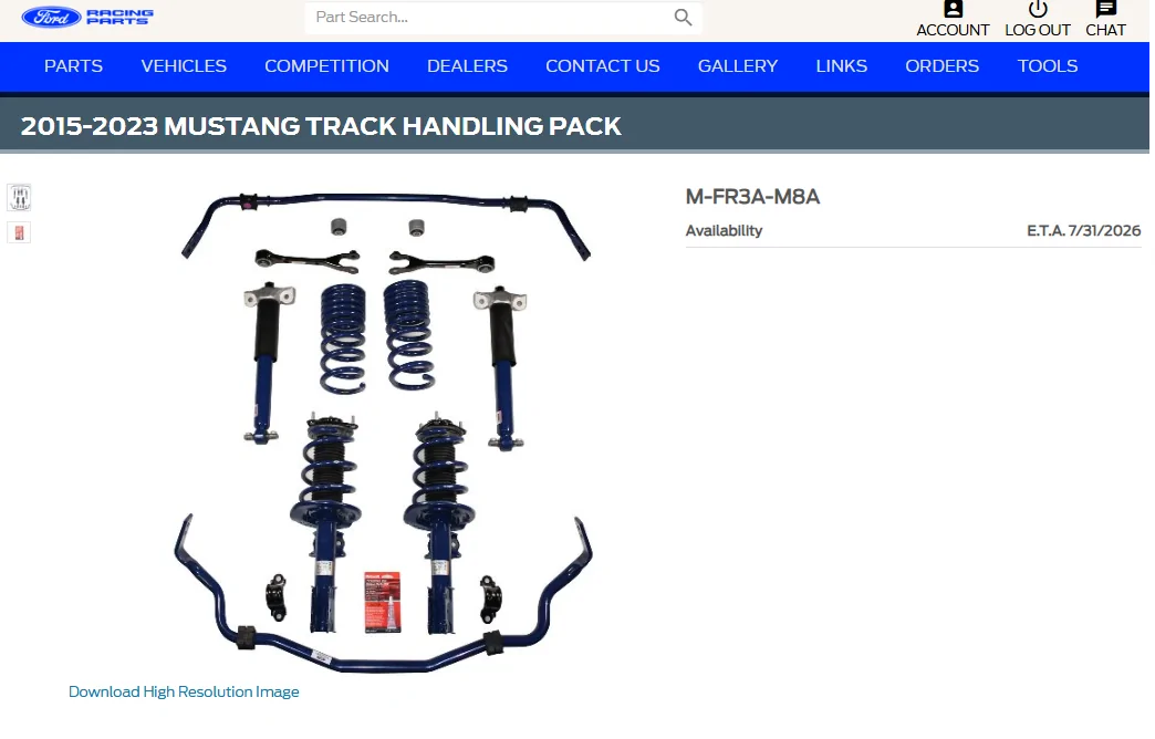

I actually placed an order with Levittown for the same reason, but they told me the same thing that I was on back order. I’m not sure what is going on with FP manufacturing. Had the same issue last year for their lowering springs.
FYI for all, unless a Vendor has it on their shelf, here is the Current ship to dealer date. This isn't written in stone and can move up or be pushed back.
