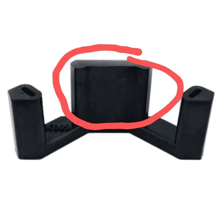

I tried drilling a hole in the transmission bushing insert, but the nvh was too much for me to handle for a daily driver, so I took the insert back out and completely removed the flat section at the bottom. The nvh was significantly better and I could still feel the positive results of stiffening up the trans bushing.
Gotcha, I'll have to pull the bushing out and see what you're referring to. I can't picture it.

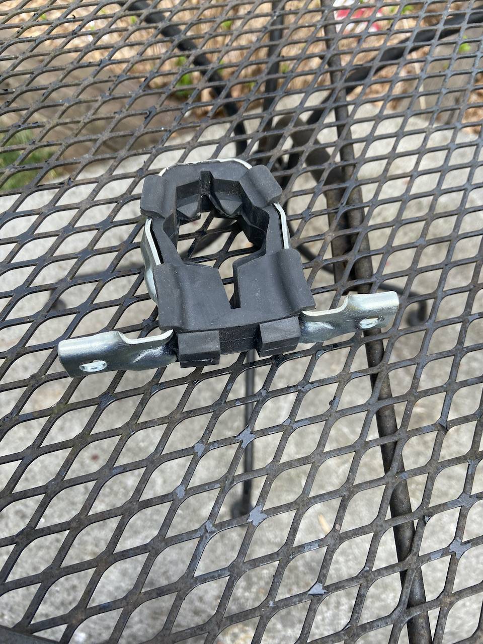

The post is just informational.

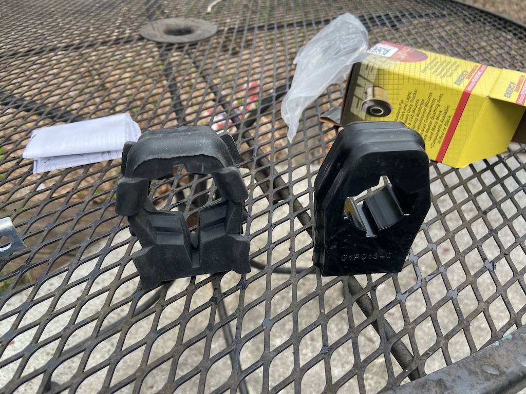

OP the PIA, removing the rear shifter clamp, is this. V
Just a view ..
Factory squishy, much to soft.
Side by side factory & Energy Suspension's replacement part: Hyperflex Polyurethane
Did it help yes, along with BG gear oil.
Just an over all FYI

I cut this part off completely.

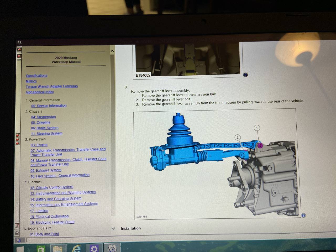

OP replacing this bushing, mark the trans to cross member position. With a sharpy, go around bolt position & how it sits on the cross member,
It is important that it be installed exactly as the was from the factory. The maintenance CD makes a point & stresses the importance of it.

@CanadaCalvin88, appreciate the visual as well. Didn't even occur to me that that could be cut off.
