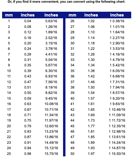

Any chance you know the torque of the 15mm (smaller) transmission mount bolts? The 18mm are 85 ft/lbs, obviously the 15mm bolts are less… I can’t find torque anywhere
Here you go learn by doing, start with a calculator, find 15mm .
looks like 1/2,
So 1/2 bolt torque, coarse thread 35, fine 40, easy as falling off a log. :champagne:

I appreciate the response, but have no idea what that chart means, how to read it, or what 1/2 bolt torque means…

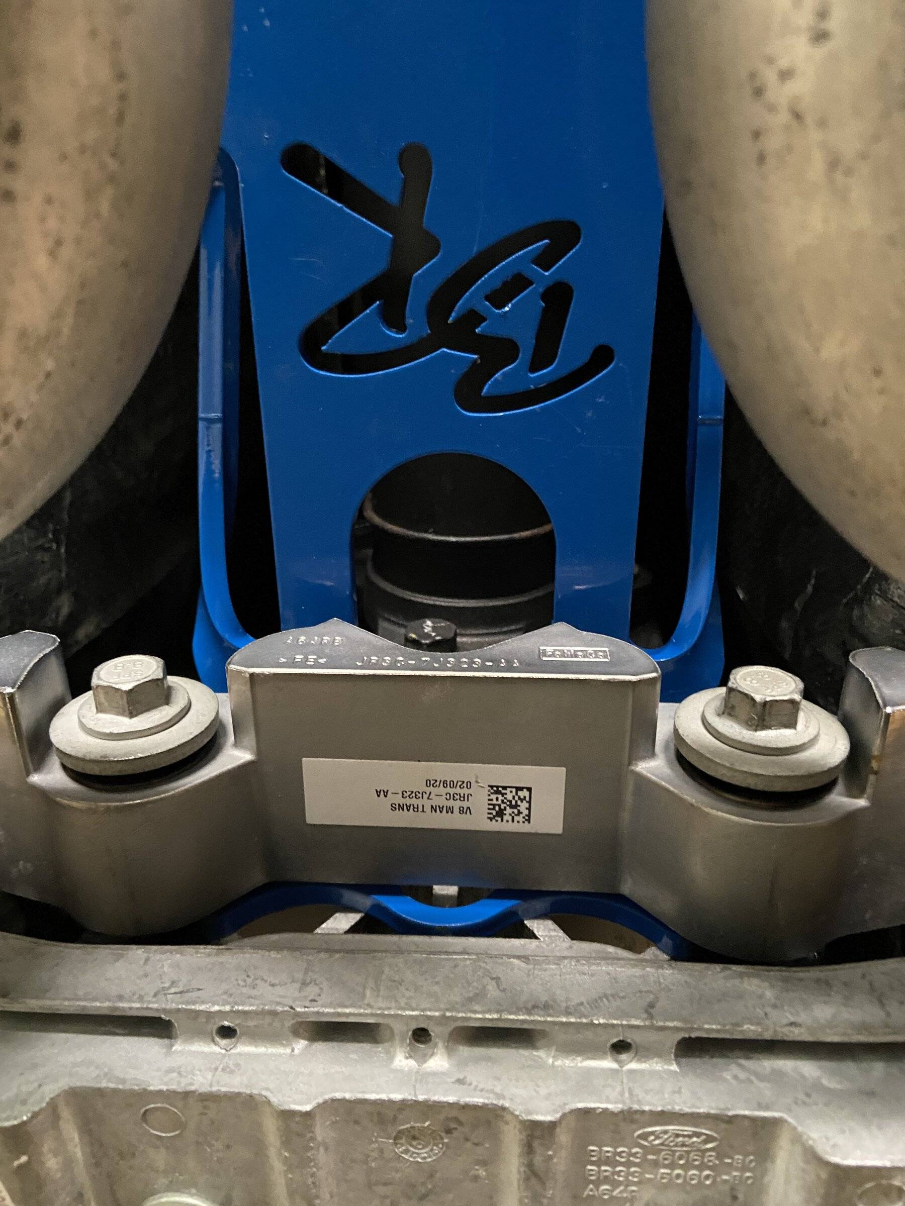

I just did this last Saturday, D4 version is a little bit confusing, I looked that thing over real good before diving in. The BF utube installation does not have that little goody.
2 outside bolts are removed, and that piece can be removed, and set aside.
The center bolt is NOT ...... The Center bolt is backed out just enough to allow BF keyhole to slip over and behind the bolt.
Then reinstall the damper & bolts, and 35lbs torque done.
The damper haveing long bolts, work those first, sung them up, then tight & torque the center bolt, following with the damper
Here is what it looks like, BTW that black bolt seen in the center is on the driveshaft.
