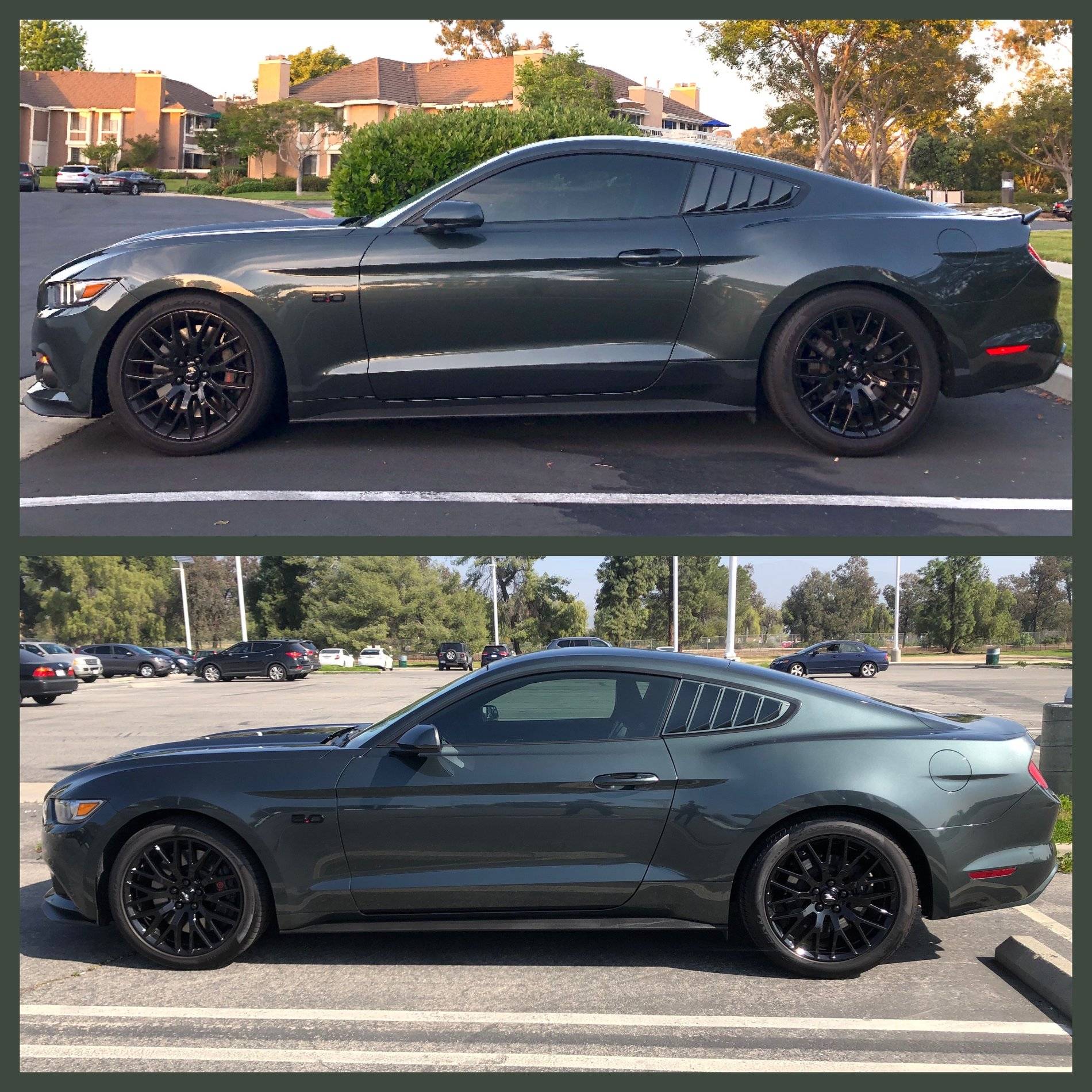

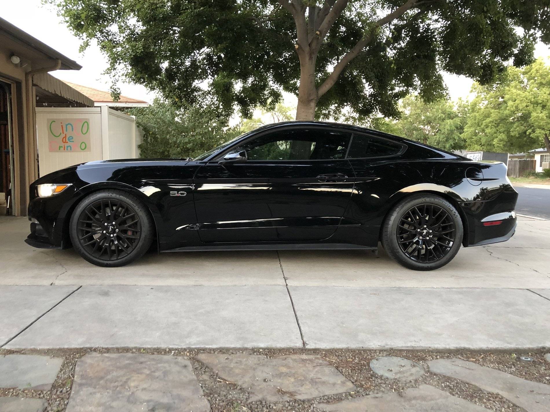

This is before and after Steeda Sport springs installation. This was with about 150 miles on the springs. I am very happy with the drop, ride, and the customer service Steeda provided. I’ve always been a fan of their products.
