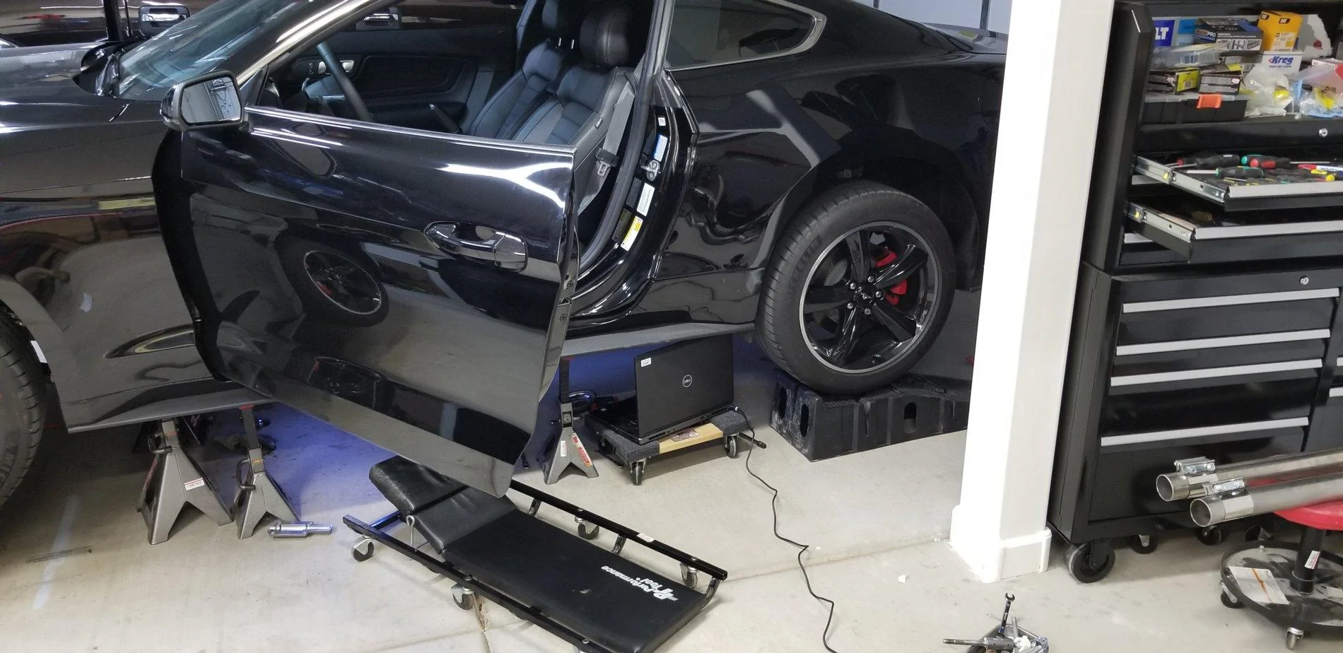

I would say that should not steer you away from tackling it yourself. I just did mine a few weekends ago and that was one of the easier parts of the install. None of the work under the car was very challenging. Getting the boot into the MGW once it is in the tunnel was the worst part IMO. Reusing my Bullitt shift ball turned into a huge debacle so I would suggest putting on an MGW ball. I did an H pipe at the same time so exhaust was out of the way but I left the driveshaft in.

It's really not that bad. I did it on my back in my garage on ramps. Long tube headers however, are a different story..
