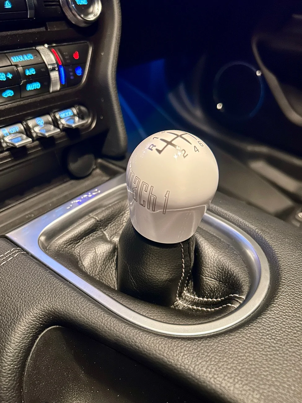

Yours seems to sit much lower, lower even than even mine does if I removed the adapter (black ring). I left the adapter since it looks nice. But I contacted mgw with the video, they said it's normal movement for the shifter on a coyote motor. Might do the steeda bracket insert that stiffens things up a bit. (Mgw already mounts to the trans so the blowfish from what I know is a waste of money/time).
Yeah I took the collar off. Hence why I wanted the tall teardrop. I did the short one at first and it looked ridiculous.

You are correct. I installed the MGW shifter for the Mach 1 and GT350’s with the Trenec 3160 trans. My car is a Mach 1. I’m aware that some of the comments were not germane to my specific application but they are interesting to read, nonetheless.
As an additional note on my install, I ended up changing out the shifter stem for a longer one MGW sell and replaced the cue ball knob with a slightly taller cylindrical one. This put the shift handle near the factory height but with a much improved shifter mechanism. The standard MGW shift knob height was a little too low for my preference. It is now perfect.
