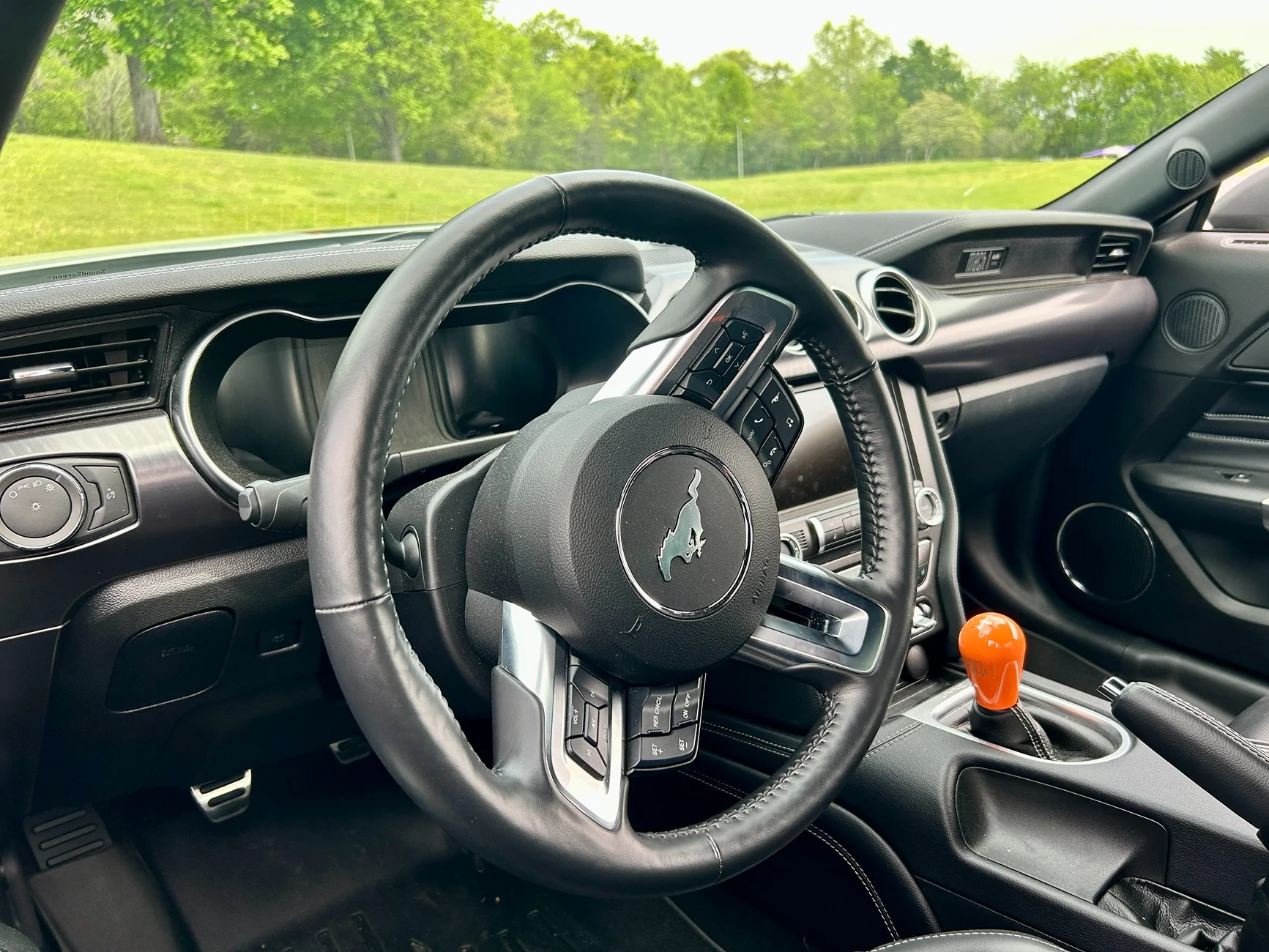

I have the same knob (albeit orange) and mine doesn't move like that. It does wiggle a little if I mat the throttle aggressively in first, but not a huge amount. I did get my local mechanic to install mine though.

Yours seems to sit much lower, lower even than even mine does if I removed the adapter (black ring). I left the adapter since it looks nice. But I contacted mgw with the video, they said it's normal movement for the shifter on a coyote motor. Might do the steeda bracket insert that stiffens things up a bit. (Mgw already mounts to the trans so the blowfish from what I know is a waste of money/time).
