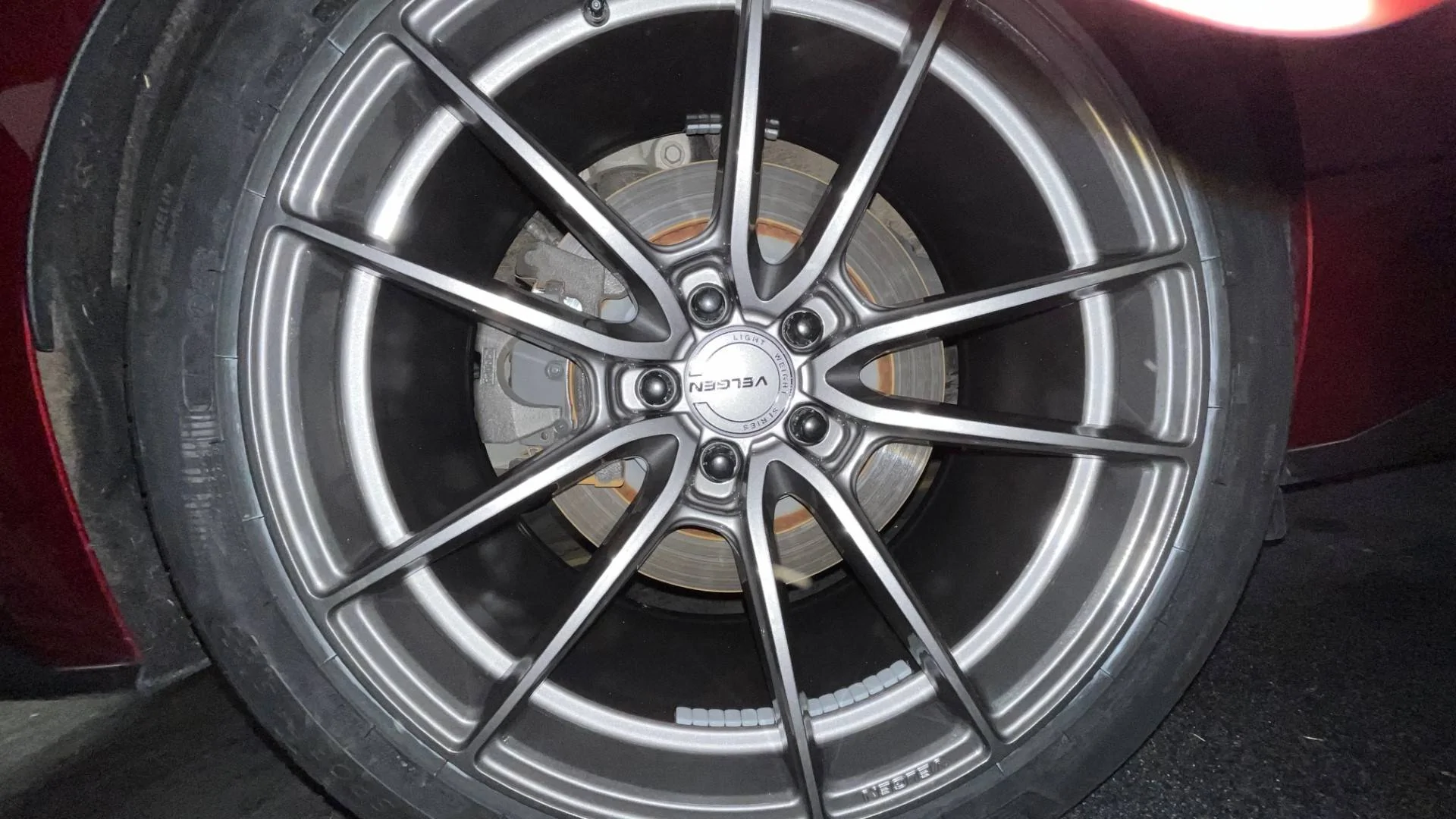

I have yet to find any kind of colored dots on my tires, Michelin PS4s. All wheels have 20 or more weights. Wheel in the picture below has 25, 7 on the inner wheel, 2 in the outer wheel (hidden on the picture) and the remaining on the outer wheel.
Total of 125g on this rear wheel, 20" Velgen VF5s

Take it to a shop that has a Hunter Road Force balancer and see if that makes a difference.

If they balance high they should have broken the bead and rotated the tire a 1/4 turn until the weight comes down.
Some balancers detect the high spot and tell the operator how much to rotate the tire for optimal balance.
Significant weight is lazy at best, incompetence is more likely. Take them to another shop.

I work on cars for a living and in 18 years of turning wrenches I've never had to put anywhere near 125grams of weight on a new tire and a new rim. (Unless there like 37s on a Jeep) What are the last 4 digits of the DOT #s on your tires? I suspect high road force on your tires. I just mounted new 6GR 19x10 up front and 19x 11 at the rear on my car. I reused the front tires and the driver left front wheel didn't even need any wheel weights ( happens 1 in 100 tires if your lucky lol)
