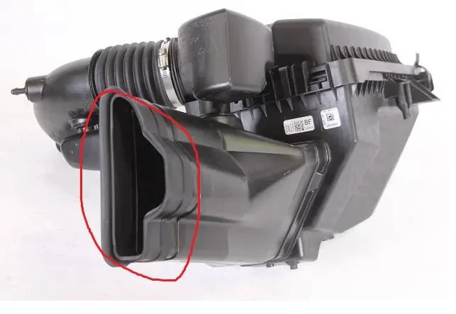

What intake are you running? I had this same issue on my 2011 with a Roush 2.3 and JLT CAI. Very simple fix for me, I would get the same surge when coasting on the highway, we found out it was the factory air box, well the bottom portion anyways, there is a rectangle tube that serves as a sort of ram air, with the JLT it would surge because of the amount of air coming in. JLT made a sponge baffle to reduce the amount of air coming in.... worked like a charm. You could stuff a rag in there and see if it works, that's what I did to identify it.
Yup, JLT cai... I also gutted my grille, so a good amount of air comes in.
Do you have a pic to show what you mean?

Stuff a rag in the end that slips in to the circled end.
