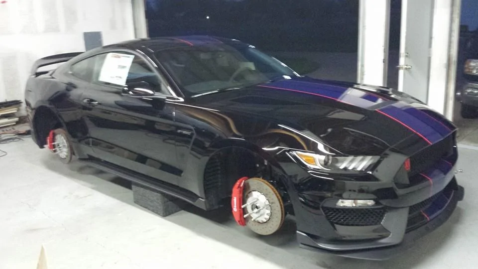

makes me nervous

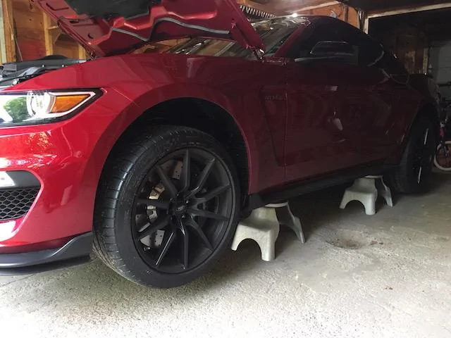

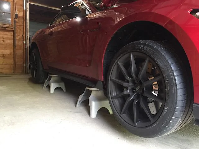

I posted this in an oil change thread, but I'll put it here as well to show another option.
http://www.jackpointjackstands.com
They are very strong and therefore are also pretty heavy and not adjustable. But, they are very stable and easy to use.

Why did you take someone else's picture, make it B&W and post it as your own?

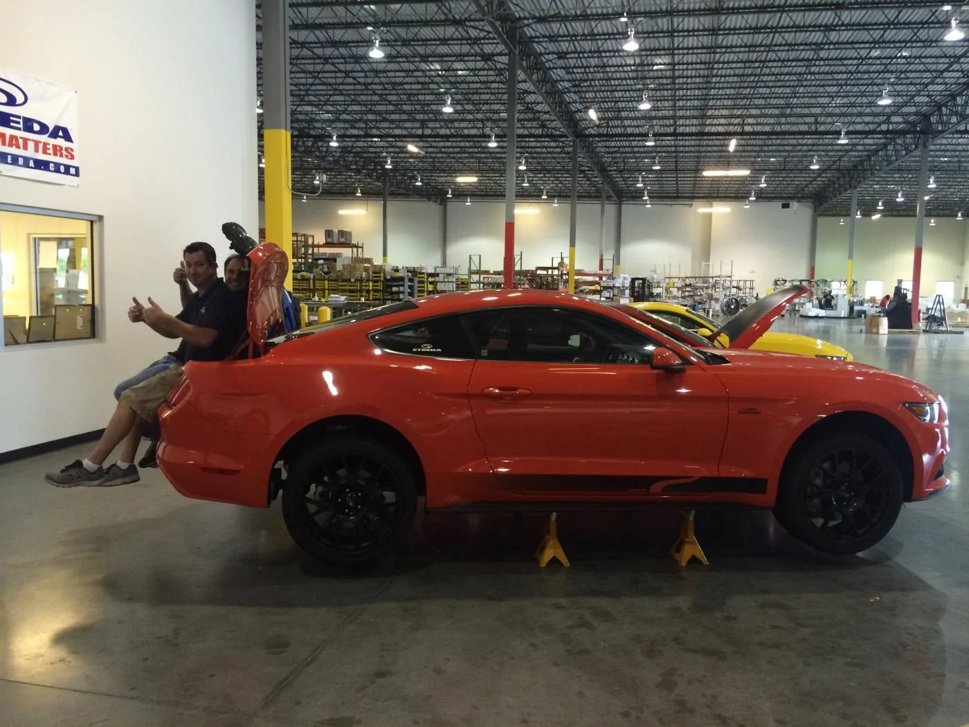

Here is a pic of what I was referring to above. Couldn't find the GT350 pic anymore, but similar jack stand placement here.
I never said it was mine! I just said it made me nervous, I cropped it and B&W so not be critical of anyone.
So if I offended sorry not my intention. It just reminded me of when I was kid in truck stop and I put vehicle up like that. I was told the story about the guy working under the car on his creeper. He had a stuck bolt and couldn't get a good pull and asked a helper to hold his feet. The helper had nightmares about holding his feet.

Comment on guys in trunk, the closer the jacks are together the easier to spin the car off the jacks. I just always put some thing down there with me like a tire on rim, A scissor jack up loose. Especially when I'm under my 7.3 diesel, that make the jacks groan.
