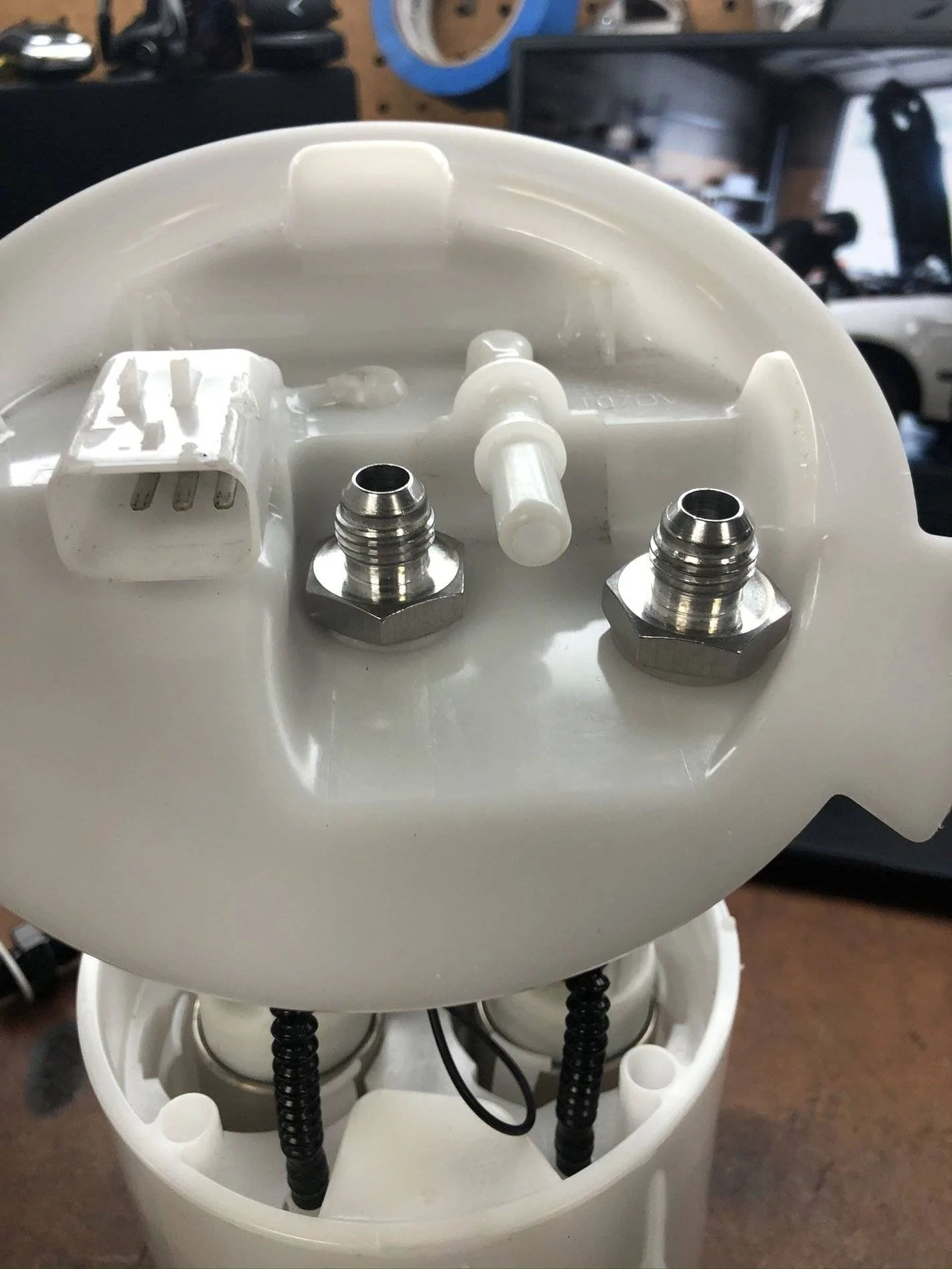

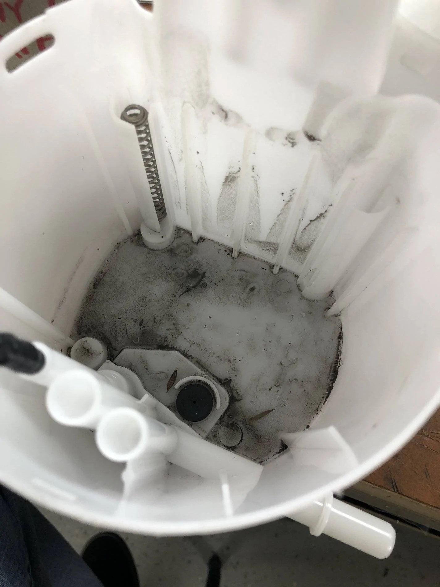

I bought a used Sai Li that I was in the process of converting to twin DW400’s so I took the basket apart and this is what I found. It wouldn't hurt to clean occasionally I’m guessing.

Thats all the stuff that did NOT make it into the fuel system, so that gunk was sitting at the bottom. Anything that made it past the fuel pump sock will have already passed through your lines and your injectors or returned back into the bucket via the return hose. Cleaning that bottom of the bucket will do you no good...

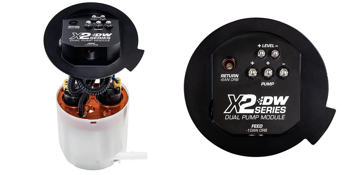

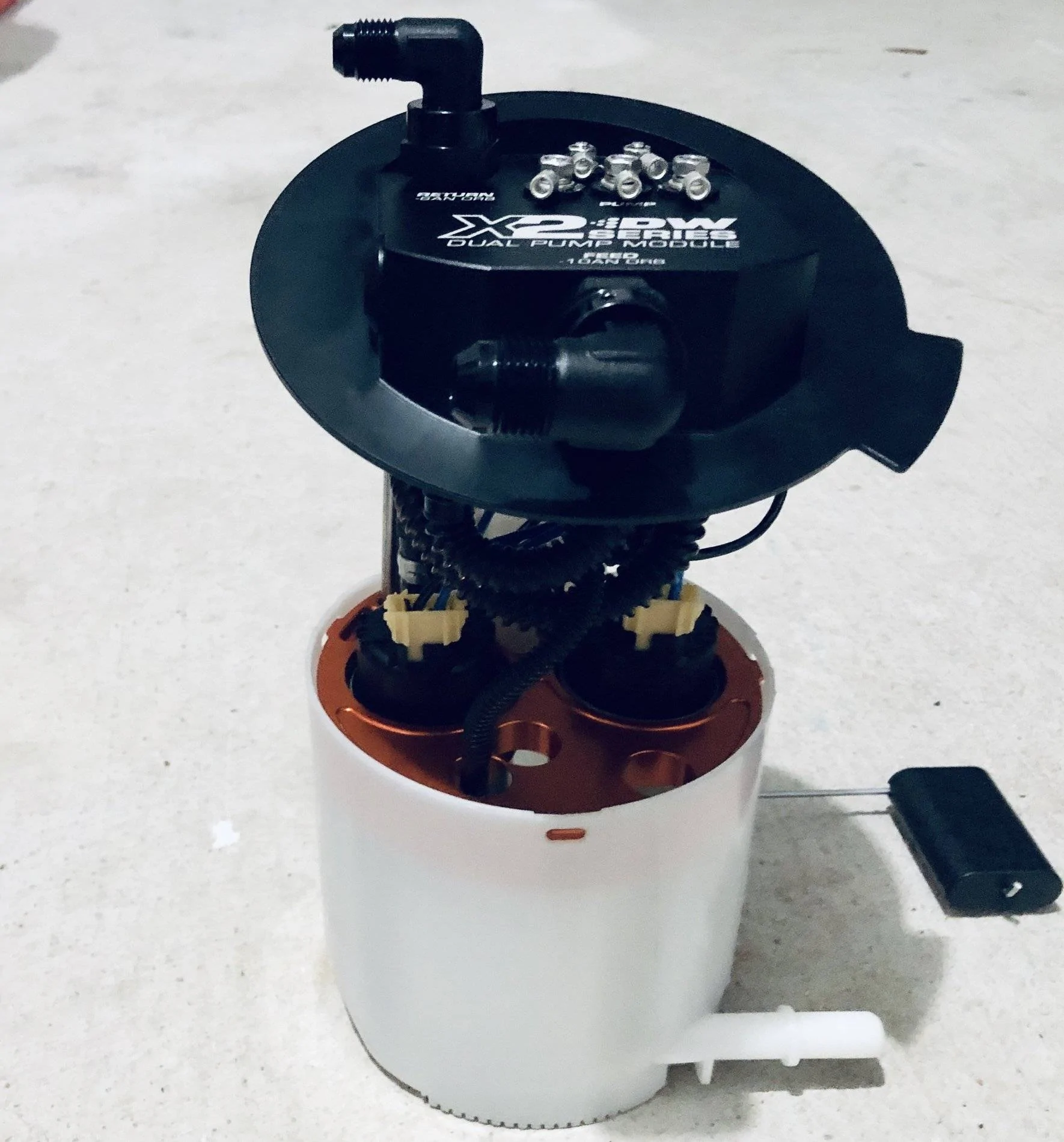

I never installed the assembly in my car, just found the gunk disassembling it for the twin DW400's. I ended up just getting the DW X2 hat which I am in the process of installing the 400's in and wrapping up my fuel system. Just have to figure out the front passenger side connection at the Edelbrock rail to get around the Heater Core metal inlet tube/hose (Supertight fit).
