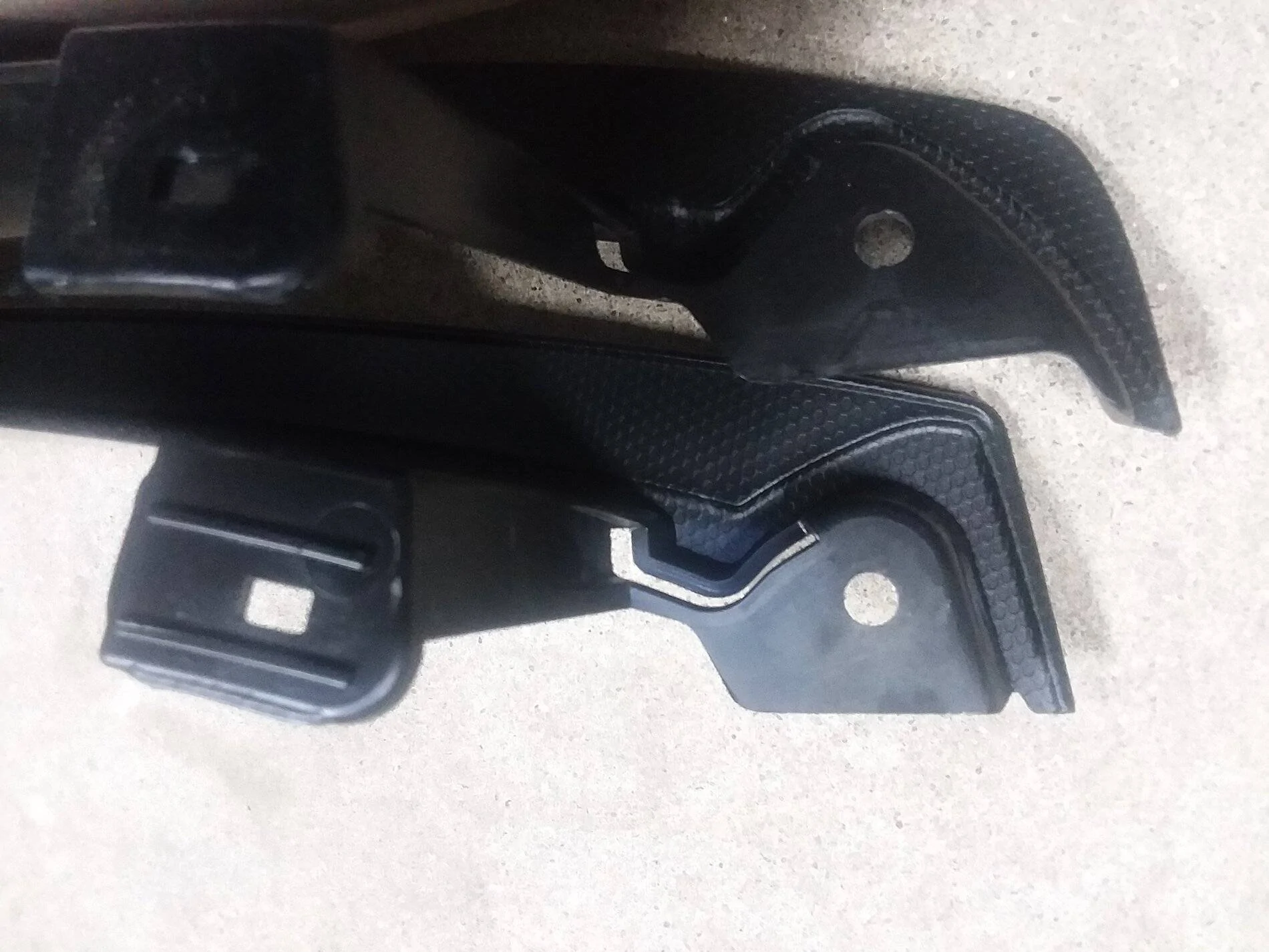

THOSE REAR ROCK GAURDS ARE WRONG.
From appearance they appear right, but the grooved contour in the plastic is wrong, and does not mesh into the bottom valance/diffuser on the rear bumper.
Please remove them from list
Thanks for confirmation. Removed
