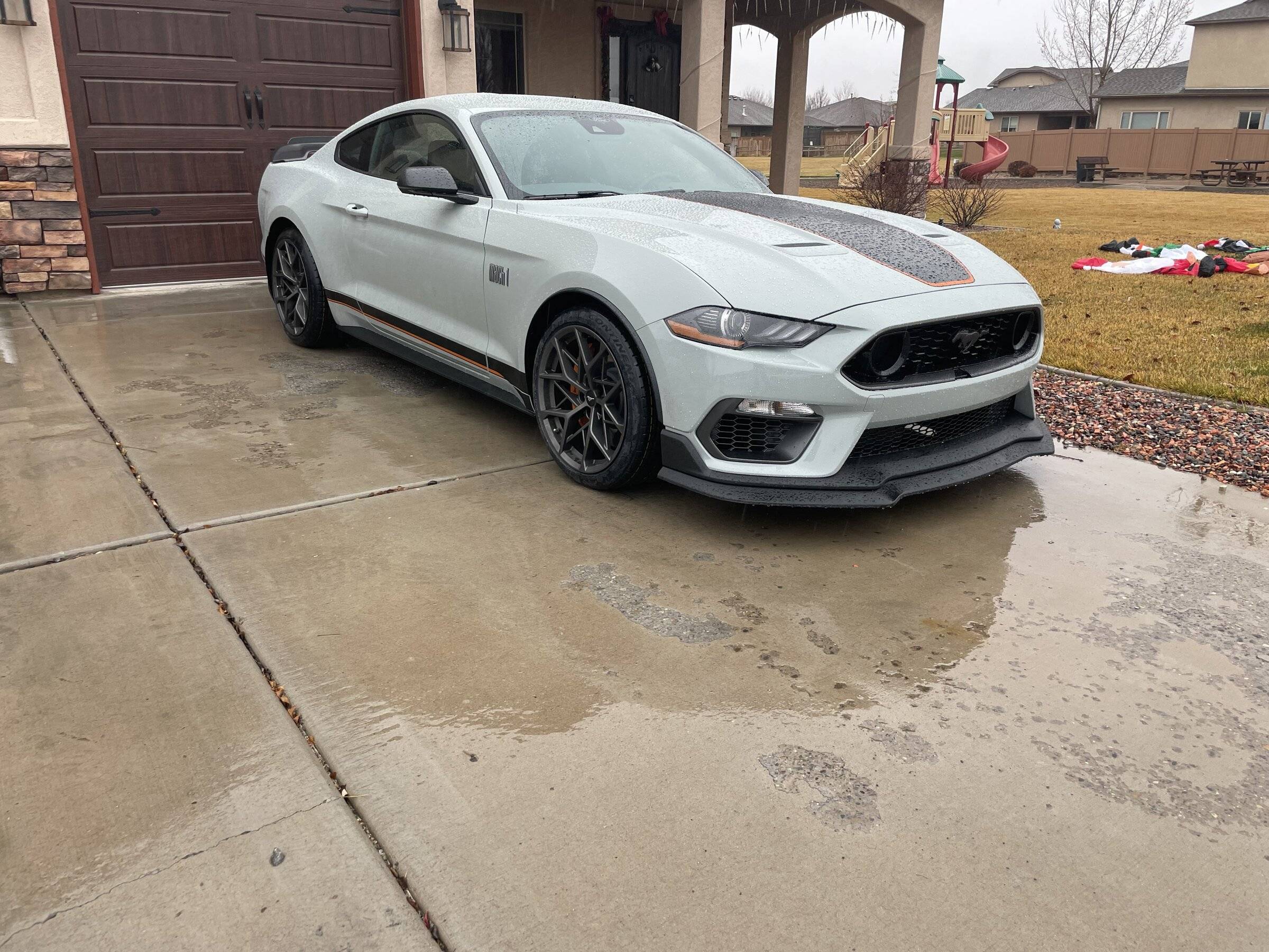

Hey all. Just got my Mach 1 HP delivered about a week ago. Stumbled onto this forum looking to see what everyone else is doing with them. Love all the ideas and reviews ya'll are putting out there. Aside from waiting on some parts to show up (rail road cracked the front fascia pony grill molding during transit) all I've done is switched out the tires to some all season continentals. Don't yell at me. I love to drive her daily, and I don't want to just run through rubber every 2-4k mi. Plus since it's now winter in Colorado figure it wouldn't hurt to get something better for the colder/wet weather. So far mod plans are just cosmetic, but who knows... that whipple stage 1 does sound like fun. Anywho, here's Mara.
Edit: for those following, I’m using this as my build thread to help keep track of things. Enjoy!

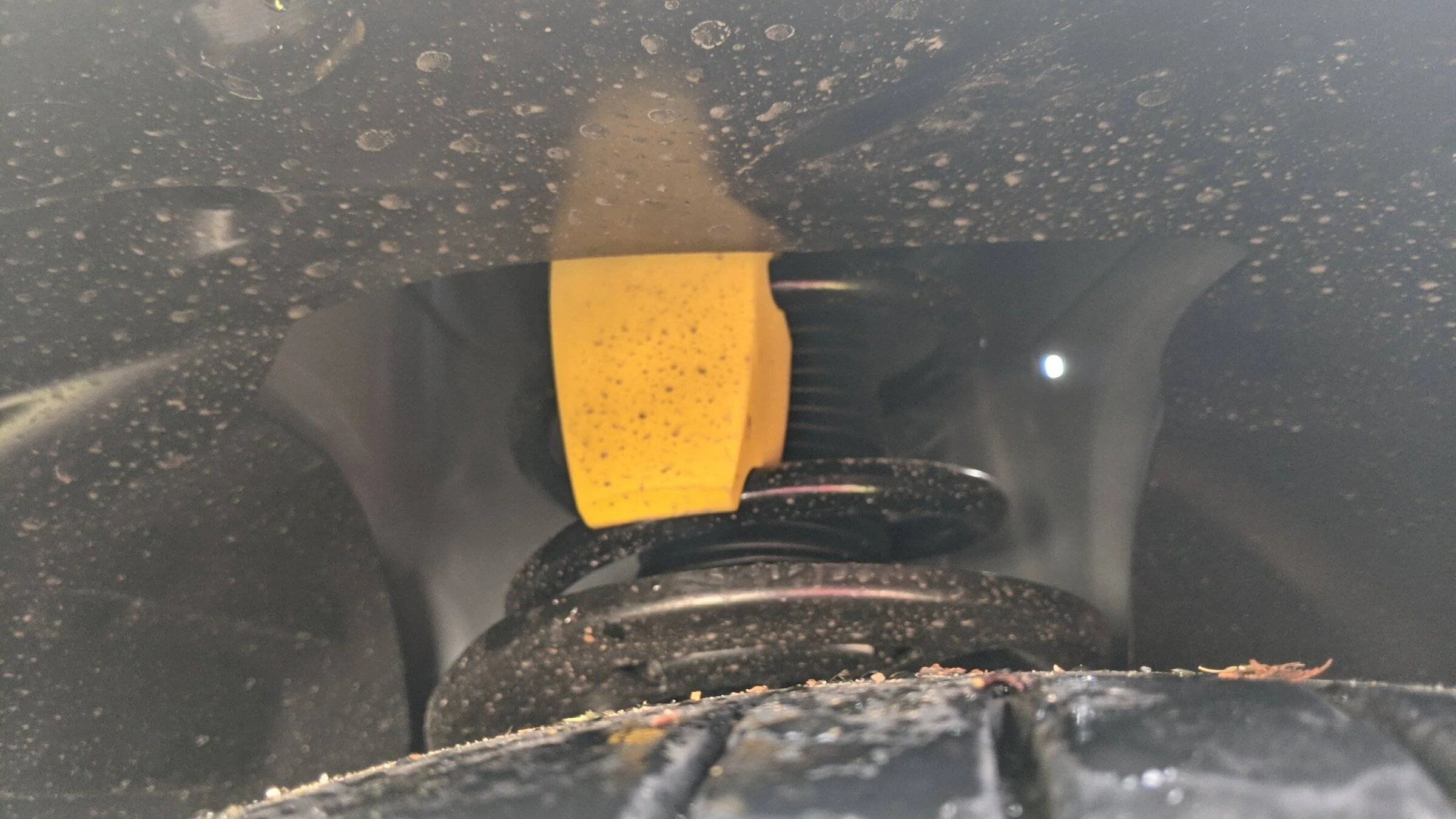

Welcome. What's your chassis number? Be sure to check that the yellow shipping blocks were removed from the springs. Since you've already changed tires, tire pressures should be right.

First I've seen of the shipping blocks. I did not check this when I took delivery. What am I looking for? Noticed my tire pressures are super high at the moment. I think they're at 40 cold. Also, one weird thing I noticed when I took delivery that I've never heard of anywhere else. The clutch pedal was very tight to the floor, like only an inch or so travel. I thought it was odd and drove home like that, but actually enjoyed the short press. Then I noticed rev matching wasn't functioning, so I assumed something was up with the clutch sensor not working properly. Ended up lifting the clutch pedal with my foot and it seems normal now. Huge clutch travel, which I don't love, but everything functioning normally. Didn't know that you needed to do that after delivery (the pedal lift).

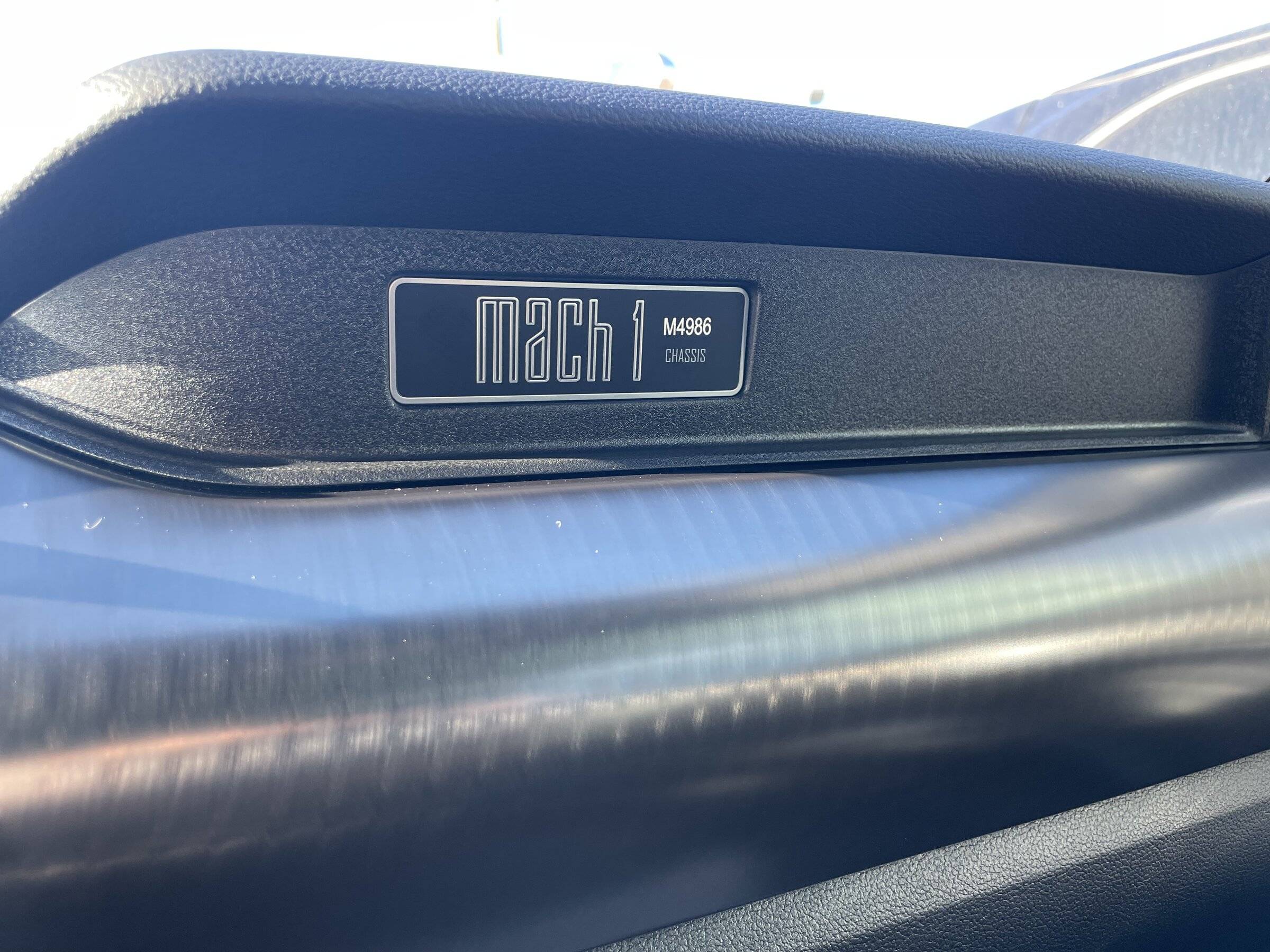

Highest chassis number I've seen so far.
Mine is in the 50XX's, will post when I get back to it later.

Look at the springs over the wheel (you don't need to lift the car.) The blocks are bright yellow.
The tire pressures are set high for shipping. The dealer should have corrected them as part of their delivery prep but that often has been missed.
