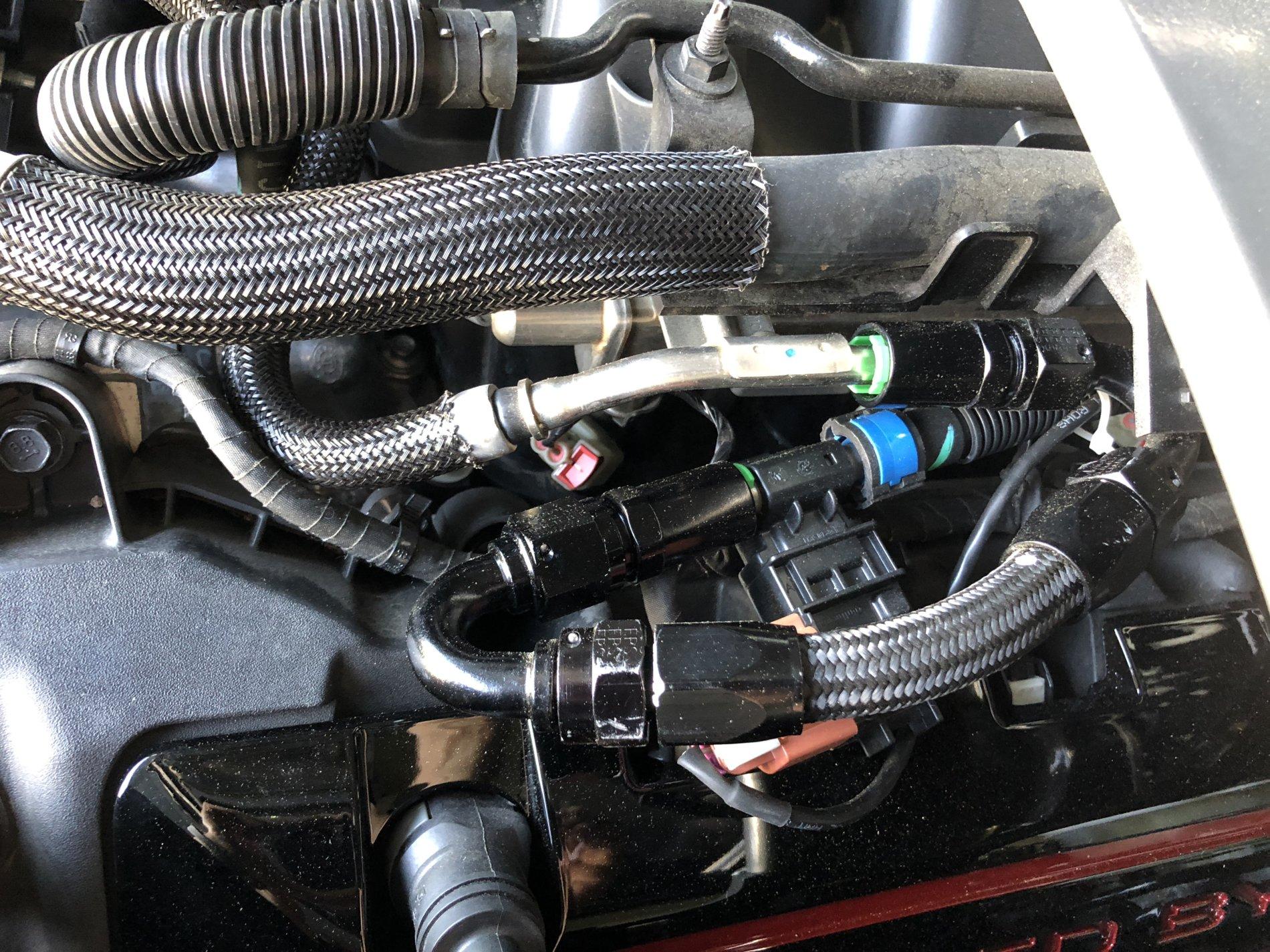

Hi - what sensor are you running, and do you recommend it?
I am running one from innovate motorsports. I mounted it inline. Where the factory flexible line connects to the factory hard line going to the injectors. I made up connections using Fragola fittings and fuel line. They make adapters to go from the OEM fuel line connection to AN style fittings used for the added line section. I can return to stock setup just by unplugging the sensor and adapter.
What are you using for a fuel content analyzer? Did you buy the whole kit and stash the Innovate gauge somewhere? The ngauge has an analog 0-5V input and the sensor itself does not output this as I understand it.
I am eyeballing something like this. A little pricier but it comes with everything - connections/hose included. https://www.fuel-it.com/ford-mustang-5-0-flex-fuel-kits/

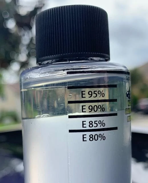

Made the swap to E85 this morning. It was kind of strange sitting at the gas pump for 20 minutes while I swapped the tune, filled the tank, and then idled forever.
The gas quality looks decent! The log took forever to adjust, and finally decided on 71.8% alcohol - probably close considering the residual 93 in the tank.
