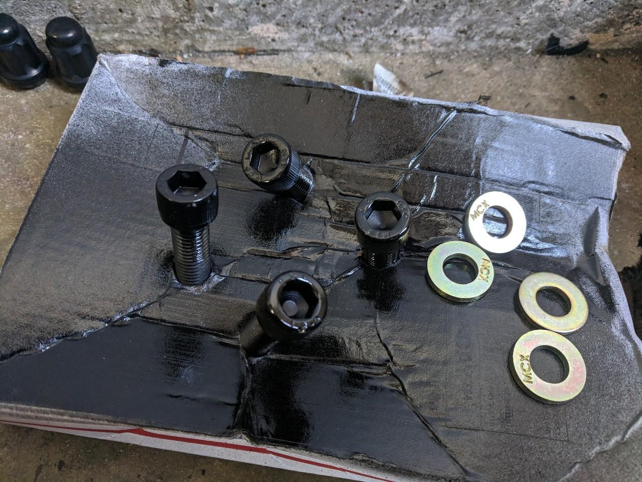

Spray cans will always be with me. I even paint my new bolts for the parts that I am installing.

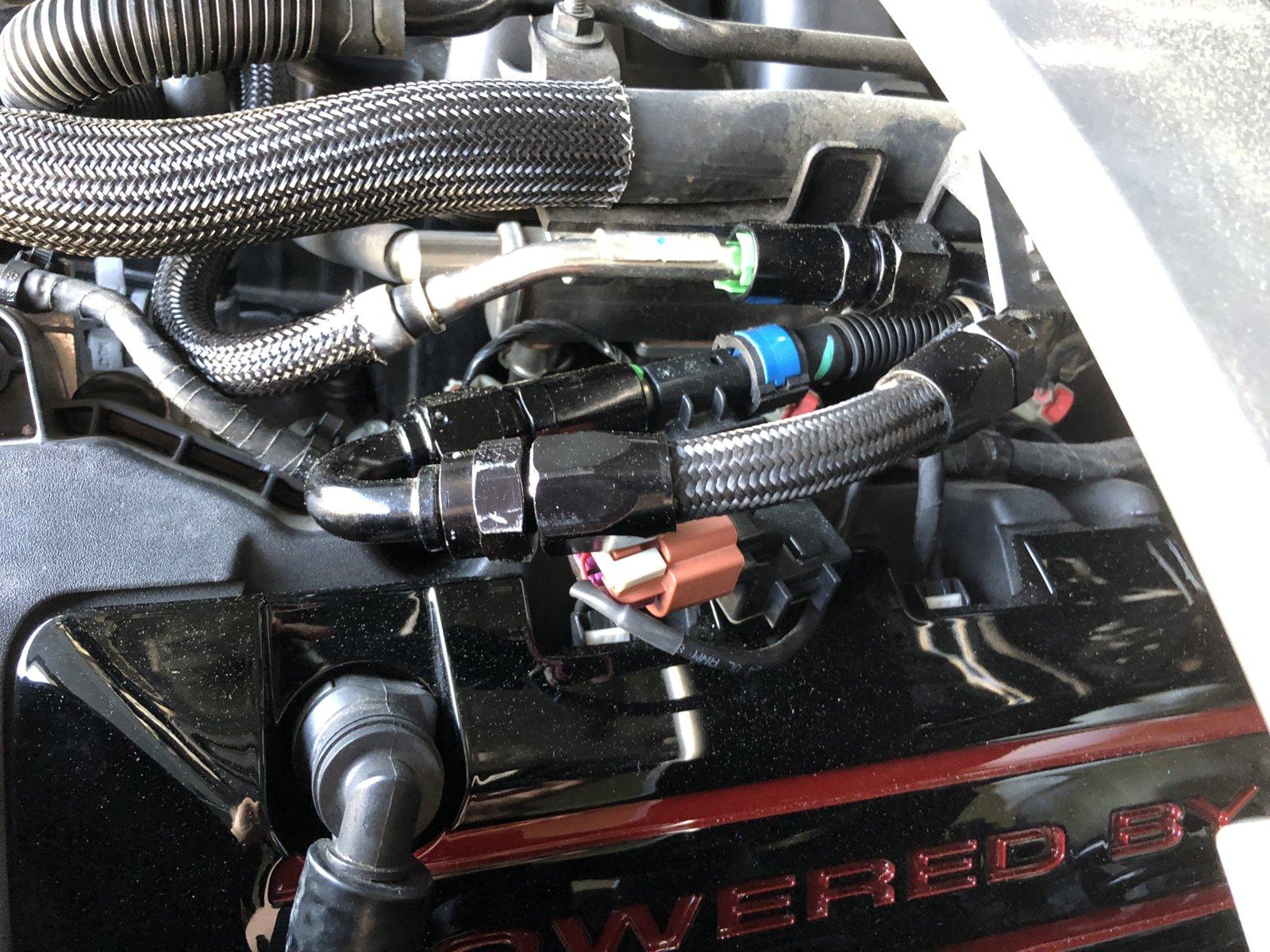

I’ve been Lund tuned for E85 since March of this year. Thousands of miles later and multiple track days without issue. Rock solid tunes. No issues at all. I run the flex tune for transition out of 93 octane and into E85 when I have a blend. Once I’m clear of the 93 I switch over to the E85R tune which is more aggressive but needs to be at 80% E85 or better. I installed a ethanol sensor inline to monitor Ethanol percentage and that gets fed back to the ngauge.
