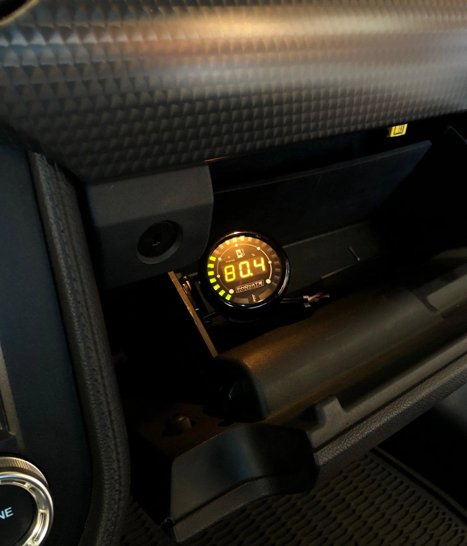

As others have said before E70 is fine to run the tune on. I'm also on Lund and added a inline sensor and gauge like you suggested. My gauge is in the glove compartment as I only really need to see it after filling up and it also monitors fuel temp.

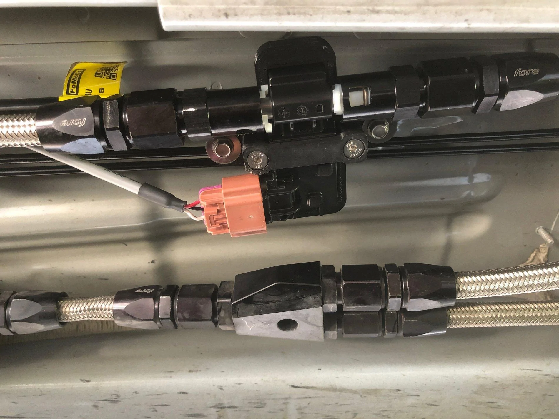

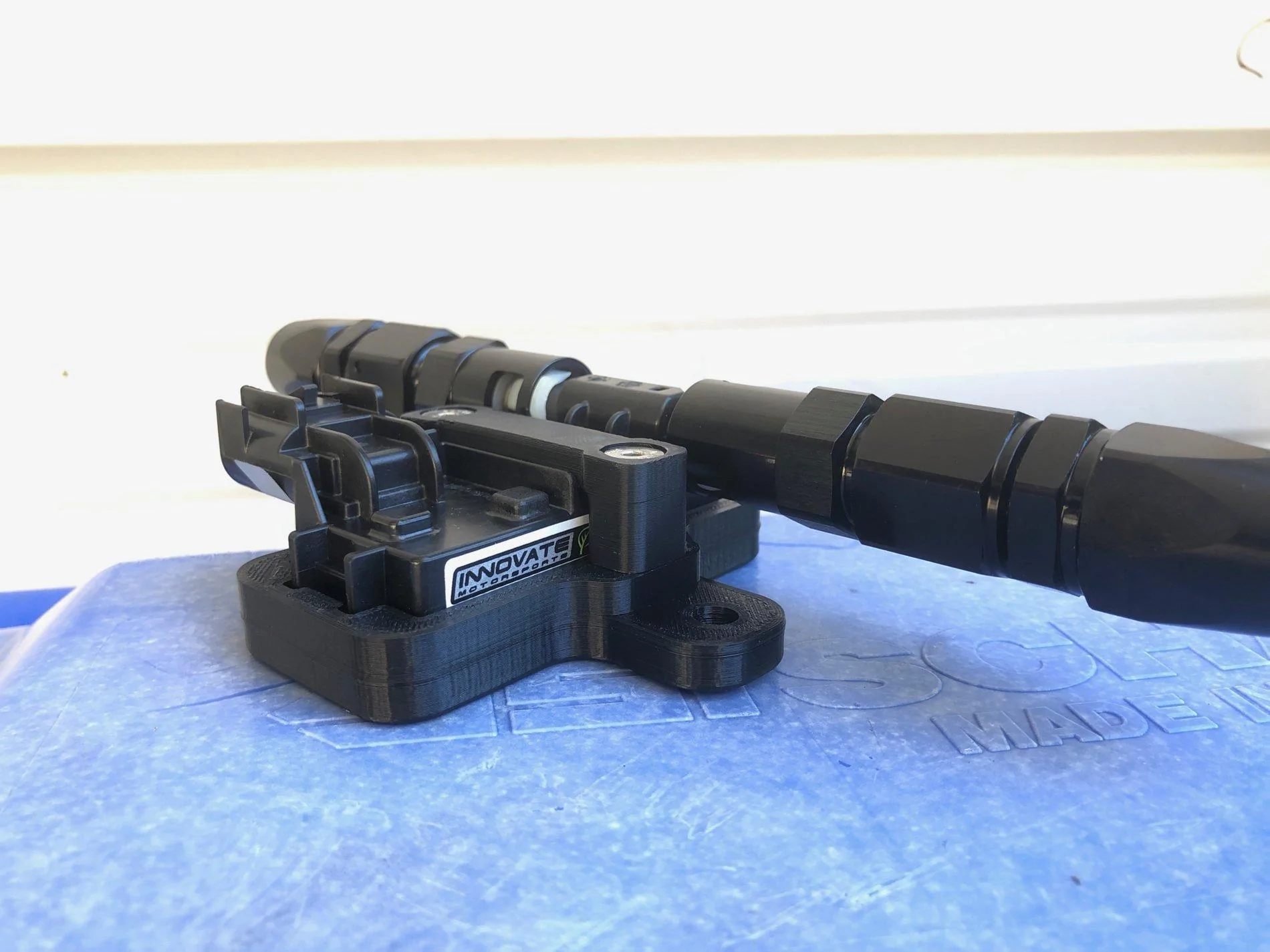

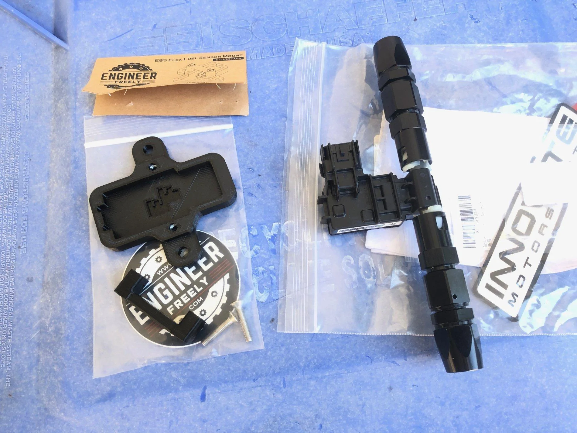

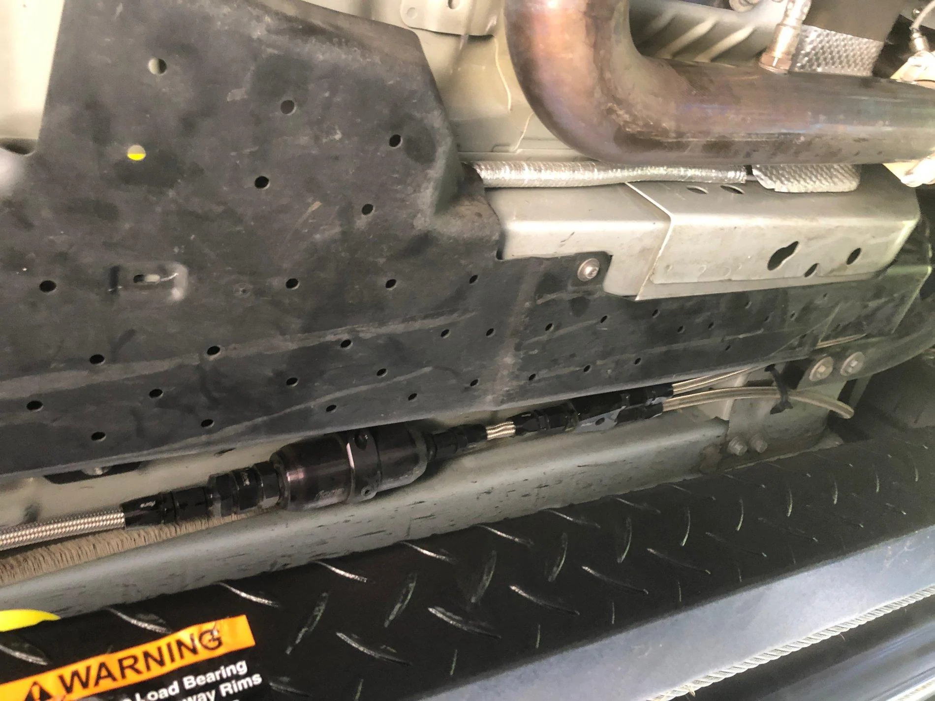

Looks like this one. My question is what was involved for the install and where did you plumb in the sensor?
I plumbed the sensor into the return line which is the recommended way. Here is a pic of it mounted but it can't be seen normally as its under the stock fuel line cover. Once it's mounted, run the cable the safest route into the cab via the firewall and over to where you want to mount your gauge. I ran the cable through the stock heat shield tube and behind the stock heat shield plate; you can just see the gray cable in the gap between the two.
