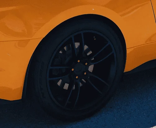

It's a steel lug with like an aluminum cosmetic cap, and it's the latter than gets easily deformed. I look at it this way, a set of much better lugs is cheap, plus you can do something aesthetically different, like black, or a really wild color - heck, I'm running Monster opened ended that allow the use of little screw in end caps in different colors, looks pretty cool:

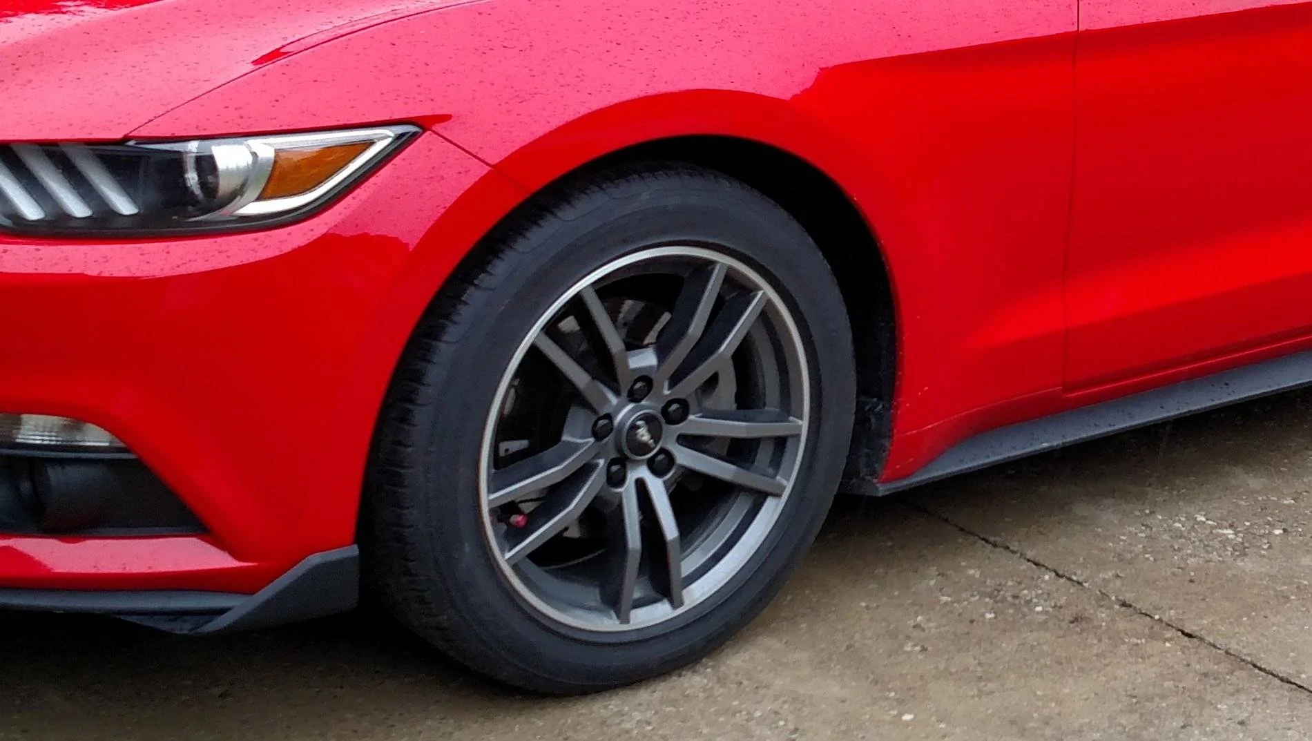

I've been looking for replacement lug nuts that match my factory wheels. The only choices I've seen are either chrome or black. Chrome is much shinier than the original ones so don't match my wheels. Anyone know of any other options?
