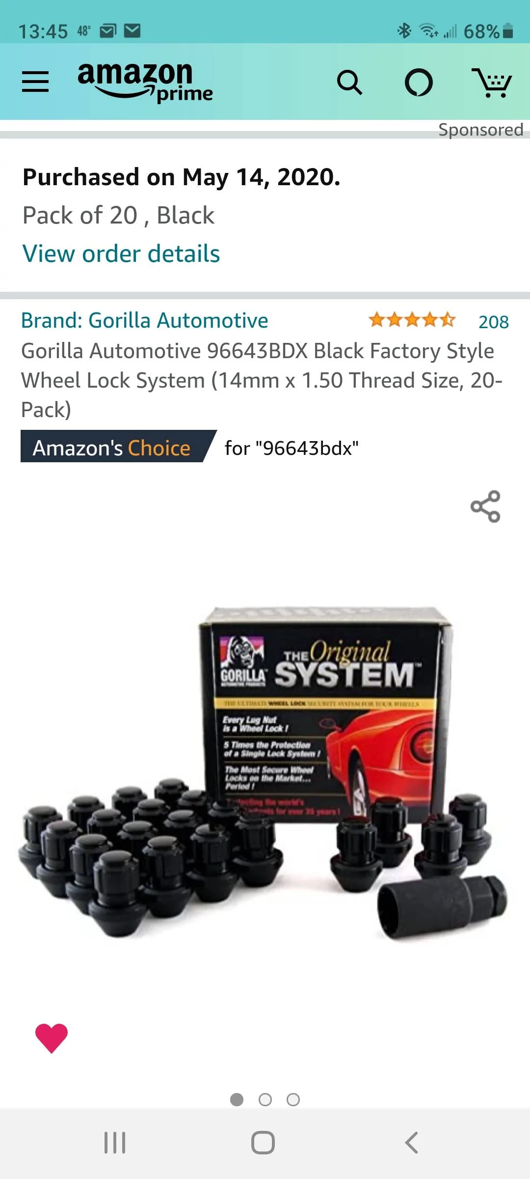

I replaced the ones on the Mustang with these. They provide a little bit of of theft protection and they look good. The others got basic solid chrome plated lugs.
I switched to these when I went to Forged rims on the Mustang (stockers are too big), but I also replaced the stock RS lugs because they went to shit as well.
