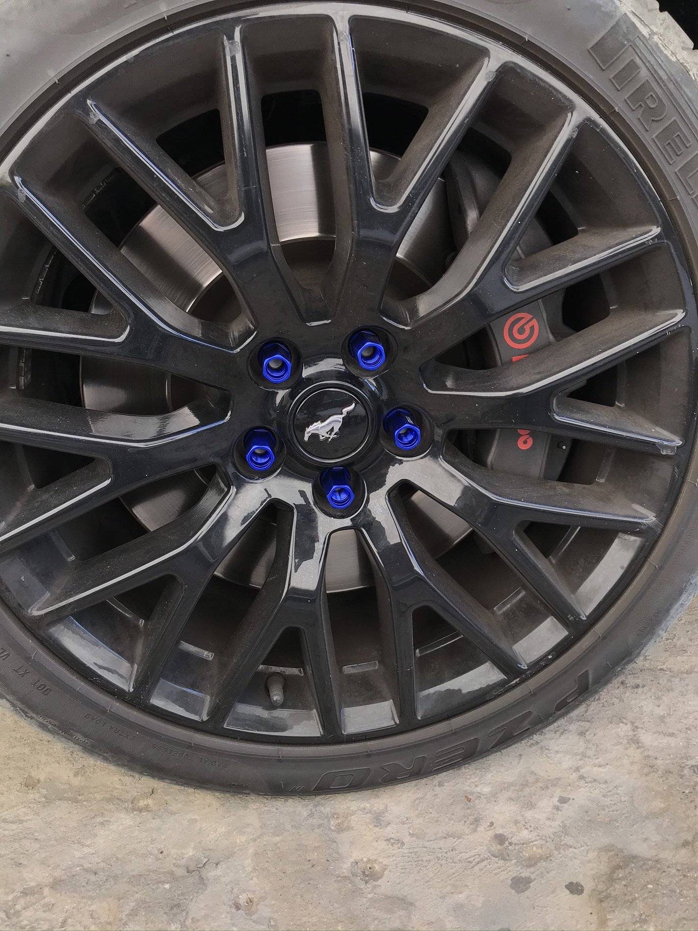

Hey everyone

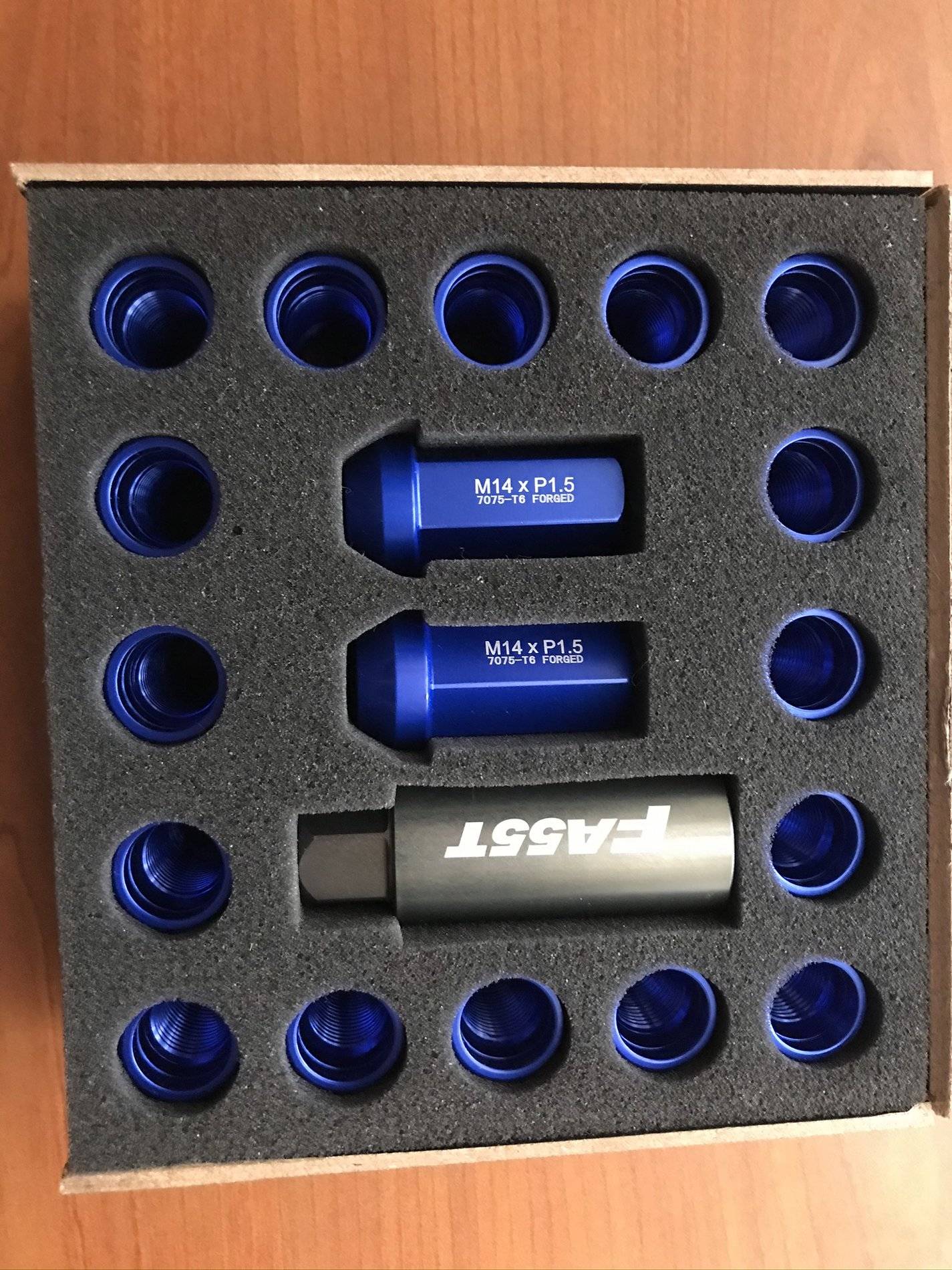

I bought FA55T forged lug nut
And they look awesome and came with their own socket
But they are so light compared to the original ones
I’ve used them for a week and so far no problems but they are really light and can’t get the idea out of my head that they might break
Any thoughts about them?

Forged - aluminum, that's why they're so light. Normally lug nuts are steel.
Yeah, I'd prefer steel lug nuts, as I've seen aluminum ones let go (but to be fair, they didn't have the need thread engagement, and the driver kinda knew that)... so ya, avoid using spacers with those.

There's no freaking way I'd trust anything other than steel for lug nuts on an almost 2-ton car calling for 150 ft/lbs of torque, especially if pushing the g limits. I've read of too many folks losing wheels with both Ti and Al lug nuts, with very expensive results. Similarly, I wouldn't use CF wheels either, but to each his own, I guess.

Were you even able to torque those to 150 ft lbs?
The bigger question everyone should be asking is the use of dissimilar metals - aluminum lugs on steel studs... rain water or in geographic locations with winter seasons and salted roads, I expect those lugs to eventually weld themselves to the rims....
Me personally, I’d never use aluminum lugs, period.

If considering tire rotation happens with oil changes or @ 5k. not a big deal. Conditions mentioned could subject or cause the threads too galling.
I think torque value and the ability for a threaded aluminum nut. To be torque to 150 ft lbs is a much bigger concern.
Familiar with 6061, but not forged aluminum. Plus aluminum lugs in a race environment are a short time/cycle usage. Those few things would make me step back and think long and hard, regarding street usage.
BTW weight advantages ..... Check your time slip I guess, Worth the risk .... I guess.
