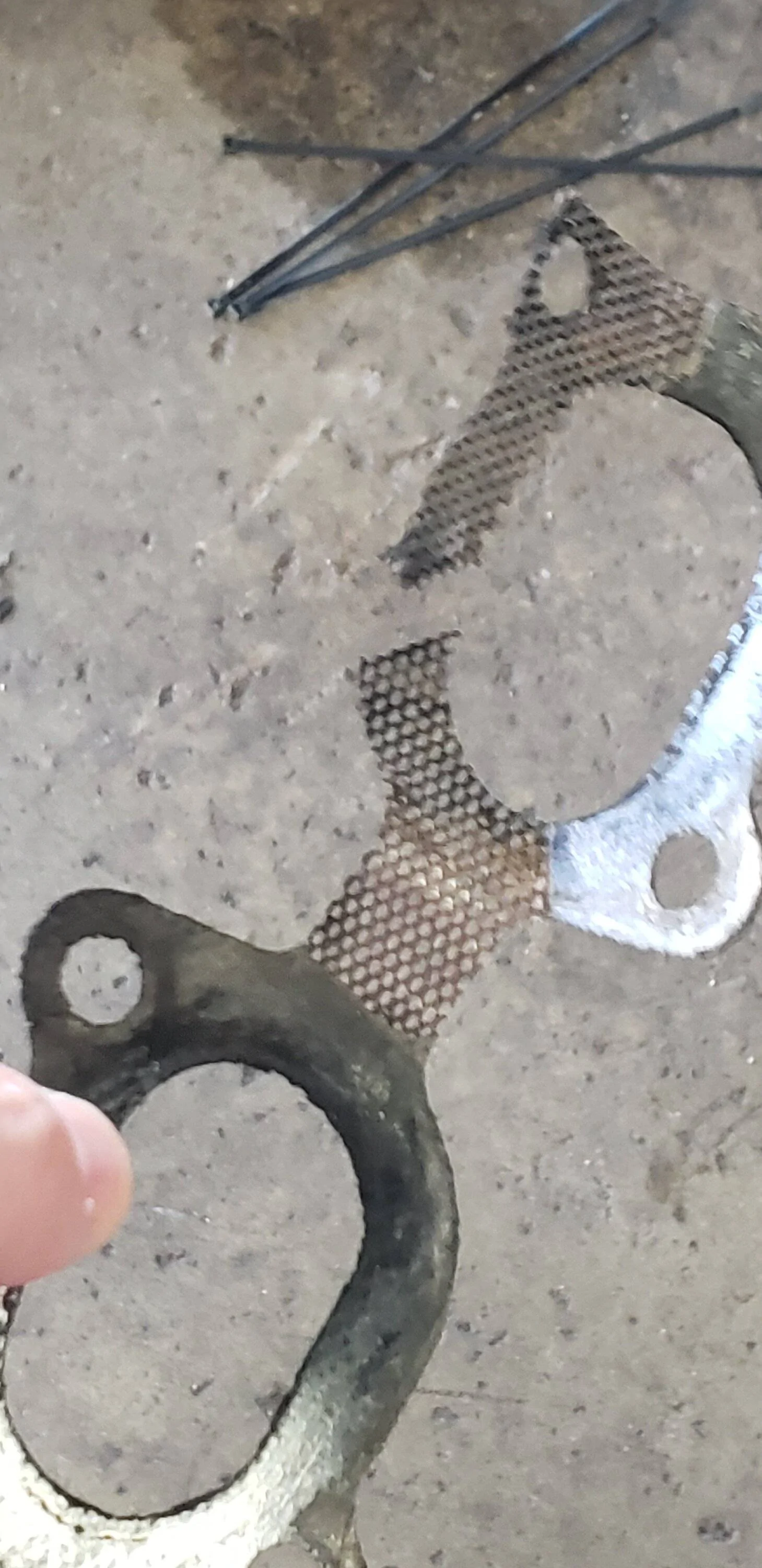

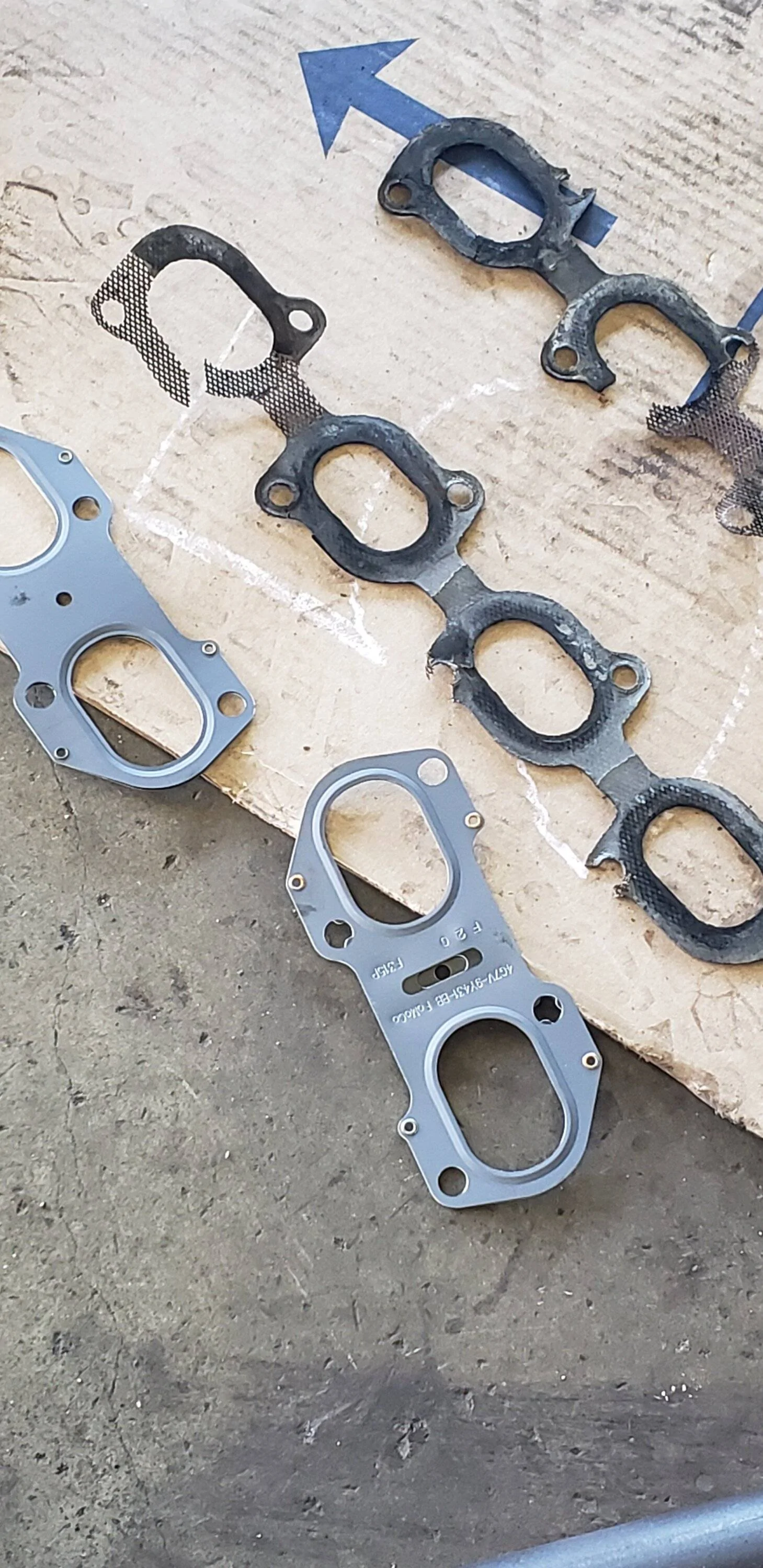

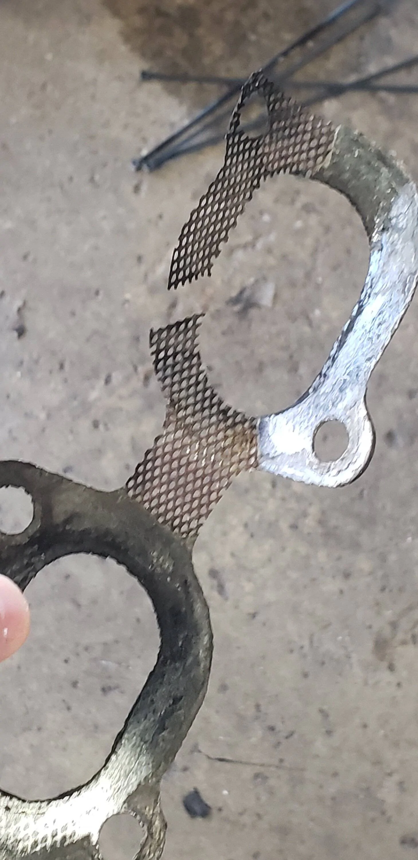

You should NOT have fumes in the cabin, catless or not. I had catless LTH's on my Shelby and did have fumes in the car but it was due to the gaskets being shot. Got new gaskets and zero fumes in the car. You have leaks. No way should you smell fumes on your clothes.
O shoot, Ive heard people having troubles with the aftermarket included gaskets compared to stock. Which brand of gaskets did you end up going with?
