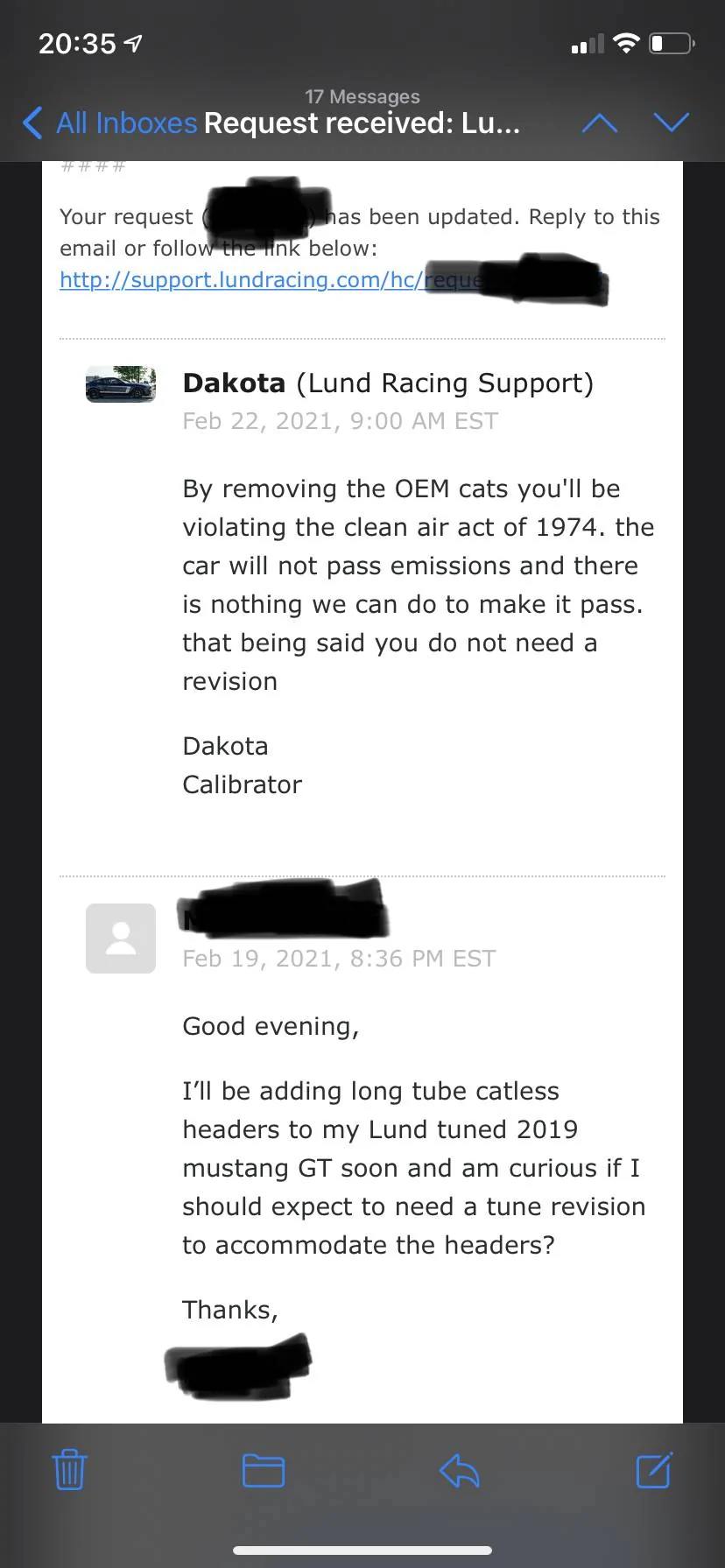

Lund has said over and over that an 18 and up car tuned will need a revision to add longtubes
