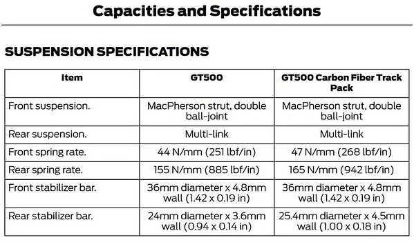

Brian, do you know what the stock spring rates are? I found 250 front and 885 rear...does that sound correct? Thanks again

It’s in the supplement manual, but here ya go:
Even though they don’t specify their rates the BMR springs are based off OEM GT350 springs which are 194 lb/in in front, and 914 lb/in in back; and for the the GT350R, they are 240 lb/in front, 914 lb/in rear
